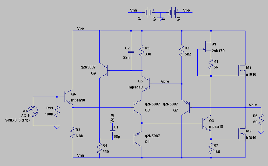

If I wanted to use mosfets on the output, would this be a stupid thing to do? (see attachment)
R7 sets the idle current, R2 the output dc offset.
You know your circuit much better, what changes would you make to use mosfets on the output?

It will probably work well, I never thought about this option (silly me, I went through all that trouble with BJT's! Sim time.).
It looks to me like M1 will take more current than M2, because of the current through R7. To help balance this, I suggest to the same value resistor as R7 across the G-D of M1, and use R1 to adjust bias. Depending on J1's impedance, the imbalance between M1 and M2 would probably be greater than in a BJT stage because of the high impedance MOSFETs.
I would suggest you increase R4 to at least 1k for about 4mA. I would not use over 10mA here.
The MOSFET output will have greater DC impedance but less HF impedance. I don't think this will negatively affect stability.
My efforts on offset so far were meant to keep the current through Q6 and Q7 even. Your method will work fine I believe; I don't know what good it is getting precise current matching when real devices vary a lot. But if you're using, say, matched pairs, odd harmonics could be practically noexistant.

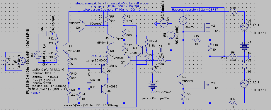

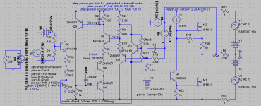

I've attached the schematic with the suggestions I described for the MOSFET version. Here I've added Q1. This increases PSRR, as well as acting as offset control. My main reason for doing this however is that by decreasing the impedance seen by Q6 and Q7's emitters, 2nd harmonics are increased. This helps put them in the audible range. At 1V output into any load, 2nd harmonics will probably be audible, but headphones are sensitive enough that mine only need around 50mV for normal listening. So to actually hear the 2nd harmonics I'm sure they need to be increased. (no big deal though, even without them it probably sounds great.)
Godfrey:
Thanks. Convenient power light, and I think it could also act as an indicator if the output stage burns out somehow.
- keantoken

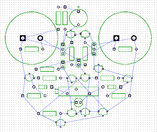

Alright, the new transformer is mounted. Now what's left is to figure out how I'm going to get the circuitry on protoboard so I can fit the heatsinks in. I could mount the outputs on the bottom, but I'm not sure if that will be good enough cooling.
Hey, is it okay to use the heatsink as the star ground? Also, I don't see any problems with using the P55NE06 as the output MOSFETs, but really I know zero about MOSFETs. It's the only part number I have 4 of, and they came from the mentioned battery backup box.
- keantoken

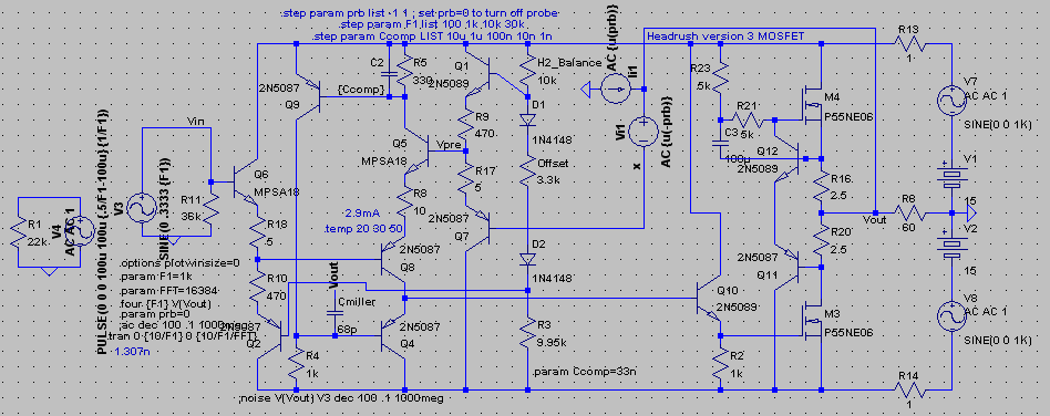

Alright, this is the version I plan to use. R9 and R10 are what determine the amount of H2.
My plan so far...
The transformer doesn't have any center taps for ground, but for headphones I don't think this is terribly important. Bypass each cap with a resistor to ground and we will have a good virtual ground in the audio range. I've decided I'm simply going to run the whole thing off of the 15V rails. Filter caps will be 10mF each, properly decoupled.
With MOSFETs, this could drive sensitive loudspeakers pretty well.
- keantoken

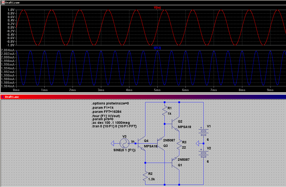

I've been playing around in the simulator for a little while and it seems that the second harmonics are produced most strongly when Q7 and Q6 are Vbe matched at the given bias current. Gm for BJT's is fairly constant, so it's just Vbe we have to worry about (we can even use non-complimentary part numbers as long as the Vbe's are close). After Vbe's are matched better H2 generation can then be attained by tweaking either R9 or R10. Generation is pretty good with a match within 10mV.
Matching can probably be done with a cheap multimeter; I don't see why a complex setup would be needed. Matching within 10mV is good enough for me judging by the simulation results.
A spectrum analyzer is not needed. It is possible to match and adjust transistors with an oscilloscope measuring across R3 (in the attached schematic). Even without that, an opamp could be connected across R3 and connected to headphones, where you could adjust until you couldn't hear the fundamental.
Oops, maybe I've spilled the beans on how to add that "H2 sound" to solid state circuitry. 😉
This is the principle behind HeadRush. Most of the H2 generation takes place in the prebuffers Q6 and Q7 in the amp. The Rush Cascode makes this setup convenient (I thought the use of the Rush Cascode/NTP was the feature of this amp, but my offset canceling scheme turned out to be the main feature).
