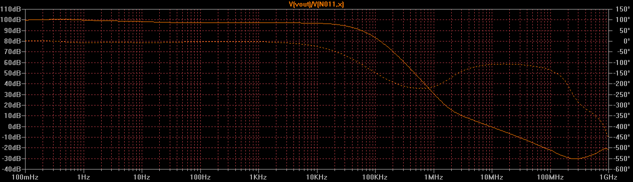

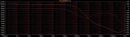

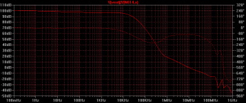

Hi kt, have you tried a loop gain analysis on the amp yet? There's an example in the LTSpiceIV/examples/Educational/LoopGain2.asc on how to do it. It would be best to add parasitic properties to the circuit: small inductors/resistors on each node to simulate the interconnecting wires (2-20nH, 1-5mOhm for instance), depending on how long the wires seem to be in the real circuit. Also, always add ESR and ESL to all capacitors. I usually add around 15nH ESL to each capacitor; for electrolytic caps the ESR varies widely, but something between 0R1 and 0R5 is not far from reality. For film caps I usually add ESR in the tens of milliohms, such as 50mR, or 70mR, or 20mR. These ballpark values come from measuring several components.
I posted the open-loop plot in #174. I've been using open loop gain stuff to tune stability in the simulator for some time. Admittedly, knowledge of stability can determine whether a design lands in the graveyard or in real implementation...
Caps critical to stability (C5 and C2) were simulated with at least .1 ohms, but earlier I was using 10 ohms each without problems. Series resistance of at least 10R is actually necessary for C5, to lower the Q. I don't know if it is possible to have such a steep OLG curve without Q-limiting at least one stability cap. I just simulated with 10nH of series inductance and stability changed little. So it seems that, if that series resistor works, this amp will be more stable than we expected.
Here is the new plot with parasitics added to all caps.
- keantoken
- keantoken
What I MEANT to say in post #180, what that LOWERING C5's series R to .1 ohms resulted in oscillation. However, revert to 10R series resistance and it stabilizes, and produces the OLG plot I just posted. I was originally simulating with 10R series resistance... So I have an idea of why it's oscillating. I need to add the resistor.

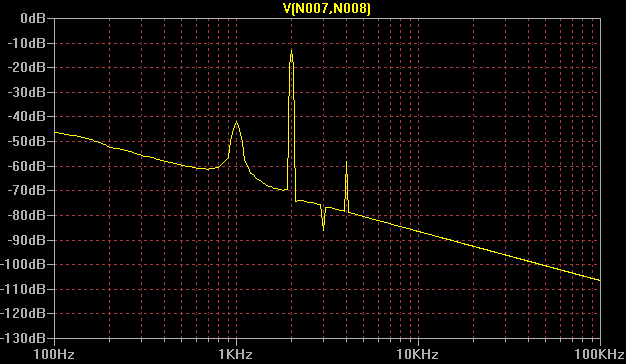

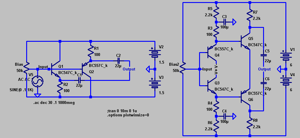

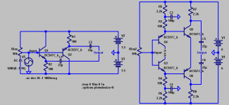

Here is the frequency doubler, amplified since the input/output volume ratio is a bit low... Now you get in almost as much as you get out. FFT plot of the amplified circuit, showing just what is possible with this trivial configuration... Matching doesn't matter, just tune out the fundamental with the bias trimmer. .asc file included (rename to .asc).
I'm printing off a bunch of schematics such as this one and am going to go to a HAM radio club meeting, maybe scrape up some equipment.

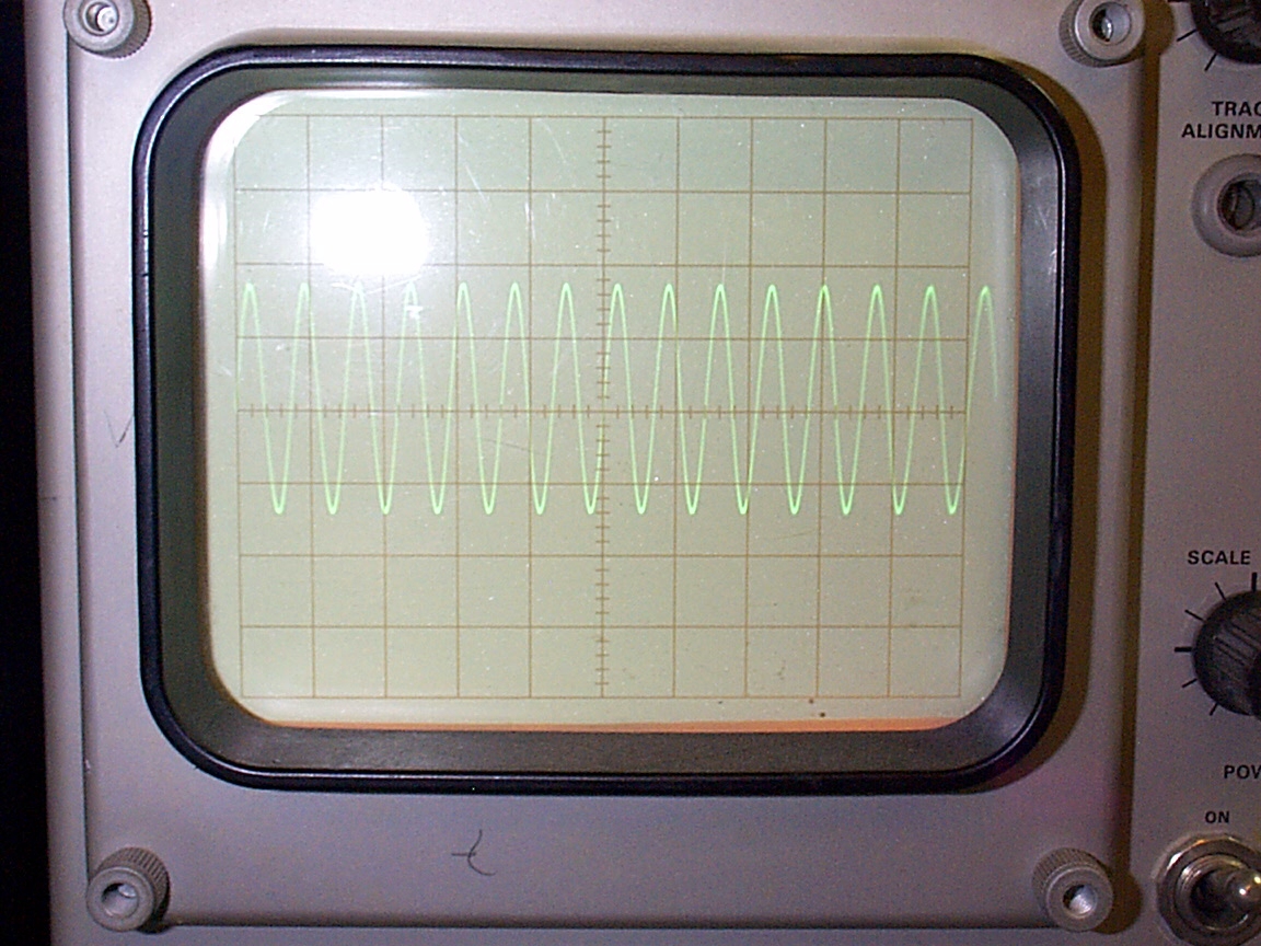

It's working!
See Iko, my construction is more than adequate. I don't think PCB's or protoboards are really that necessary, at least for a simple design like this. (for prototyping yes, the PCB is still in the works)
It is stable, just tuned the bias pot, it's showing a 3.5V pk-pk sine from my signal generator.

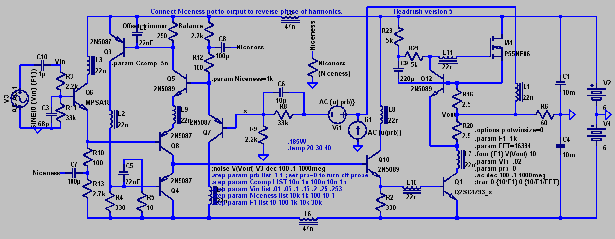

Here is the schematic, as built (inductors excluded). The compensation is large because I only have 22nF caps. All it needed was 10R in series with C5, EXACTLY as the simulator predicted. I've also attached the open loop plot with the inductors.
Checking with the signal generator, there is no peaking in the response.
