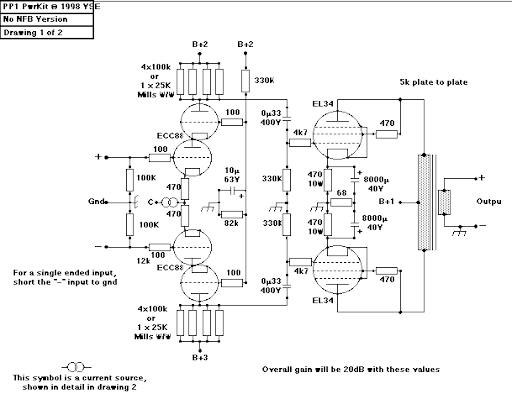

as I am now finding some time to continue work on my version of Allen Wrights PP1C (EL34-PP), I will post the progress and the (surely coming) open questions in this thread instead of starting many new ones.
The original schematic by A. Wright:

Cathode resistor choice - a matter of taste?
Hi there,
I was planning to use these resistors below the EL34 cathodes: Ohmite 470R, 10W, 1%, wirewound
Via a german electronic surplus store, I also got these extremely cheap: Vishay Dale 470R, 10W, 1%, wirewound
I guess the Dales can dissipate the 10W only when attached to a heatsink oder chassis, while the first ones might be mounted in free air. What do you think, is it a matter of taste or are the reasons to prefer one of the two?
Cathode bypass capacitors will be these: Sprague 8000µF, 50V, axial
Greetings,
The Ohmite resistors will allow for 10 W dissipation at an ambient temperature of 25 deg C. At this dissipation, you can expect their temperature to approach 250~300 deg C (yes C!).
The Vishay-Dale RH-10 series can dissipate up to 60 % of its rated power at 25 C ambient without a heat sink. Their 10 W rating is based on them being chassis mounted. See the RH-10 datasheet for more details.
With power resistors in general, I recommend a significant design margin. I wouldn't allow for more than 1/4~1/3 of the rated power to be dissipated in a power resistor. Even under those conditions, the resistors will be over 100 deg C at 25 C ambient!
As long as you can get good air flow around the Ohmite resistor, that's probably what I would go with. I don't like using the chassis for a heat sink on products that the user can touch. But if you're fine with heating up the chassis, it's really up to you which resistor you choose to use. There's no significant advantage one way or the other.
~Tom

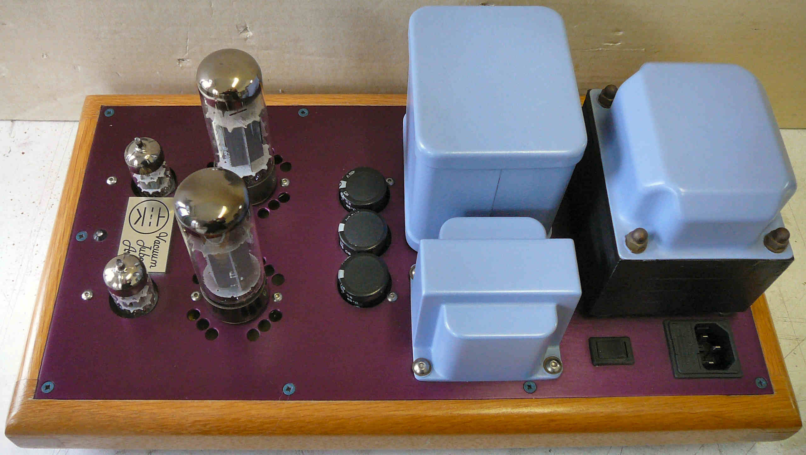

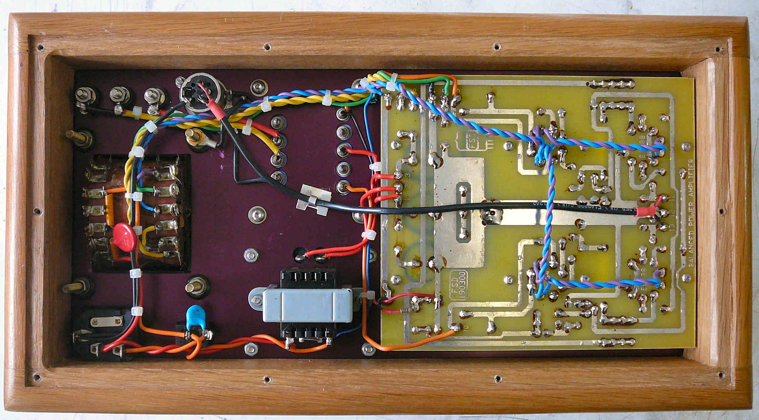

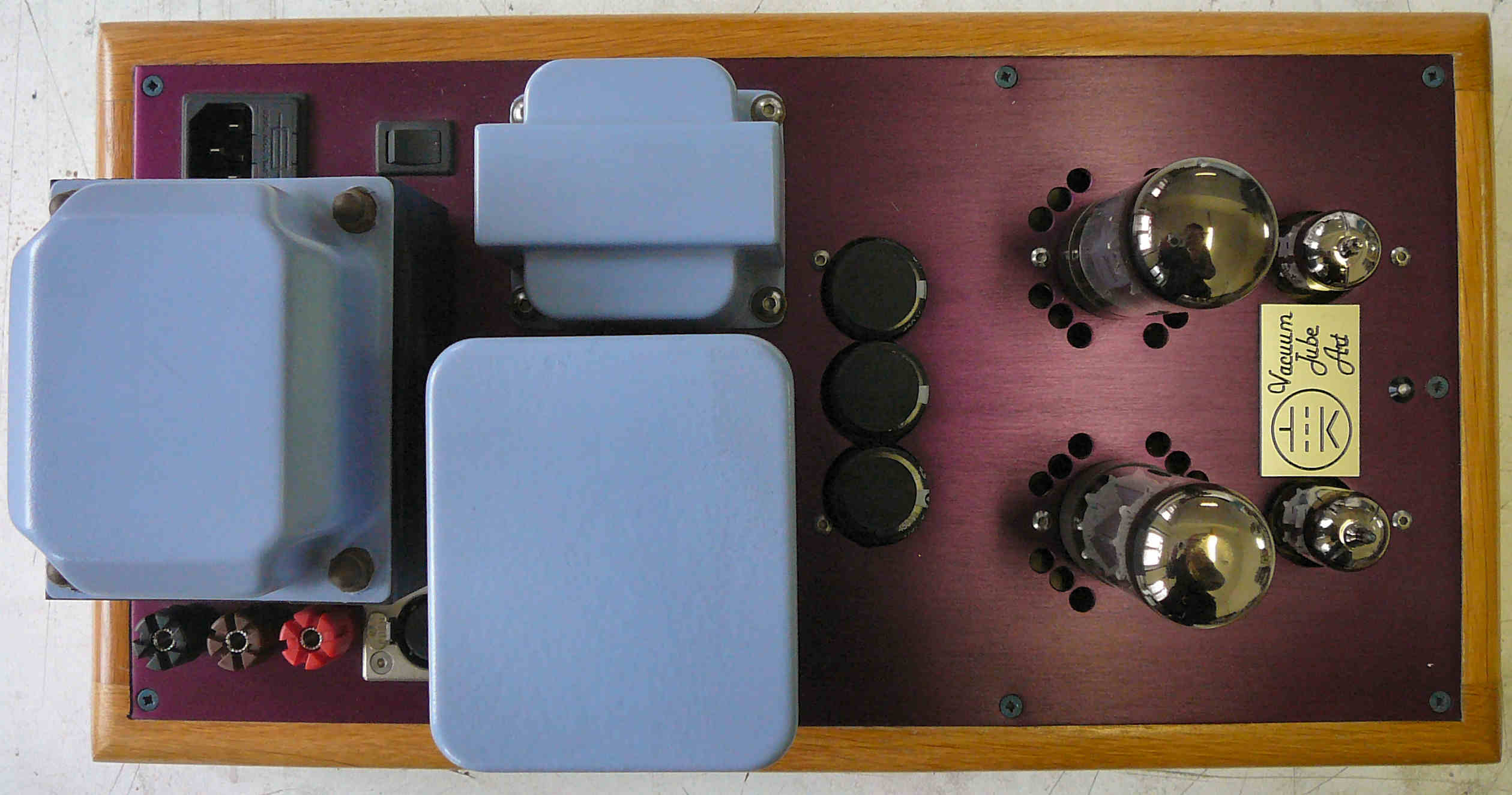

In the year 2000, after finding the original Allen Wright schematic on the Internet (see the schematic at the start of this thread), I made these two monoblock amplifiers.
Vacuum tubes: 2 x Cca (Siemens) and 2 x EL34 (Telefunken).
Transformers were rescued from old amplifiers.
I followed the original schematic.
I used good quality commercial components, no fancy expensive stuff.
I am very satisfied with the result and sound quality of this design, now driving a pair of Klipsch Heresy III speakers.
Best regards, 968driver.

The power transformer is from an Artec EL34 PP stereo amplifier (the one with the horizontal VU meters, they used two of these in the stereo amp, so this is good for two monoblock amps).
The output transformers however, are French Millerioux PP transformers.
The choke on top of the chassis is from an old Hewlett Packard instrument.
All were cleaned and spray painted in Provence blue, inspired by a holiday in the beautiful Provence region of France.
The donnor amplifiers were beyond rescue.
