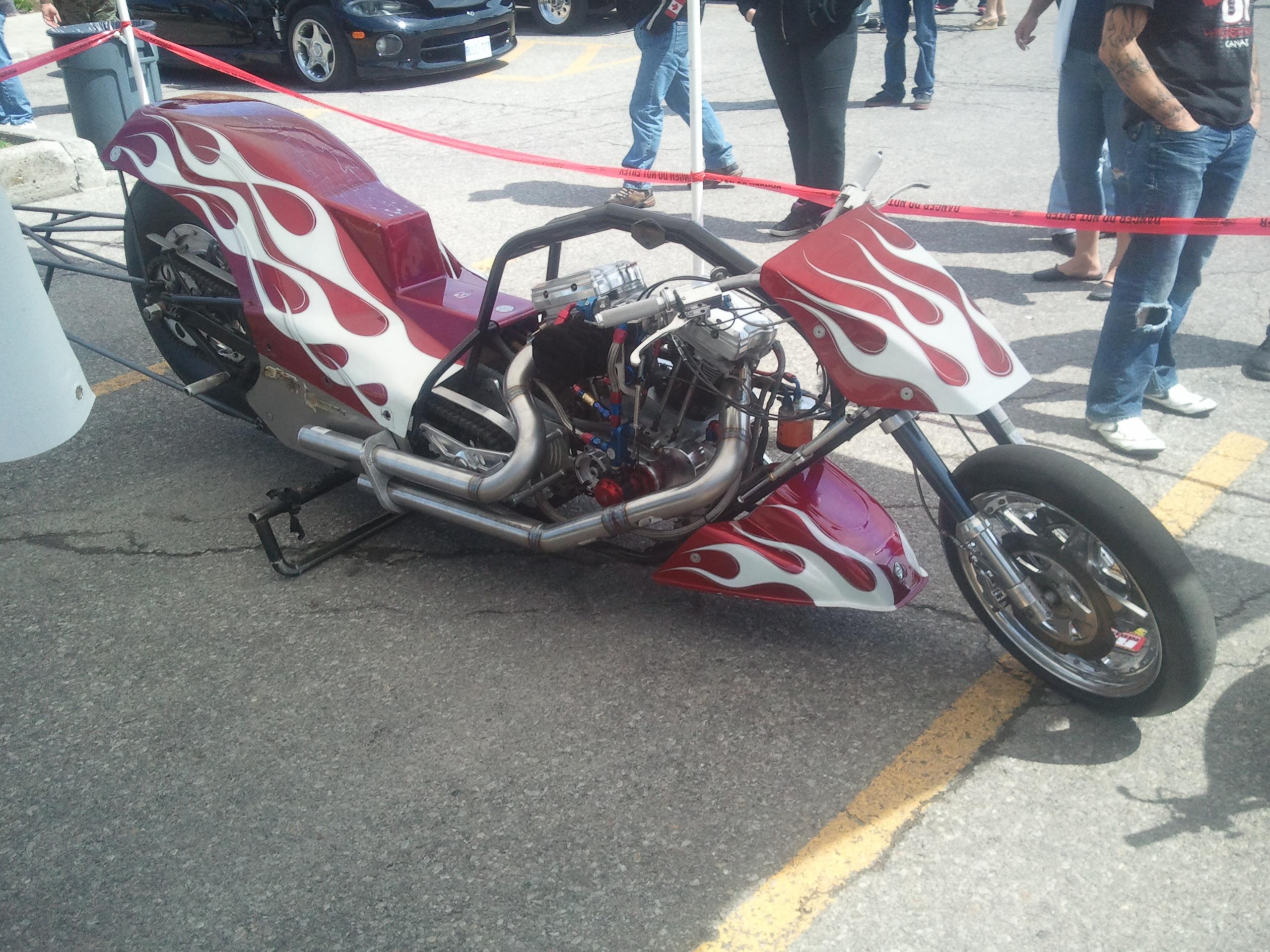

On a side note, here's a "Harley" that might change your outlook on lower rpm engines but there's no actual "Harley" parts in it. 1000 HP, all in by 5500 rpm. No transmission. Dump the clutch and hang on.
