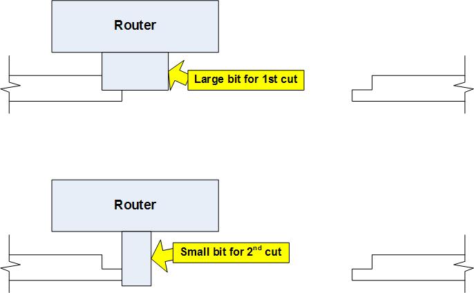

Okay, I couldnt find any 3/4" spiral upcut bits at the local stores, they only carried
1/4" ones, but I wasn't sure if that would work well. I did get a 3/4" straight bit and a 45 deg. chamfer, both from skil and carbide tipped. Will these be okay?
If a 3/4" spiral downcut would work better, can anyone point me to a reputible online store that carries one that will work well?
I'd prefer it to be under $30 if possible. Also I need to cut a hole from a port out on the back of my veneered cabinets, so downcut bit makes the most sense.
edit: Is the 3/4" diameter actually needed? Or was that the flute length?

The reason for getting a 3/4" (diameter) bit, I assume, was to cut the rabbet for the recess first, then switch to a smaller bit for the through hole: this would leave a ledge without having to reset the diameter of your router jig - see drawing.
The upcut bit has spirals like a drill bit, and clears chips in the same way a drill bit does. The disadvantage, as pinkmouse points out, is that this can cause splintering in face veneers. You can overcome this by using a spiral downcut (which has the spiral in the opposite direction).
Personally, I'd just use straight bits unless I intended to work with very thick front panels; for 3/4" material a straight bit should work fine.
