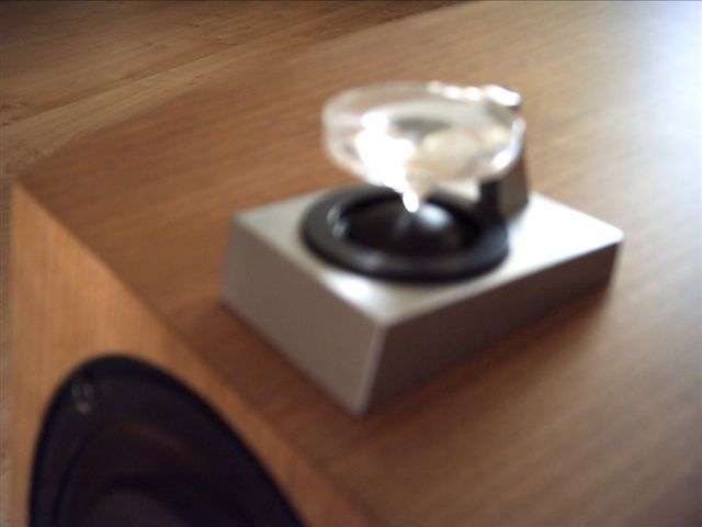

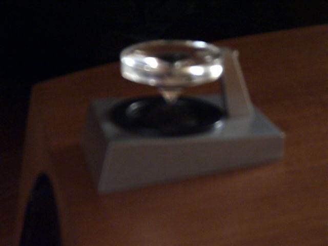

As promised a drawing of dispersion cone. The advantage of this design that it reflects sound good. The cone on the Mirage omni speakers reflect too much back to the dome, because its too flat. This gives interference errors.
The cone works as a phase plug too. Another fact: when i first placed the tweeter vertical on box, it was very obvious to hear a sort of "doppler effect" when i moved speaker from front to back. With the tweeter mounted horizontal with dispersion dome, i could not hear allmost any difference in sound with moving! So i placed tweeter in the best position it would be when it is mounted vertical: baseplate 1 cm from edge box.
Its advisable to search a tweeter which has about 3dB more efficiency then woofer, because its radiating around and fills allmost whole room with high tones. But tweeters have usual a lot more efficiency then woofers.
The radius in the concave is about 33mm. For a bigger tweeter(this cone is for a tweeter of 20mm diameter) it can be enlarged. Mounted it just above dome, 1 mm away from it. The tip has a small convex curve of about 0.6 mm radius.

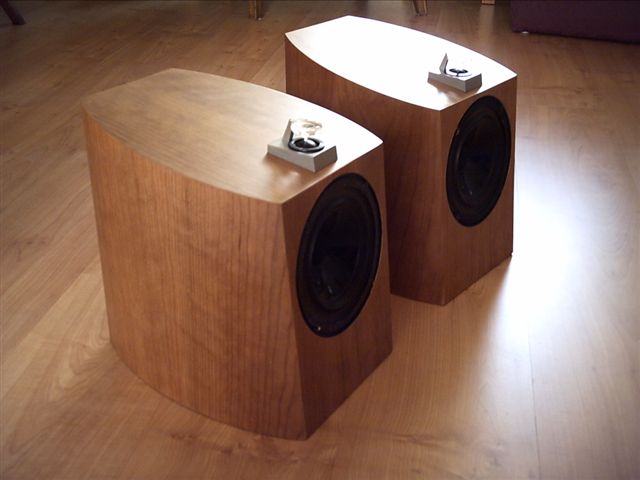

Angsuman, i listened to them in stereo, to compare sound. The soundstage is in a good proportion, even considering the cheap tweeters.
At some points they outperform my normal stereo speakers. (series filtered 2 way ML-TQWP's with 20 cm Audax bextrene woofer, and heavily modified but good-old Focal T120K tweeter.)
I have dampened the focal myself, mounted a bigger volume (had to drill pole!) + small phase plug like the titanium T120's have of Focal. But still this tweeter can sound sometimes a bit sharp, the cheap CRB40 from Monacor has a silky sound, and is not dampened on the rear of dome, it has only some ferrofluid.
