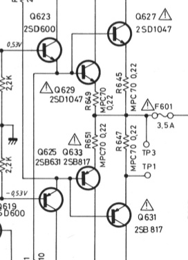

It's certainly not impossible that one of the drivers (Q623/Q625) is toast. How warm do they get in operation?
Q623 has 52,6 degree, Q625 about two degree more

I measured the drivers:
Q623:
Base 1,9 volt
Emitter 1,3 volt
Collector 33,63 volt
Q625 :
Base -349 mv
Emitter 266 mv
Collector -33,63 volt

So to me Q625 measurements look weird...

The voltage readings on the drivers all look good to me. (Second channel apparently has more quiescent current.) The temperature is not too hot either.

No, but I measured voltages at the drivers, see here:http://www.diyaudio.com/forums/solid-state/206338-rotel-ra-820bx3-not-working-9.html#post2907856Hi sangeet2
Did you measured the drivers before you ordered new ones? I think it would be the best if you check all transistors, one by one, and then go with ordering of replacement for the faulty ones.
I ordered SB631 and SD600, I hope they will work

-349mV and + 266mV makes difference of above 0.6V and that is ok.
I would check all transistors in the differential stage, VAS stage and the output stage and then if problem still exist i would look for a faulty resistor or capacitor, diode maybe..just check all transistors one by one, it will take u some time but its worth, if they are ok you can go on and look for a problem in some passive elements, if not, just order the faulty transistors.
