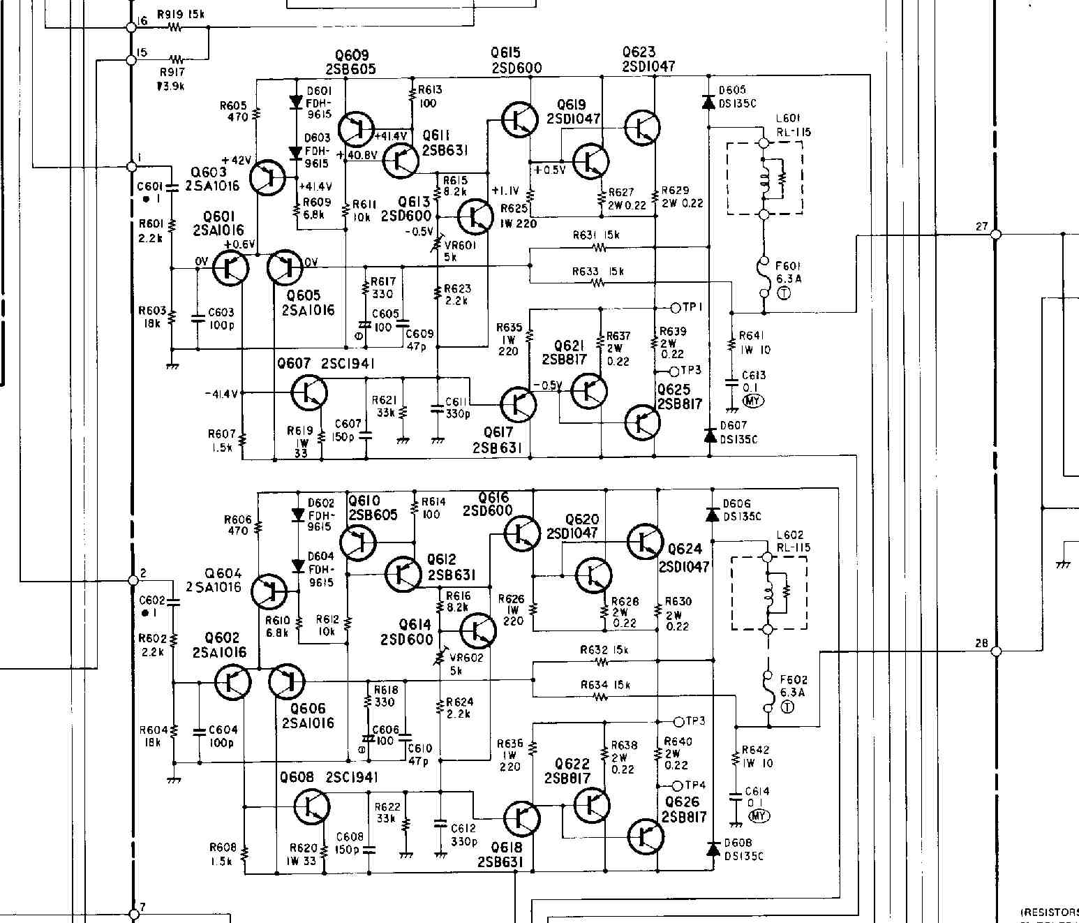

There is very little difference between the BX and non BX version.

So, here we go again..... I found another problem that initially skipped my attention. On one channel (power amp) everything is fine, DC offset 4.5 mV, bias adjustable, set to 30mA per output transistor.
But the other, seems to get me, despite some experience in repairs. Whatever I do, the output is stuck around -200mV, and the worse part, it does not respond to bias adjustment, stays steadily at around 100mA. I checked everything,(statically) transistors, diodes, electrolytics, resistors, trimpot,: OK.
Actually the amp works, the protection does not engage, but the "bad" channel is louder than the other by about 6dB.
It is a PITA to work on, at least to measure voltages, because the opening on the bottom is rather small, so I cannot access many parts to measure, to get the board out is a nightmare, every connection is wirewrapped on it.....
Does anyone have any idea what might cause this problem? (oh yes, checked it with scope too, no oscillation either.)
