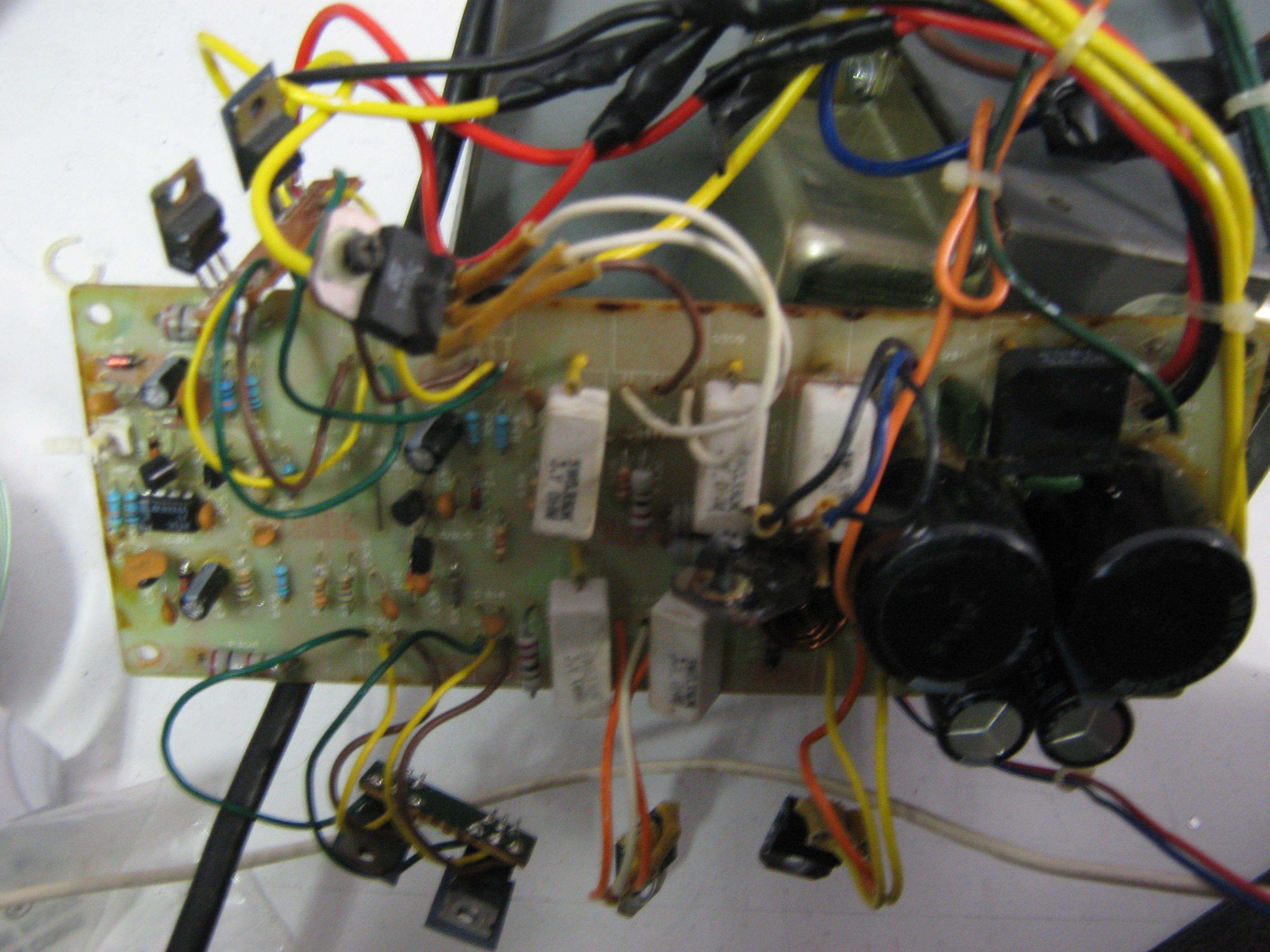

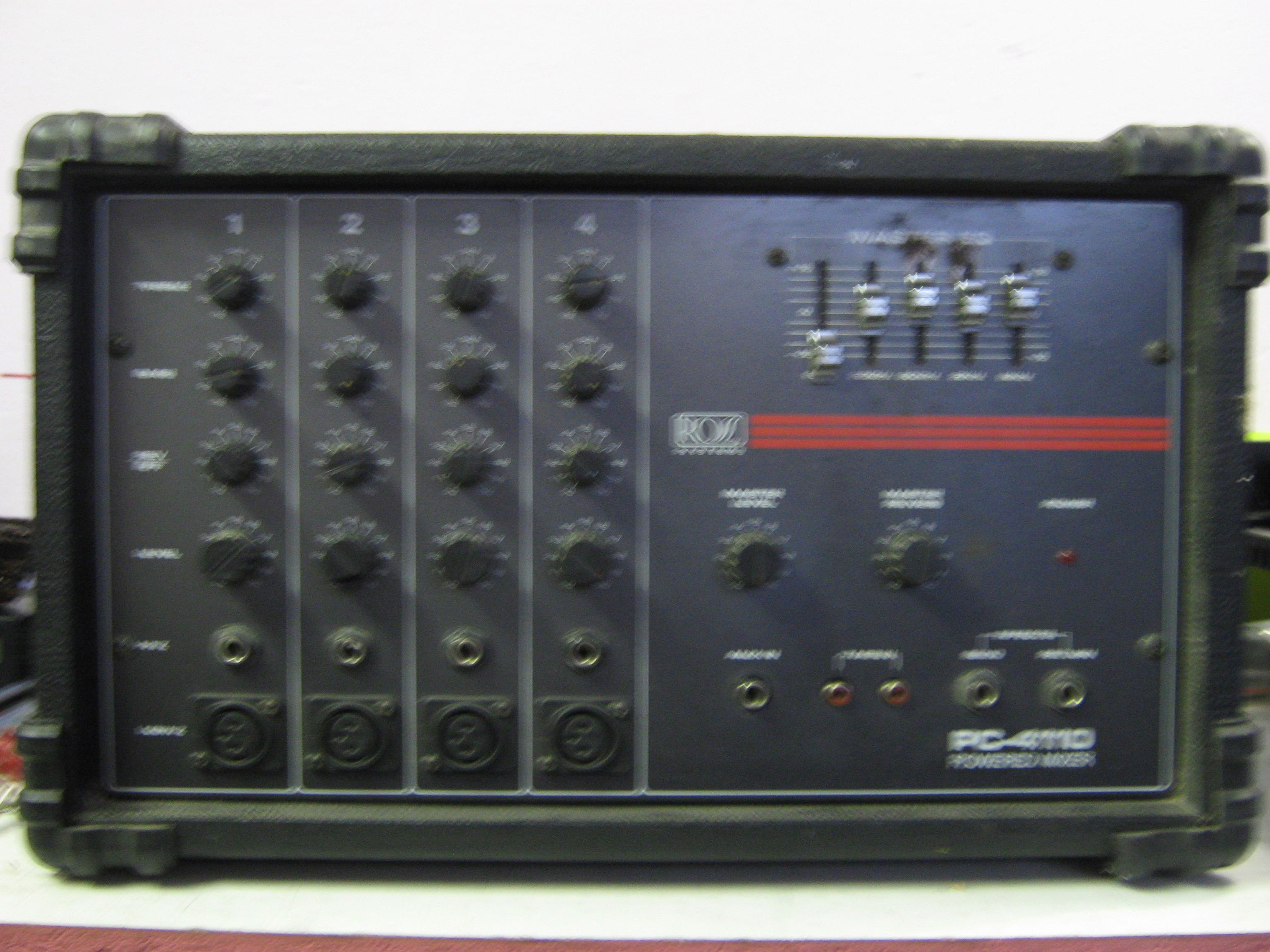

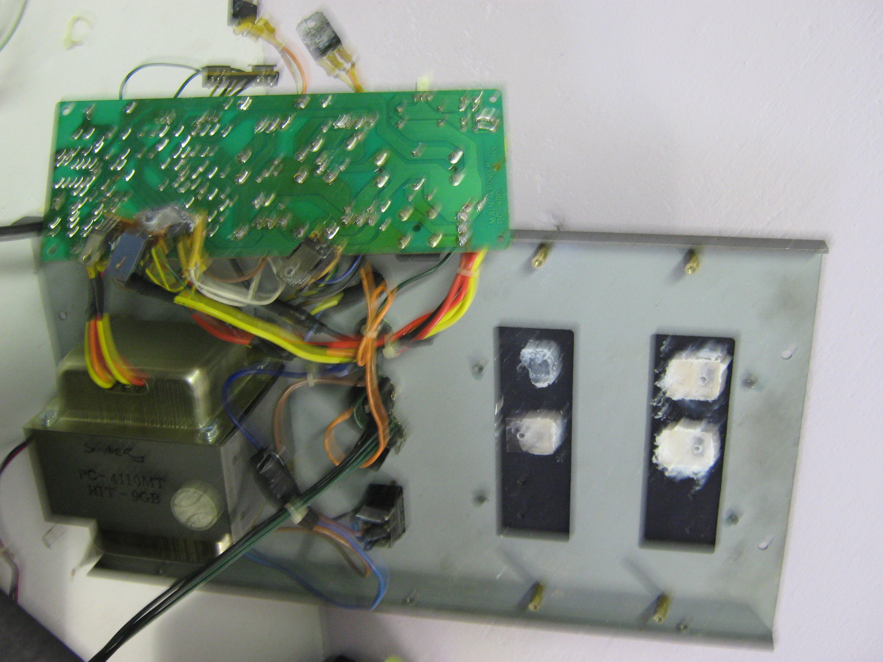

How zit all :) ! Please help. Got this system in and people (bush technicians) already had a go at it.Want to try and repair , but not sure if the right transistors is in and if wired correctly. The output transistor is not solder on
the pcb. Instead it is wired. So now I dont know if it has the right parts in it and if it is wired correctly. Any one have advise or know where I can get the circuit.Will post pics if someone is willing to check it out.
Regards
Vick
Here is the Picture's

Actually considering that it is made by Ross Systems if I already had it apart and all the power transistors removed I would go ahead and replace all of the power transistors and be really careful about mounting them on the heat sinks because they have bogus heat sinks so you don't want to make it even worse by not having one or more not dissipating the heat as well as possible which is what is going to happen over and over with that amp. I probably don't need to tell you how to do that. The output transistors will cook. All Ross amps from smaller than that to much bigger will cook output transistors in a year or two if you use it very much. When you replace them replace them with some good ones not the same brand that was in it.
