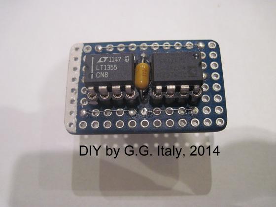

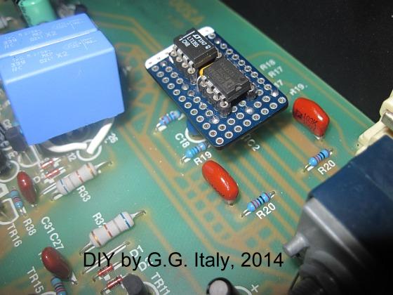

It is so hard to find in the market, that I decided to build myself.
Very useful for your listening tests and MODS.

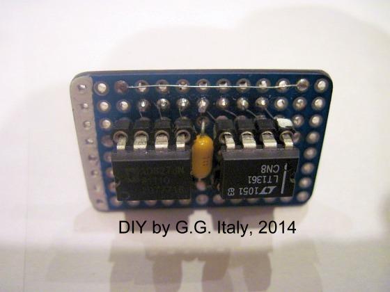

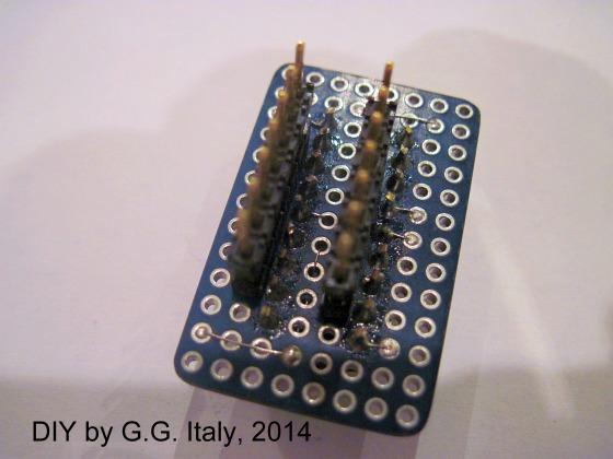

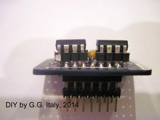

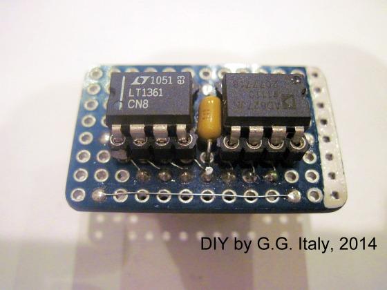

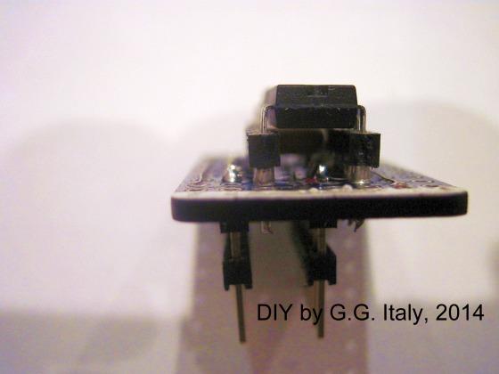

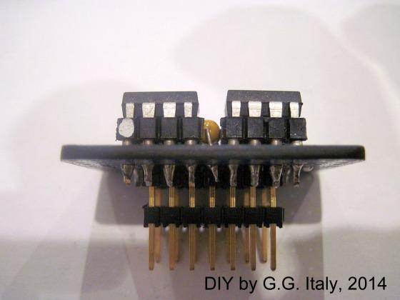

This is a DIP-14 to two DIP-8 socket adapter to convert any quad opamp to two different dual opamps.
It contains also a 100nF rail-to-rail ceramic capacitor.

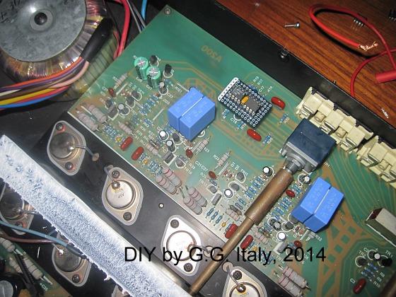

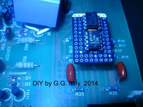

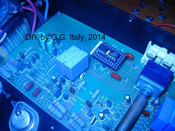

I'm permanently using in the pre-amplifier section of a Musical Fidelity A120 amplifier, where I temporary replaced JFET quad op-amp TL084 with two different superb bipolar chips (chosen after rolling several dual opamps, but still under listening test): Analog Device AD827 as unity gain buffer and Linear Technology LT1361 for volume gain.
To use this you need to unsolder your quad op-amp, that could be a tricky procedure.
Enjoy!

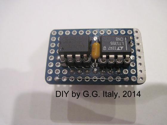

Another DIP8 combination
This is another outstanding bipolar configuration: Linear Technology LT1355 as unity gain buffer and Analog Device AD826 for volume gain.
Sound is slight less accurate and clean, but more emotional and warm-toned (thanks also to the well-known heavenly midrange of the AD826).
I stop here since the DIP8 combinations are nearly infinite..
