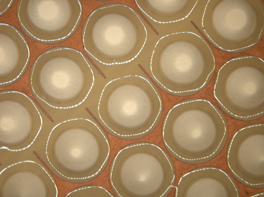

Hi Bolsert,
i made some prototypes months ago.
In the picture you can see, how precise the drills and the copper layer is made.
The glance in the picture comes from the transparent isolation coating. This is a very specific one, it needs to dry under UV light. The advantage is that this coating can be applied in one run, building up to 0,2mm layer. As you can see it covers the copper layer perfectly and most important, it do not run into the holes, which are just 2mm in diameter.
In addition you can see that this stator has been segmented. The picture shows the border from one segment to the other
The board size has been 400x200mm and one board was about 20 Euro

Thanks for the picture, Capaciti.
Very nice!
Most interesting geometry with alternating copper trace spikes in between the two sections.
So for one complete panel you would need 8 of the 400x200mm boards = 160 Euros. Expensive compared to wire stators, but not as much as I had thought.
The coating, is it a standard option that PCB manufacturers use? or is it something proprietary that you are developing for best ESL stator efficiency and reliability.
