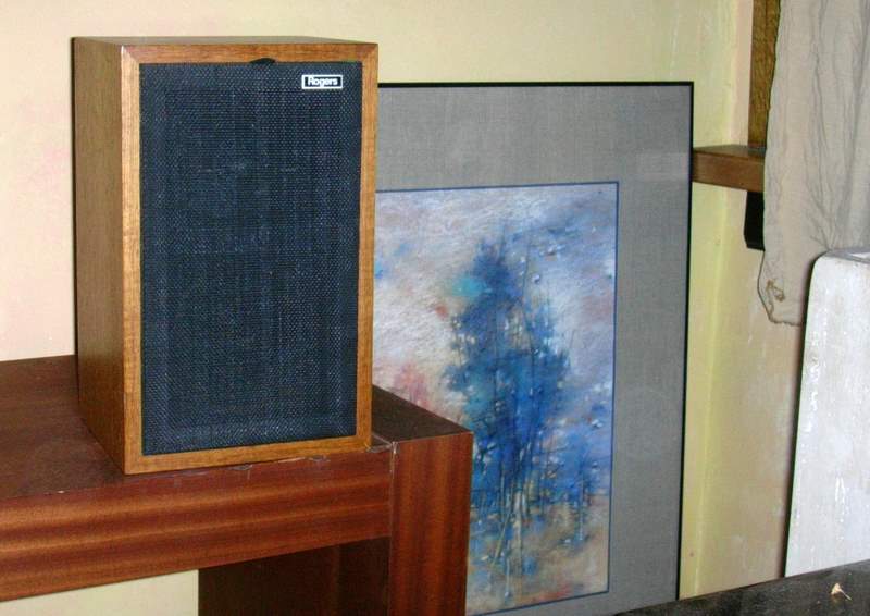

Well , finally after many moons passed I was able to borrow a pair of Rogers Ls3/5a (15 Ohms). I was convinced that I will be wasting time with them as I didn't like Harbeth line of speakers in audition at friendly dealer (monitor 40i and older 7th) I was wrong . I love those small boxes in my 10'x10 bedroom.I don't need anything better than this. What a nice pair of speakers!!
Regards, L
