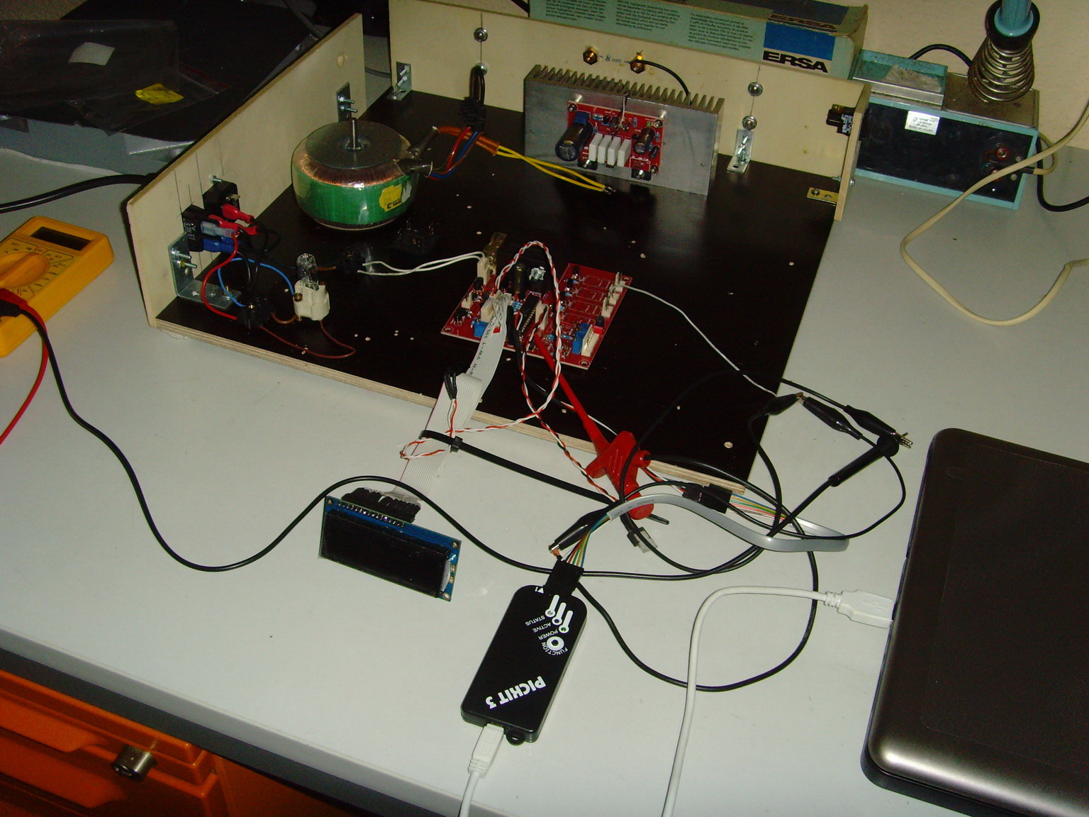

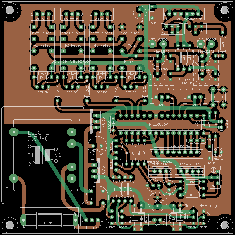

Gentlemen, dear FC-100 friends,
my DIY-friend METAL and I are currently working on a "universal - passive PRE-AMP supplementary PCB", consisting of:
- Source Selection (3 optional choices)
- Mute functionallity
- George Stantscheff's "Lightspeed Attenuator" being controlled by a motorized potentiometer, being controlled by Infrared
- 2 Temperature Sensors
- 2 x 16 chars Front-Panel - LCD - Display
http://www.abload.de/img/image1tfa8s.png
Everything can be operated from a infrared-control unit.
It won't be long until we will finally be able to offer you this PCB.
If anyone of you is interested to have this PCB: please tell me.
Best regards - Rudi_Ratlos

The only issue I see is sourcing matched LDRs. Would someone be supplying matched sets? If yes then this is really interesting to me.
Will you sell just PCB or LCD and motorized pot as well? Will it have IR learning features? What would be the cost?
Sorry for all the questions.
Ciao!

Yes, of course, Pinnocchio:
I will provide you the PCB, a pre-programmed PIC 16F886 µProcessor and matched LDRs. That is it.
I have ordered a couple (16 pcs., still waiting for RSOnline's receipt) of LDRs for my own use, and I will find out, how well they will match.
George Stantscheff told me how to match them.
