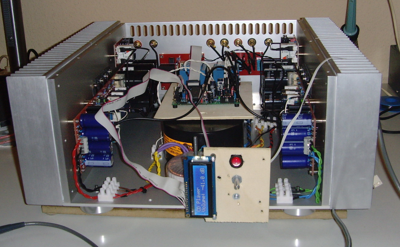

I am currently going on and integrate a source selection / volume attenuation into my FC-100 case.
The selector/attenuator is based on BurrBrowns (TI) PGA2311 - chip, which is controlled by a PIC 16F4550 µProcessor.
I prefer this solution to an ALPS-DualPotentiometer, to the Lightspeed-Attenuator, ..., and:
everything is controlled remotely by means of Infrared.
It's your amp, but I would prefer keeping RF generators outside of my amp.
I "married" the analog and digital sections of my FC-100 build this morning.
Everything works as designed - and can be controlled completely by means of infrared from my armchair.
I will go on and order some ALU-plates and - brackets to encapsulate the transformers and to have a base for the "second-floor digital PCBs".

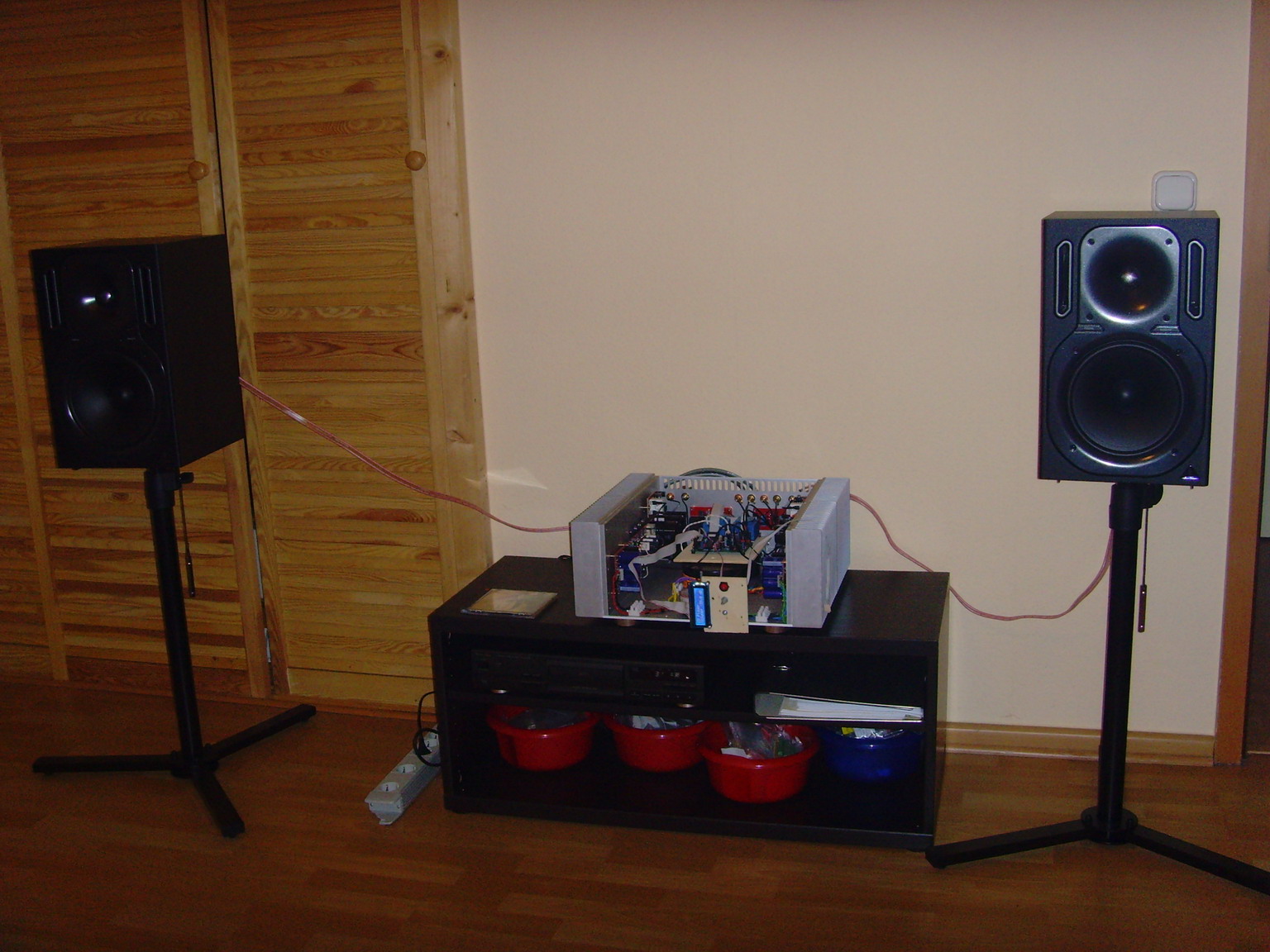

since yesterday I have been listening to my FC-100 build.
Let me give you my first listening impressions.
As source I am using a CD-Player Technics SL-PG470A; currently I have connected a pair of Behringer B 2031P Truth speakers.
I will not use any stereotyped phrases like: "deep, black bass, beautiful trebble, ...".
I want to describe the character of the FC-100 (as I hear it) by comparing its sound to how a man walks.
I have a chip-amplifier. It plays like: slow, sometimes stumbling, ..., well: finally it reaches the end of a music track. Is this, how an old man walks?
My SYMASYM: very fast, it seems to run through a piece of music, you feel the efforts it undertakes to do it right, you hear the sweat,
running down its face, it is doing its best, which is very good!
I see a man, middle-aged, in good shape.
Then the FC-100: you see a youth in front of you, having all the strength of the world, walking with a sexy kind of leisure,
swaying with his hips, tossing his hair, flirting with you, reproducing the music "by the way", "like a duck takes to water".
(I found this phrase in my dictionary. Is it well known?).
I was and still am very impressed by the "easy-going" way, with which the FC-100 plays my music. This is, what I have been looking for.
By the way: the FC-100's sonics are the best that you can imagine.
Best regards - Rudi_Ratlos
P.S. I will upgrade my speakers and use another source soon.
