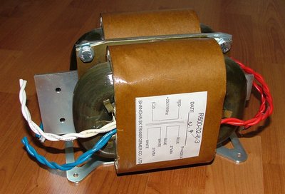

Hi Patrick,
where did you get that beauty?
I bought two of these beauties(2 x 27Vac/8A) only not for this amp or..........
Rudi: I ordered locally in Romania at a very small company ... but I don't know if they deliver abroad ...
I highly recommend you to use R-cores wherever you can ( or afford ) because they have almost zero electro magnetic interference with surrounding components.

What about r-core transformers what is getting more and more popular in the audio field.
If you google "r-core transformer" you get a lots of ebay sales. And there's Seletronic in France who offers a wind range.
Just curious what's your feelings about it guys.
zsaudio
R-cores transformers don't become "more and more popular in the audio field", they were designed with the audio target in mind
Yes that can be true but even nowdays i can not see them in commercial products not so often. I know several ones use it.
When i swaped for r-core transformator me and my friends we heard the difference. Some people would say this is subjective and i'd get a BS flag.
Anyway i'd like to hear your experiences guys.
In my experience, given a resolute audio system, R-core transformer (vs other types) makes a very big difference in noise floor level and could bring up microdetails, things that are measurable and not BS
Hi Patrick,
I did buy them from VT67 and he bought them I think from a german company. bought them for 45 Euro each.
Can I use them in the FC100?
I'm happy that i'm not alone with my findings.
I think you can use that but tune the frontend voltage to your rised backend voltage according to Mihai's recommendations on the PSU.( see the orig rmi-fc100 thread)
