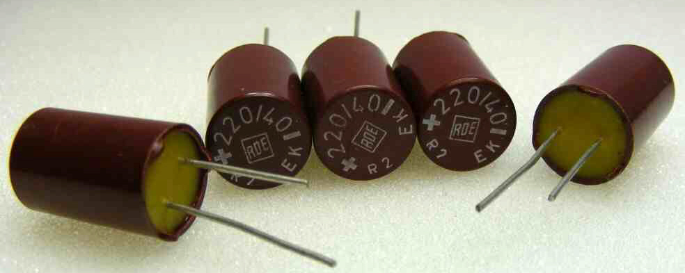

Hi cap cruncher's !
Just wondered if anyone has ANYTHING at all, to say about these ?
I searched around a bit on the wonderfull WWW...
...but turned up...not much.
I believe they were used in Quad 22's for example...
...and I think Naim Audio used them for sensitive de-coupling duties.
Very old Bakelite has somewhat of a reputation for simply disintegrating & falling apart.
At best not much long term ( we are talking DECADES here ! ) dimensional stability.
However, I believe later, perhaps slightly post WWII Bakelite, was a bit improved.
It seems that the Roederstein EK series, was produced long AFTER other plastics & materials as alternatives, were available.
Also, why not just bung the cap in a 'tin can' like everybody else ?
It's seems to be an early version of the now common 'audio electrolytic'...
...obviously sonic issues addressed in the design ?
Is it 'low impedance' ? ( haven't got a clue ).
Does it 'sound good' ? ( dunno mate ).
Did you pull 'em out of your Naim gear, & reach Nirvana ?
Did you pull 'em out of your Quad gear, & wish you never had ?
Anyone using 'em for phono-pre's ?
Anyone think they're only fit for the dustbin...
...or have their stash in a bank vault ?
Love to know any members loves, hates, anecdotes etc...
..." Tales Of The Legendary ROE Cap"
Cheers.
Si.
PS...if you tap 'em with something, they seem VERY non resonant, compared to say, Nichicon MUSE...
...pretty scientific, huh ?

I have tested them, along with many other types, old and young.
I am unable to find the thread, I don't even know if I posted the results on DIYaudio.
Anyway, I remember they were excellent, capable of competing with more modern types on all aspects, except the size/capacitance ratio.
Other than that, they are of exceptional quality, and also remarkably durable since the samples I had were at the very least 25 years old, some much older than that.
Siemens also made very comparable caps, both in construction and quality.
They also had an identical form factor (probably resulting from some old DIN standard).
The only difference was the color: bright orange instead of dull brick. But the quality was very comparable. It was the GSF series.
I'll try to make some fresh measurements on both types and post the results.

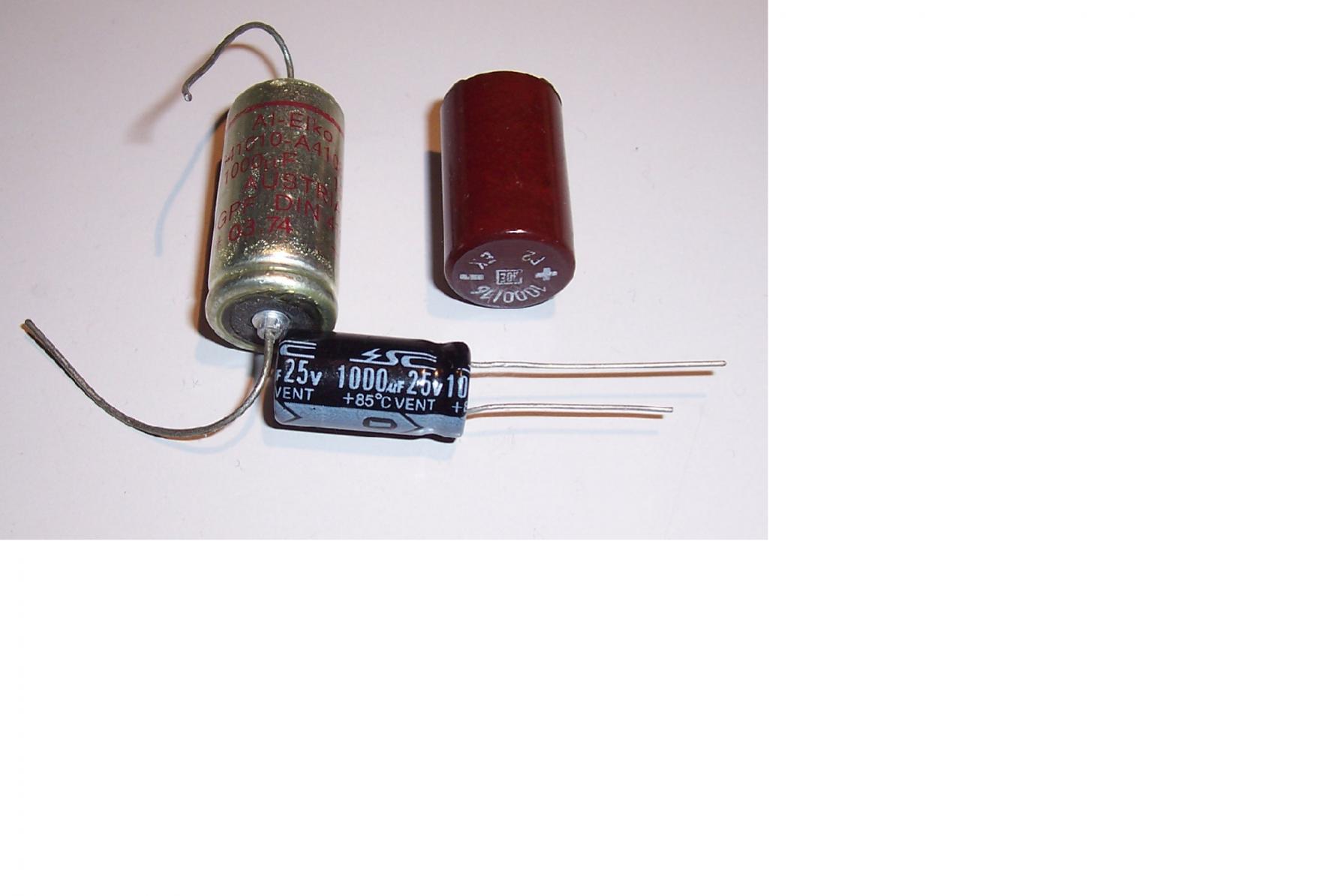

I have found one more example: a 1000µ/16V (used)
Its esr @1KHz is 61mΩ
For comparison purposes, a modern 1000µ has 83mΩ, yet it unused and 25V.
Also included is a Siemens 1000µ/16V dated 03/74: 58mΩ. Yet it is an axial type and is thus disadvantaged (and probably older than the EK too).
So, this confirms EK caps are excellent, but Siemens are still superior

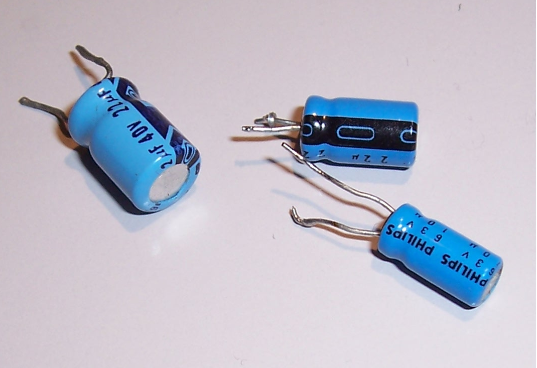

Quite astonishing how user's experiences can differ.
For my part, compared to other contemporary types, I have seen very few faulty ones. As I mentioned earlier, I found some had cracked or even exploded, but it was caused by application of reverse bias.
Usually, ordinary Al caps tolerate a small percentage of reverse bias voltage during part of a cycle, but the EK do not tolerate well that kind of treatment, probably because of their hermetic construction.
There may be other factors: since they were low esr, some designers could have mistakenly thought that they were suitable for operation at high current, high temperature and high frequency. In fact, they must be 85° or perhaps 70° parts.
The equipment where I saw them were mainly professional, not consumer, conservatively designed and they weren't subjected to simultaneous stresses.
Under the same conditions, the Philips ones were awful (the ones with light blue sleeve): they simply dried up, without stress, and they even degraded under shelf storage conditions.
I cannot comment about "Japanese elco's", that is too broad.

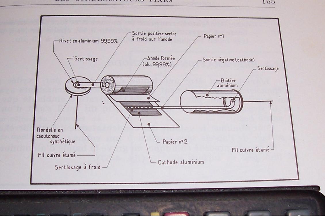

Why is the axial capacitor 'disadvantaged' ?
Because the cathode connection has to be made through a thin aluminium strip welded to the bottom of the case, having a length ~150% of the cap's body.

N I C E diagram of the axial !
