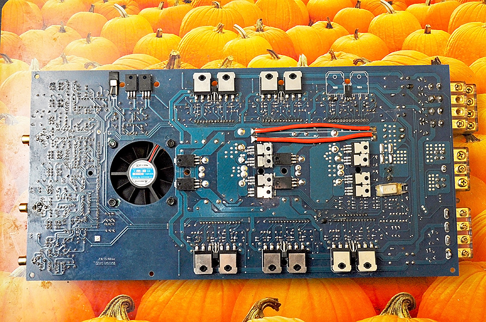

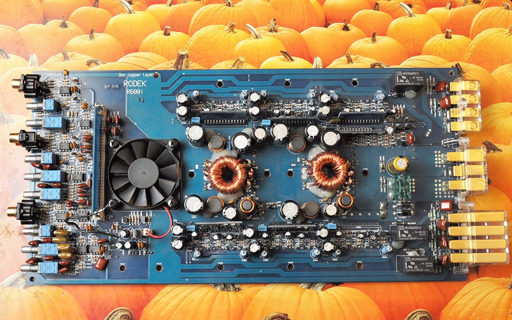

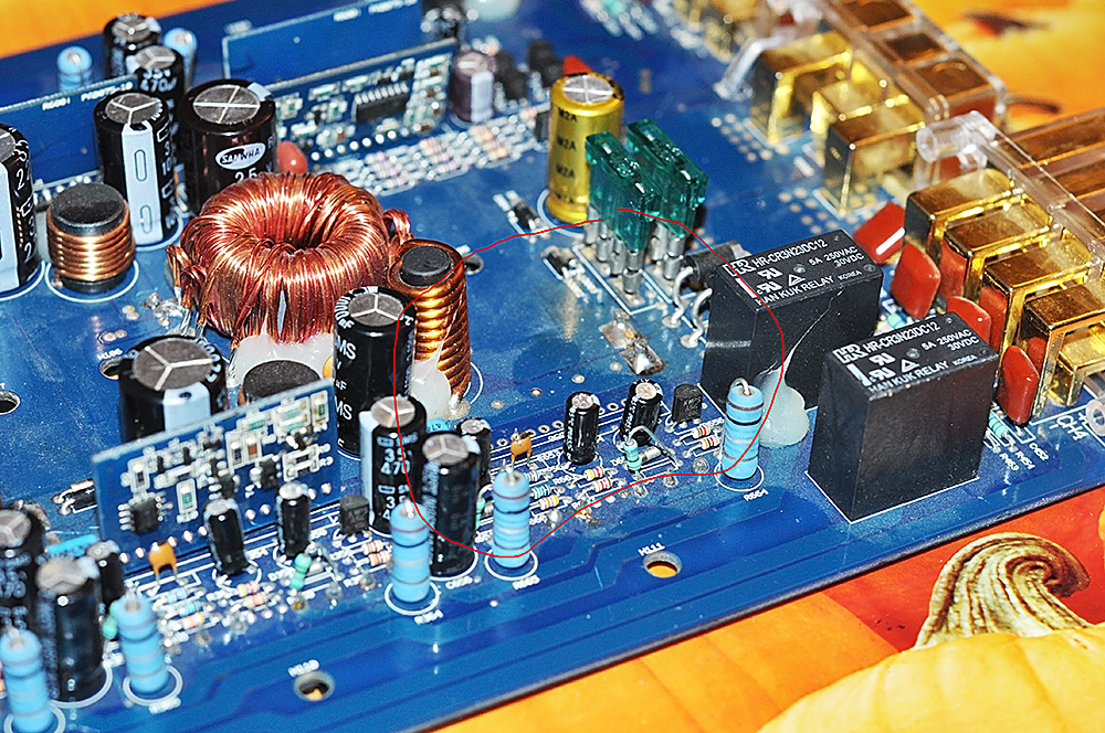

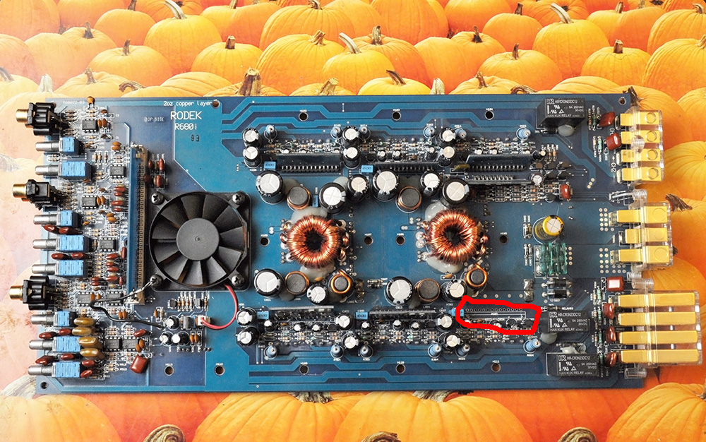

Hello,
I bought an used amp Rodek R680i. It is 6-channel. One of the amplifier end board is missing. I am now confused if it is better to try to repair in the original way, but it will be difficult without schematic, or to put one new amp board and new end transistors, but it will be different from the other 5 channels. Any help? I put some pictures.
Thank you

The amp will likely work as a 5 channel amp. Unless you're really motivated or have built circuit boards before, it's probably not worth replacing the missing driver board. If you could find a similar amp for cheap, it may be worth buying to salvage the driver board but it's probably not worth the expense. I have a schematic diagram for the R680A which appears to be a bit different. Email me if you want it.
