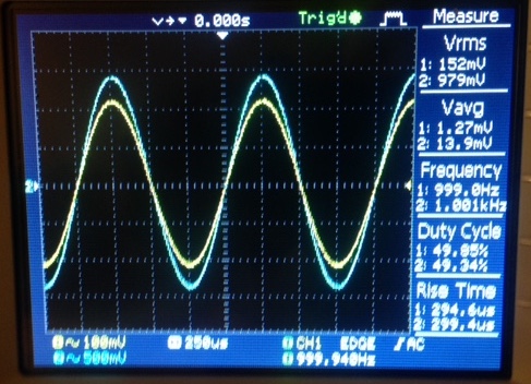

You've done something wrong when calculating the gain in the second gain stage. Here's the calculation:
Is the filter dampening 19.93 dB at 1 kHz? I just measured it and got to that number, which means it's correct for this circuit using my measuring equipment. (Quant Asylum QA401)
How about mathematically? It's not, as some claim, how much down it is from 20 kHz (in which case the number would have been 19.62 dB), or 0 dB at 1 kHz in a passive filter configuration. The filter has no attenuation at 0 Hz, so we need to know how much down it is from there.
This PDF says it's down -19.911 dB (page 113), so I'm not really that far off.

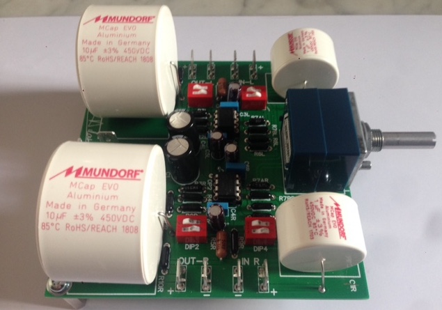

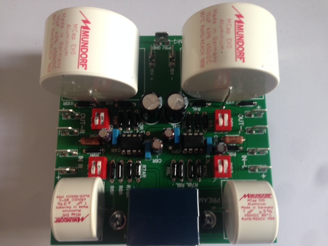

For sure, here it isNice!
I like your DIP switches, you wouldn't happen to have a part number for them?
76SB02ST
Nice one, I knew it's gonna be professional! Congrats hicoco
A hint for next time. You don't need faston connectors for signal input/output, unless you have a truck load of them and want to finish the stock.
2.54mm pitch molex connectors or 5mm pitch terminal blocks do the job fine.

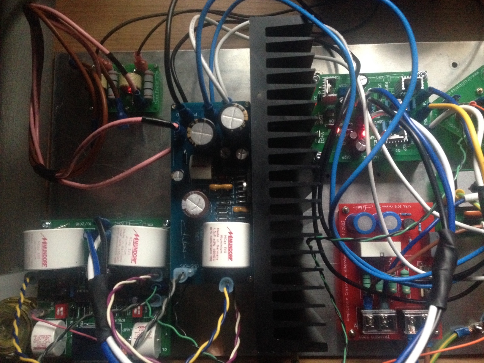

Yes Mixi, this is a very simple Preamp, working perfectly with my little 60W Amp (Lm3886), very happy...no hum, pure tune, like ivanlukic said this is the new p88 Monster with the 2 big Mundorf capnicely done! really nice! how do you like it?
Thanks Prasi...... yes i have a lot of faston terminal connectorsNice one, I knew it's gonna be professional! Congrats hicoco
I'm still testing with my test board and with the power supply board for the preamp, the LM317 and LM337 heat up a bit, I'll definitely have to put larger heatsink.at first i though your mundorf caps where overkill. but now i figured most polypropylene caps are rather large (compared to polyester) so why not use the mundorfs. actually i think i might use them as well
do you have a picture of your final setup with power supply?
