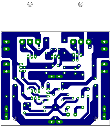

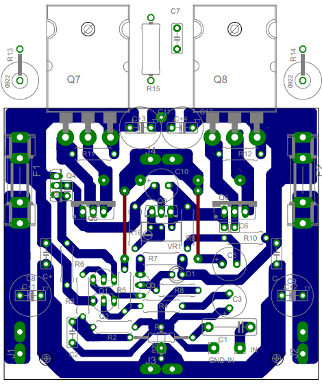

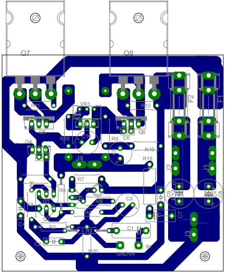

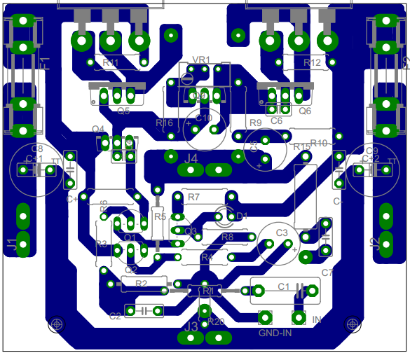

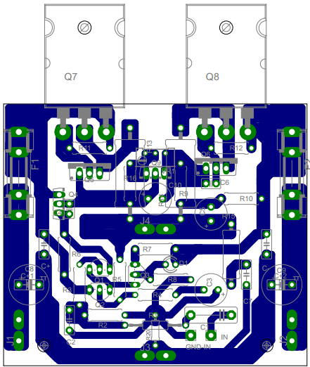

I see. It is a bit too close for R!3,14 so perhaps the Japanese style, radial lead ceramic box type would be better. 'Not sure what you mean about the input being closer to the output now. Could you point this out?
The speaker output is nearer the input stages of the amplifier...
D
Deleted member 148505
Hmm.. The second version has promise - the output stage tracks are commendably short in both. Perhaps reducing the trace length for the power input connections right back to minimum distance from the fuse holder (keep the place for the caps) would reduce input exposure to switching EMR. There appears to be room to extend the ground tracks to the decoupling caps and move them up too, as you don't need that big output connection pad.
My view is that the less and shorter power tracks on the PCB, the better. If that means removing the big hardware bits that do nothing good, like the spade connectors, then remove them, because leads can always be disconnected at the PSU end. I realise it is a DIY convention to fit connectors but I don't see any point duplicating them at every connection.

Now if you moved the supply input Power Ground up to the decoupling ground you could them completely delete the two edges of the PCB and delete that U shaped ground trace. Bring in the +ve & -ve Power input next to the decoupling ground. The PCB would end up being about 15mm narrower and all the High Current traces would all be at the output device side/end.

Like in the original p3a pcb...
Is the power ground contributes to noise in its surrounding areas?
Every circuit has a current that gets sent out and this MUST return to the beginning. If you arrange that circuit so that it is a flow and return pair then it becomes resistant to receiving interference and it emits less interference.
In a cable this is often achieved by running a twisted pair. In a 3wire PSU +ve, -ve & Zero Volts this would be a twisted triplet.
On a PCB the flow and return traces would be laid out as a pair. Either next to each other or or on adjacent sides of a multilayer PCB.
This Flow and Return pair can be applied to every circuit.
The Power Supply is one circuit. The output devices and the decoupling is another circuit. The output devices and the SPKR out and SPKR Return is another circuit, the Signal Input and Signal Return is another circuit.
Some of your PCB circuits are laid out for minimising that interference, either in or out. But your PSU circuit is spread around the PCB and will emit interference that could be picked up by the other circuits on the PCB or even in an adjacent PCB.
