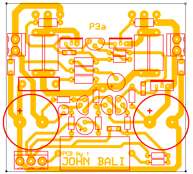

So here's my PCB design that I keep & now I need some critics
So anyone feel free to critics me
there is two red & orange and I don't sure which one is better.
Thanks to Rod Elliot who give us free schematic

@John Bali: 1) It would help if you posted a layout with the component reference (in any form) superimposed on the layout, or component values, or something like that.
2) My personal preference would be a layout with electrolytic capacitors for rail decoupling on the board. RodE may know this is not absolutely required, but then again, he knows exactly what to expect. Making a new layout from his schematic, I would follow common practice and use at least one per rail (like the yellow layout). Sakis has posted about larger decoupling caps here, and I would suggest reading his posts about component selection for other tips. I have found his comments on the P3A very informative.
3) At a glance, I can't find the trim pot on the yellow layout (see my first point).
4) Ground trace on the first layout (red) should probably be a bit bigger. Personally, I would err on the side of safety, so to speak, and just make power and ground traces bigger than necessary. Since they are to the outside of the board, one can safely make a circuit board bigger in outside dimensions, while leaving the signal circuits as tight as desired in the middle.
5) I see the transistors lined up for a common heatsink, but I would also say make sure your intended heatsink will fit, space on either side seems a bit tight.
