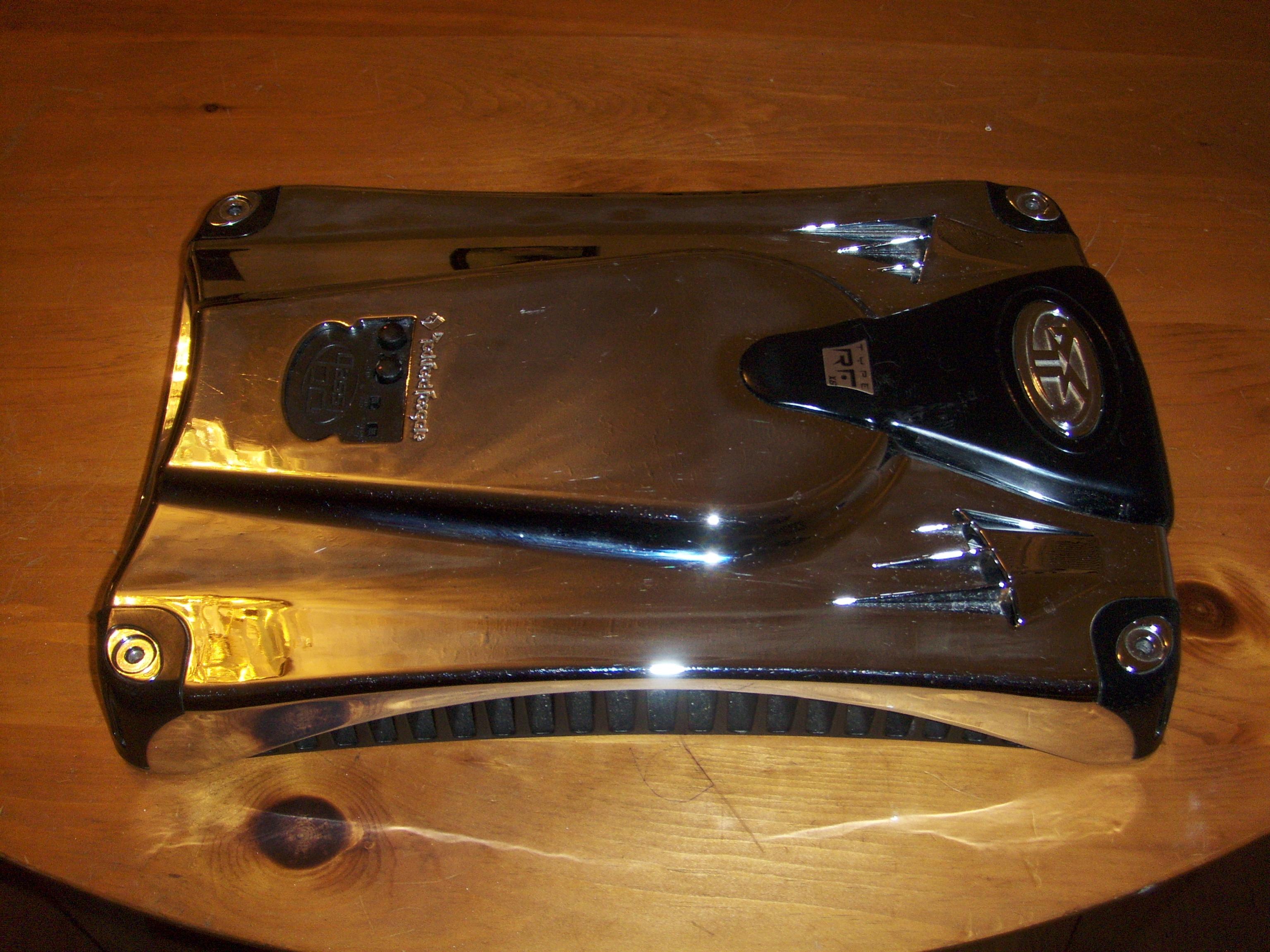

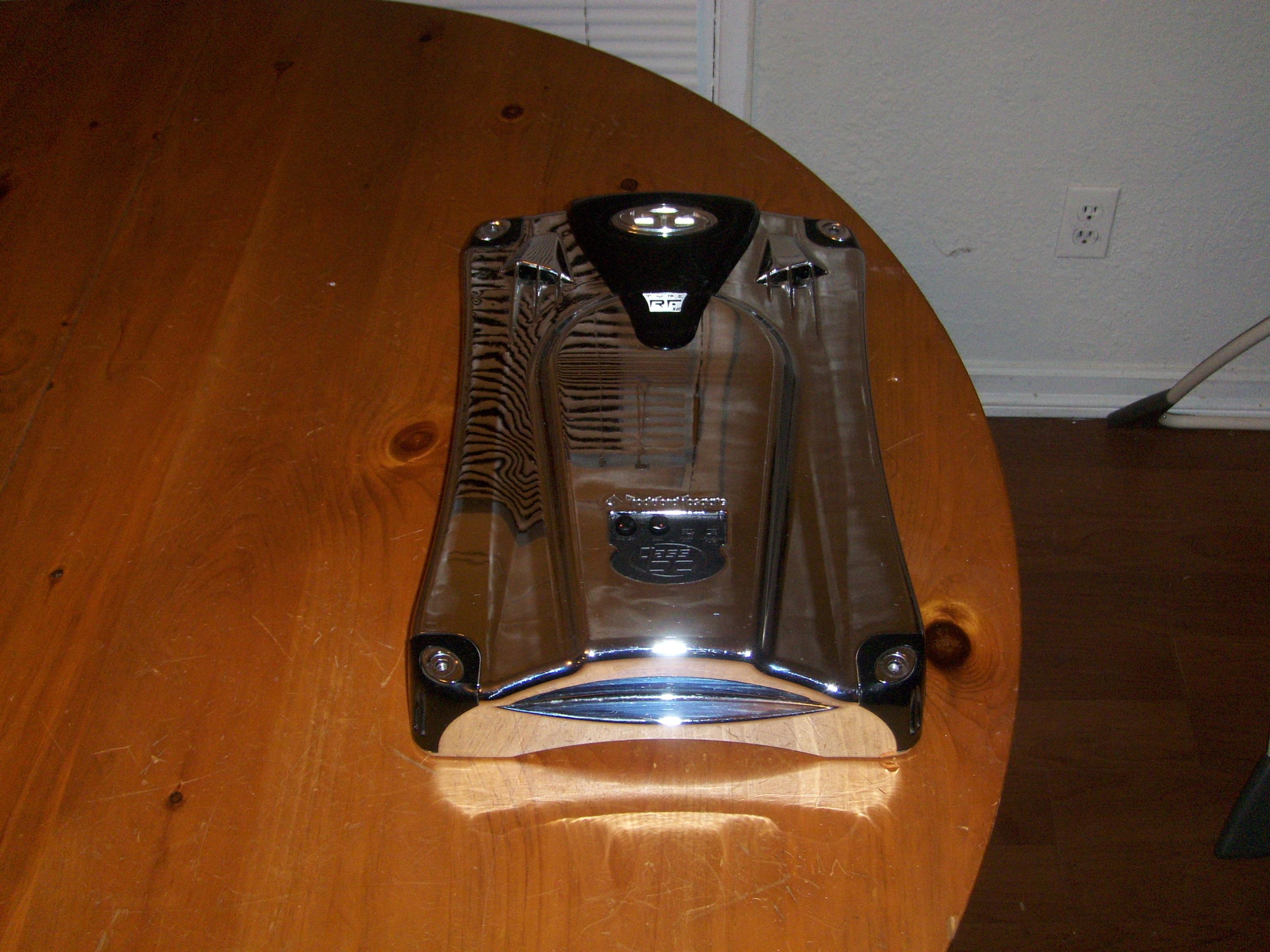

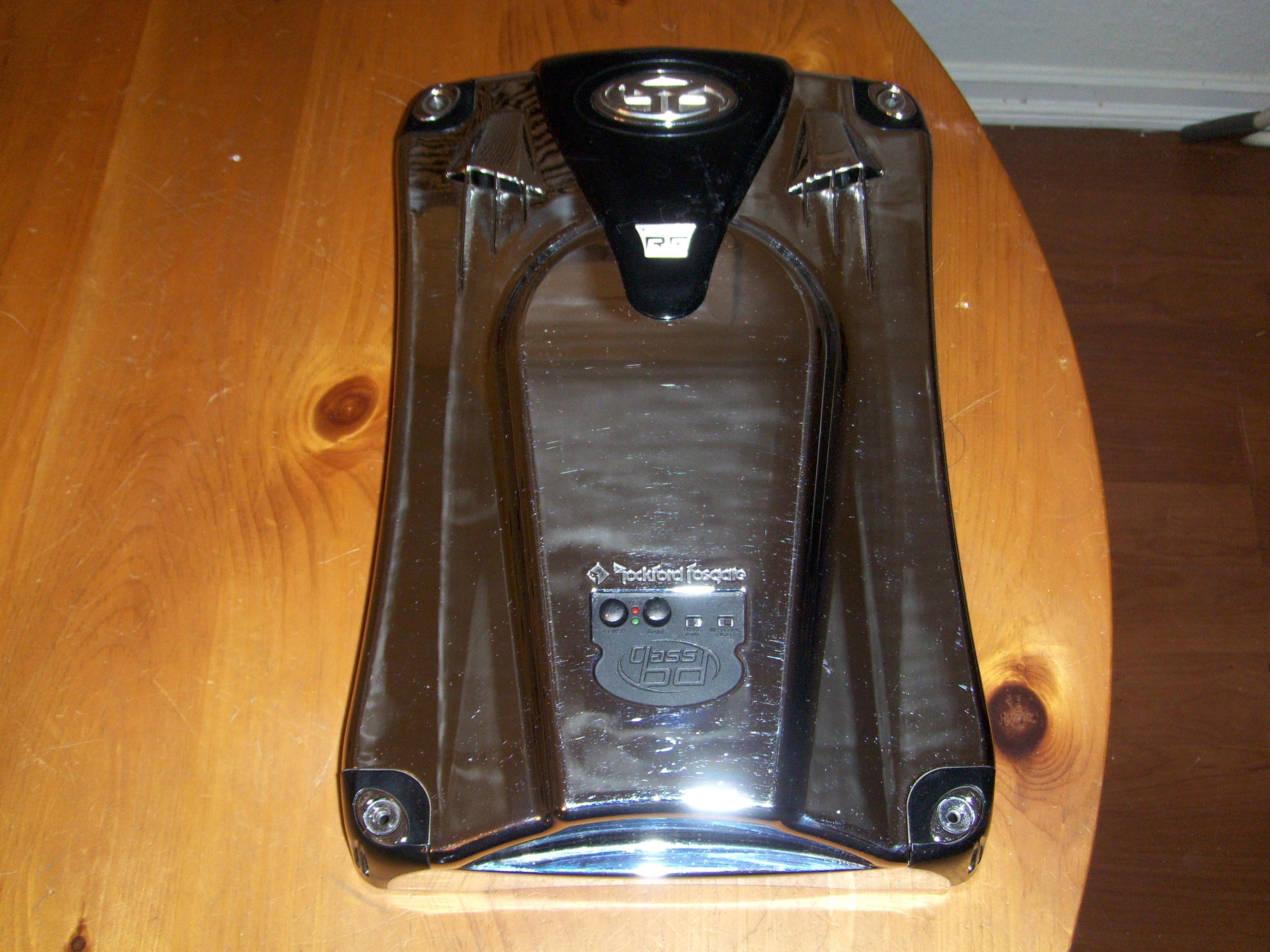

I posted a few pics.....love the look of the Type RF Chrome series amps!!
