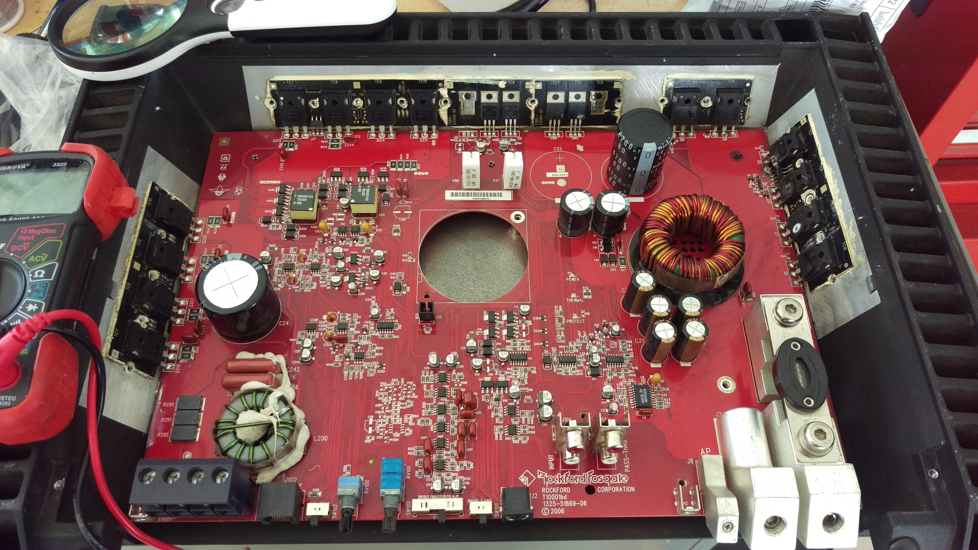

How would that happen Perry I tested the dc with the main ground and got numbers just nothing on the outputs. Psfets yes source has the 12v.? Am I missing something?
I got a voltage reading from the top of ground and b+ and remote? I don't think so but I'll try something else. It's strange to go to nothing like that like.

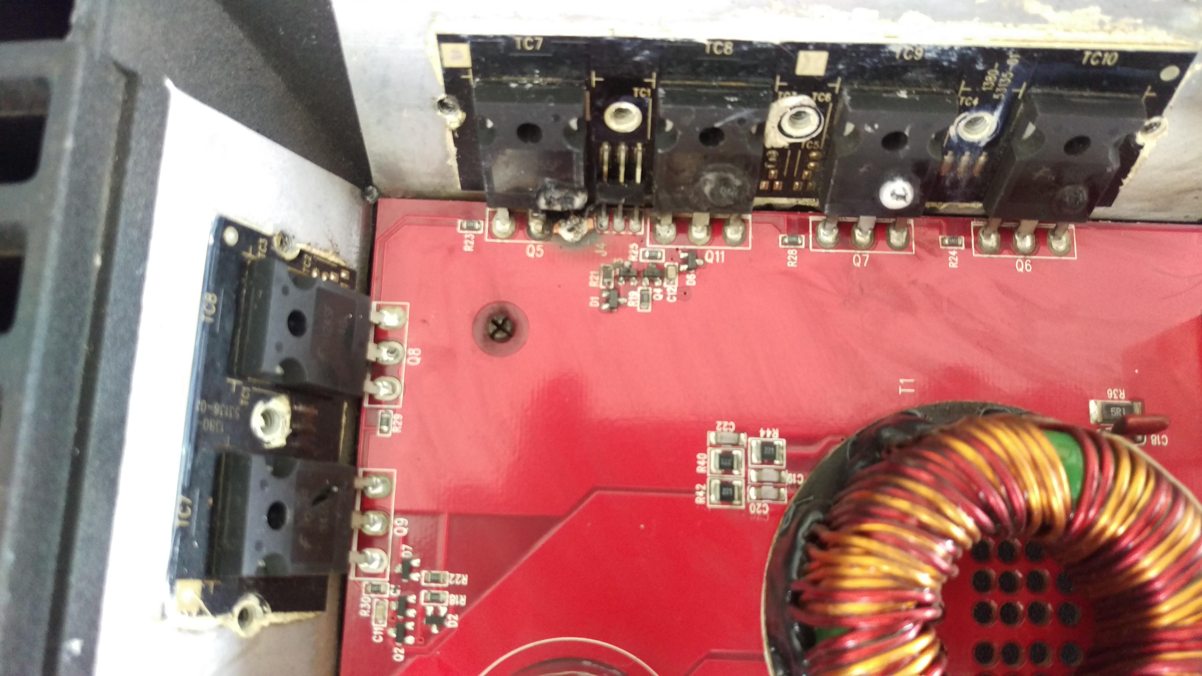

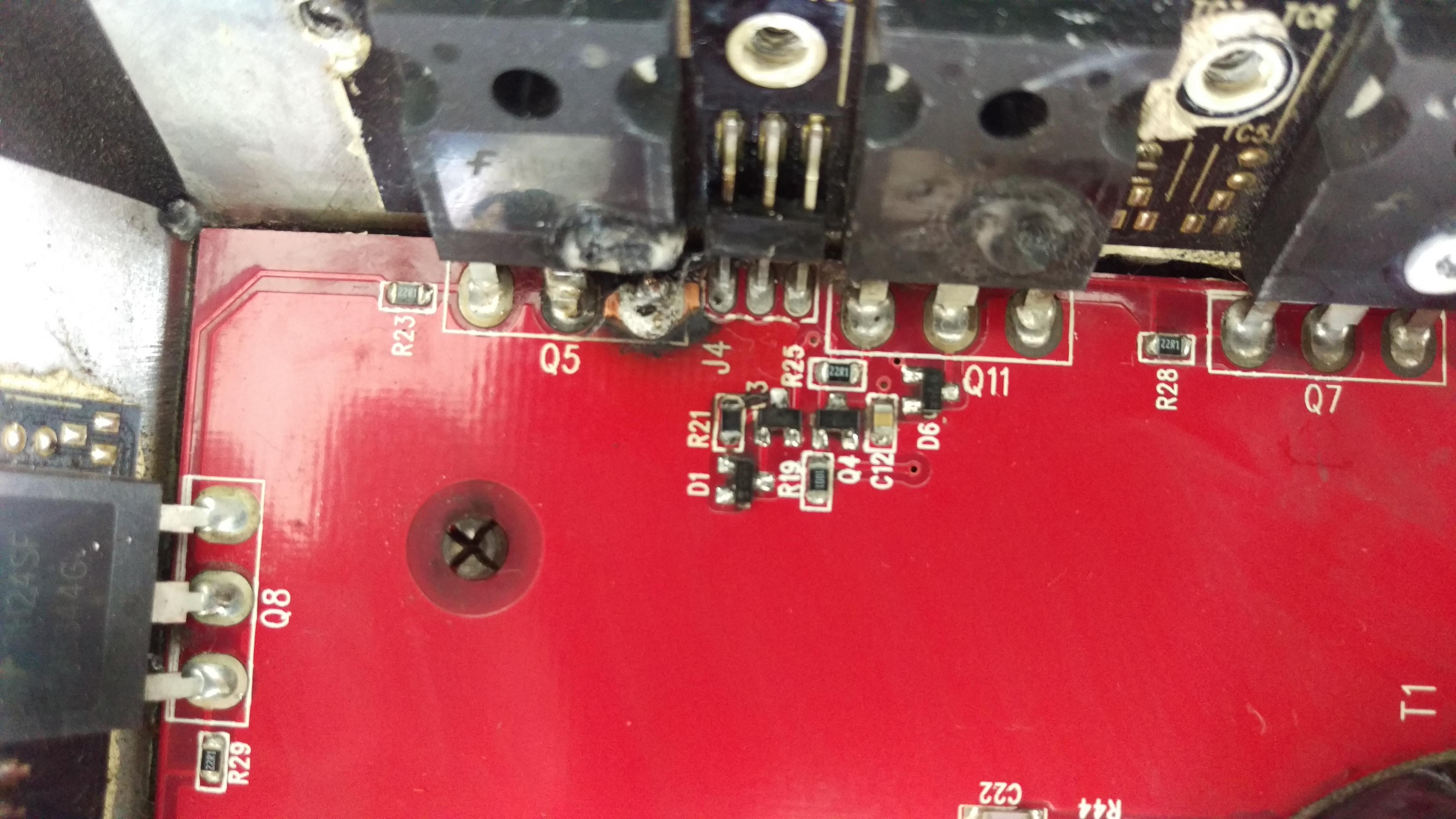

The board was burnt badly and sodered pads are missing. So I went back over everything and removed it from the case and it's back to powering up. At 12.4v at idle it drawing 2.8A seems high to me? I have the scope now if that would help?
