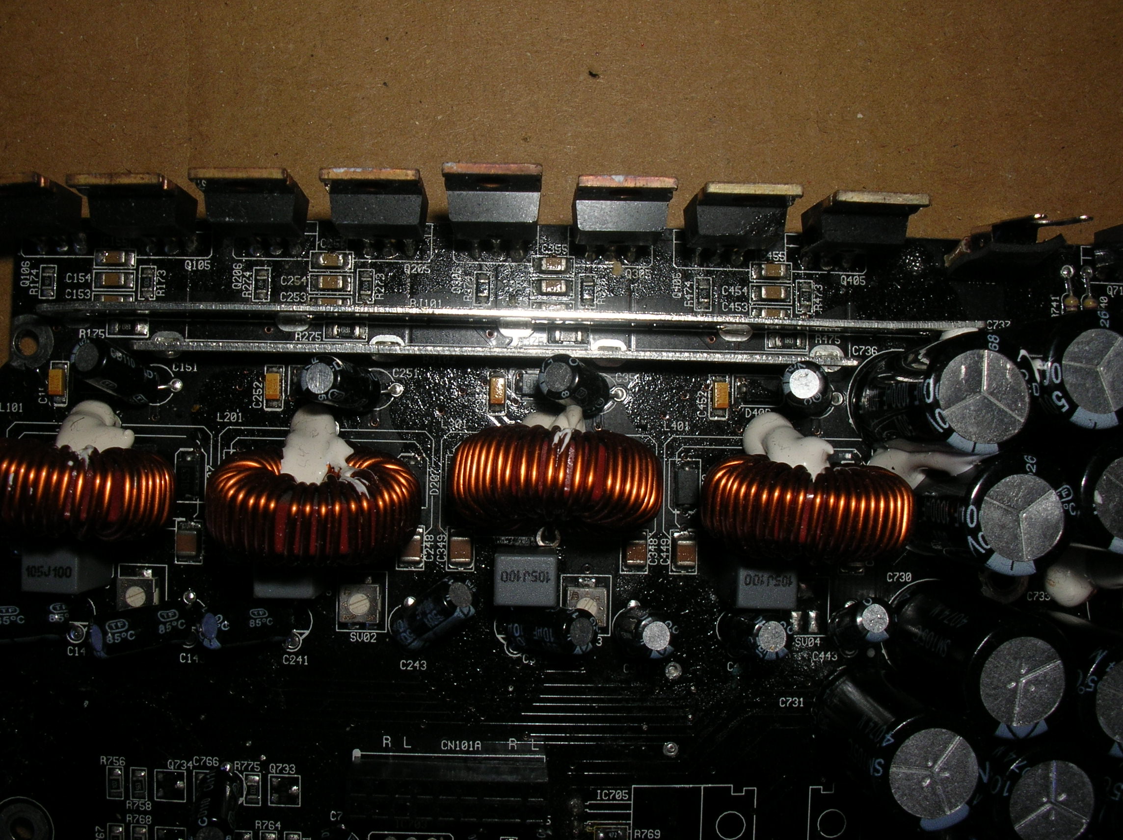

Today I received this amplifier to repair, in which "someone" has put his hands to try to repair it ...
As you can see in the first photo, five electrolytic capacitors were completely loose from the motherboard (these capacitors had lost their capacity and are swollen)
There are also some components that have been replaced by other dubious features ...
All the base plate is covered with a special varnish, which makes it difficult to read almost all components ...
Does anyone know of a scheme?

I have managed to run the power supply, I have replaced the damaged capacitors, and two resistors that were open, the rail voltage is present (49 volts).
When the amplifier is connected and signal is applied to the input, nothing happens, no sound appears.
The voltage at the audio output terminals is 0, 65 v.
I have checked all output FETS without finding anything strange, I have also checked if there is voltage supply in the preamplifier card (12.53 v are present).
Is rare...
I am a little lost, in this type of amplifiers by its condition and typology (new class D)
Does anyone have any ideas?

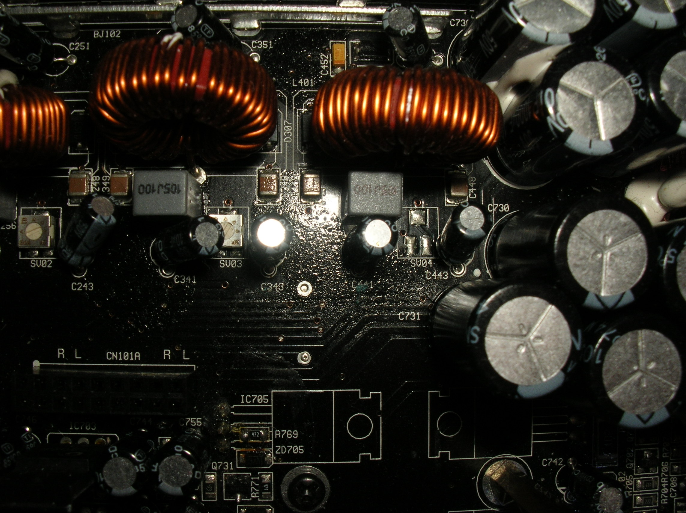

well, I want to know if it is normal for a regulator to be missing in the bias setting zone of the fourth audio output channel.
class D topology not have bias regulation, probably this trimmer set output offset.
i think that this amp use irs20954S to create the class D stage.
So, check the VCC voltage, referring to -B voltage.
For info, VCC is intended the voltage required for low and high side (via R+D) driver and have the reference to -B.
+B and -B are the main rails voltages.

If the rail voltage is present and there is also the pre-amplified regulated voltage, the only thing that the 4 channels share is VCC on the pin 10 and the supply voltages of the modulators (+/- 5.6v on pin 1 and 6)
Rail tension is present (48.8v) in the two metallic strips that are observed in the photo, I suspect that B- is the longest strip, from there taking the negative tip of the multimeter in B-, and the positive in the drain of the FETS of the out stage are observed 25v and 48.8v respectively in each pair of FETS.
Pin 10 of each IRS2092 is -24.7V with the negative probe of the multimeter to the negative of the amplifier.

For this reason, on the pins 1 and 6 of all the IRS2092S there should be 5.6volt (with black probe on PIN 2 of all IRS2092S) instead, on all pins 10 (of all IRS2092S) there must be 12volt (with black probe on -B).
When I talked about "preamplifier voltages" i meant the DUAL voltage present on the preamplifier board that isn't SINGLE 12volt, but usually +/-12v (if are installed TL072) and you must see this on pin 4 and 8 of all op-amp (with black probe on pin 2 of all IRS2092S)
If u have big different voltages on pin 1 and 6 of all IRS2092S probably u have problems with this part of circuit or a defective IRS2092S.
If u have 0 volt on pin 10 of all IRS2092S (with black probe on -b) you have surely a bad regulator (and probably, this is the main cause of your issue).

Measuring the voltage between drain of fets and -b is wrong.
If you want, can measure +b and -b like this:
- black probe on pin2 of IRS2092S
- red probe on leg 2 of hi-side fet (now you must see +b= 48v)
- red probe on leg 3 of low-side fet (now you must see -b=-48v)
any little differences (decimal volts) it's not important/relevant.
So, if you have tested and no problems found, your primary problem is the absence of VCC.
Go backwards in the circuit and found the regulator or the part of circuit that provide to create VCC. If u can, share photos here!
