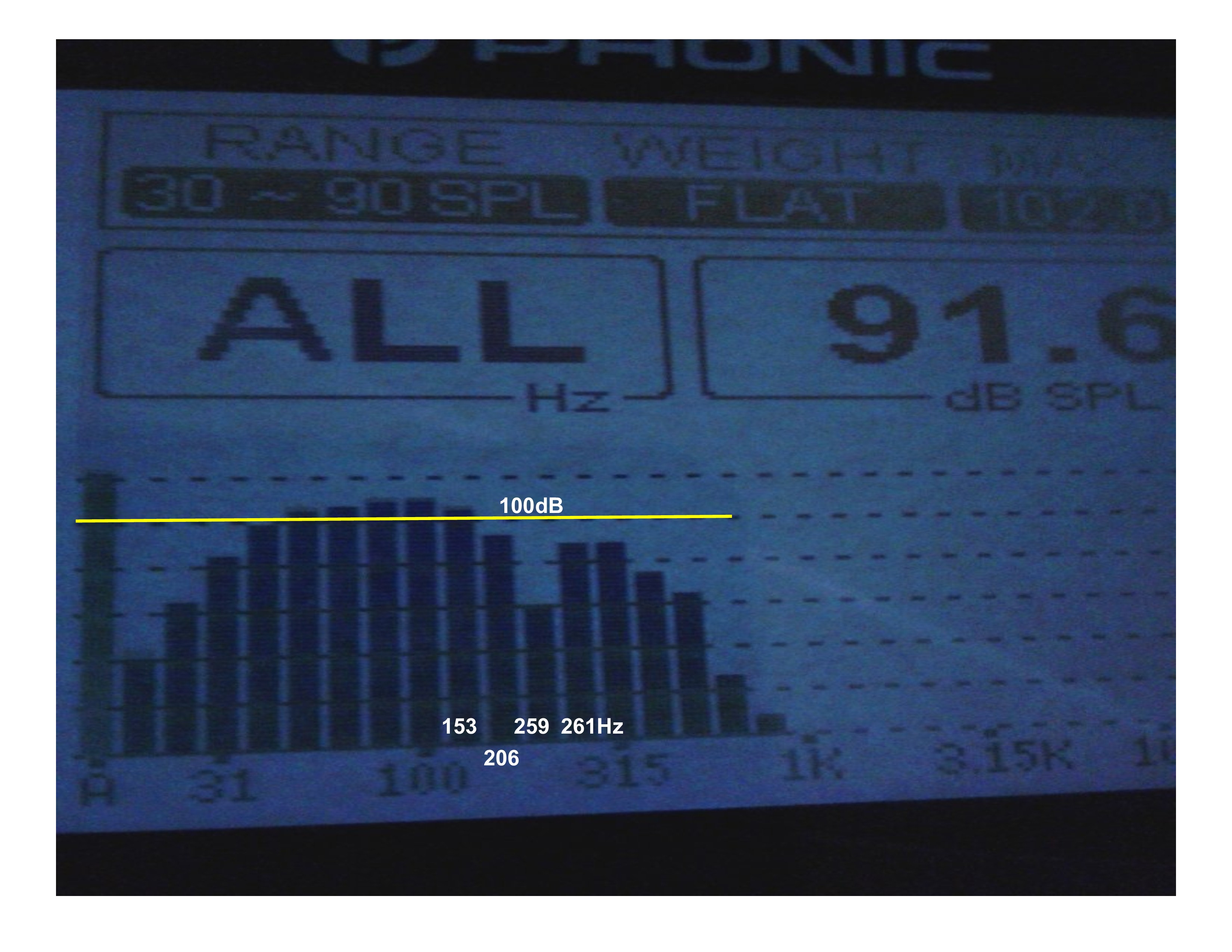

Am I correct that the ROAR15 can play 206Hz at around 97 dB?
There are likely group delay issues that affect sound quality up that high.
I would say no, when listening to them I find that the highest usable (with regards to sound quality) frequency is around 150Hz, currently i cross them over at 158Hz but rather steep (48dB/Oct), but I'm still getting to know them, according to the photo the dip is indicated between 160 and 250 Hz somewhere, my guess it is below 200Hz.Am I correct that the ROAR15 can play 206Hz at around 97 dB?
I say this since I think the frequencies in the RTA photo are 100, 125, 160, 200, 250, and 315Hz if it follows the ISO standard for a 31 band unit, which I'm pretty sure it is, not totally sure though.
