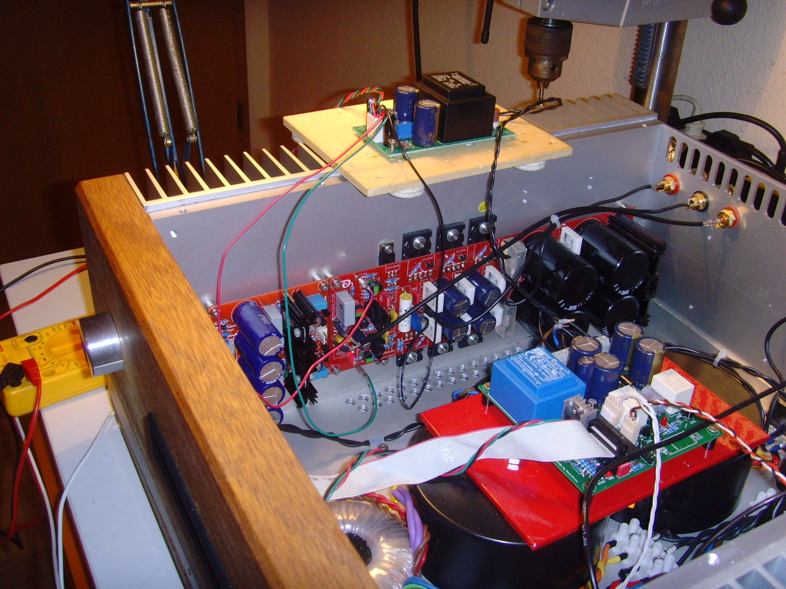

Jaack, when Mihai designed the FC-100 (his 1st post revealing the FC-100 amplifier is from November 2007), the Linear Technology LT3062 voltage regulator
has not yet been "well-known", and I suppose that this is the reason why Mihai designed a shunt regulator (the "Non-Plus-Ultra" at those former days)
to provide power to the FC-100 frontend.
My 1st FC-100 - build used exactly this frontend (see attached Image 1).
Current regulators like the TPS7A47 (for "low" Output voltages) or the LT3062 (for output voltages up to > 40VDC) provide low output current (< 200mA in
case of the LT3062) with "extremely low noise" on the output voltage (30µVRms).
I have abuilt a dual LT3062-based frontend PSU (giving about +/- 38VDC) (for test purposes) and have compared it to Mihais shunt.
I do not "hear" any difference.
On the picture below: Mihais shunt Regulators is placed in front of his FC-100, the LT3062 is put on top of the heatsink.
A "nice-to-have" side-effect: you only need 1 (!) dual LT3062 - PSU in contrast to 2 (!) shunt regulators for a dual-channel FC-100.
I am sad to hear that you have wrecked my LT3062 PSU - PCB.
But: do not give up and learn how to solder.
The FC-100 is worth every cent that you investigate.
Best regards - Rudi

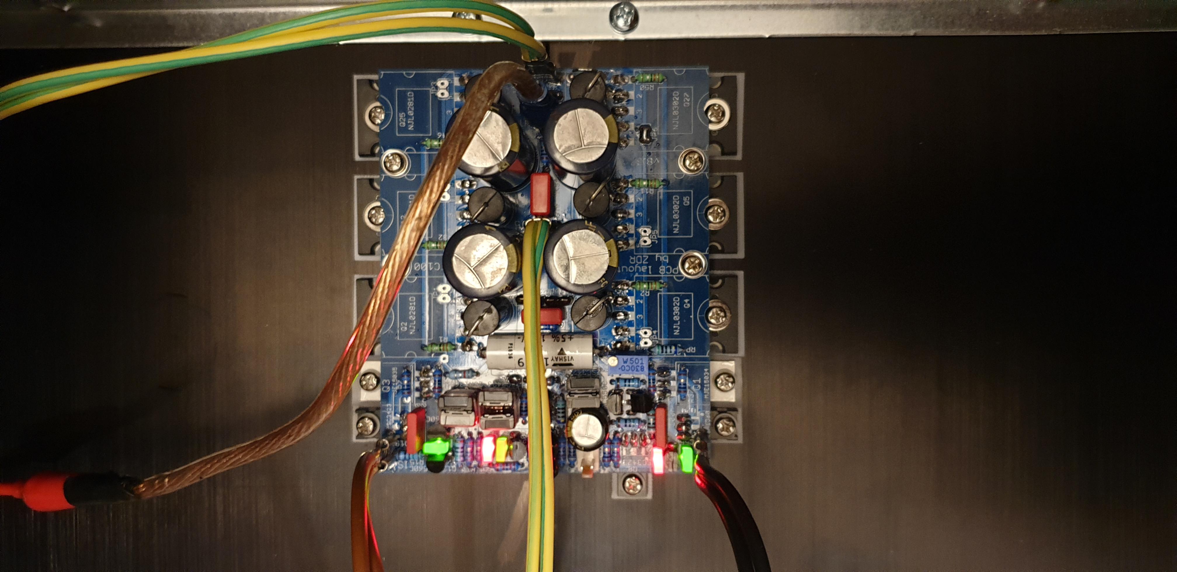

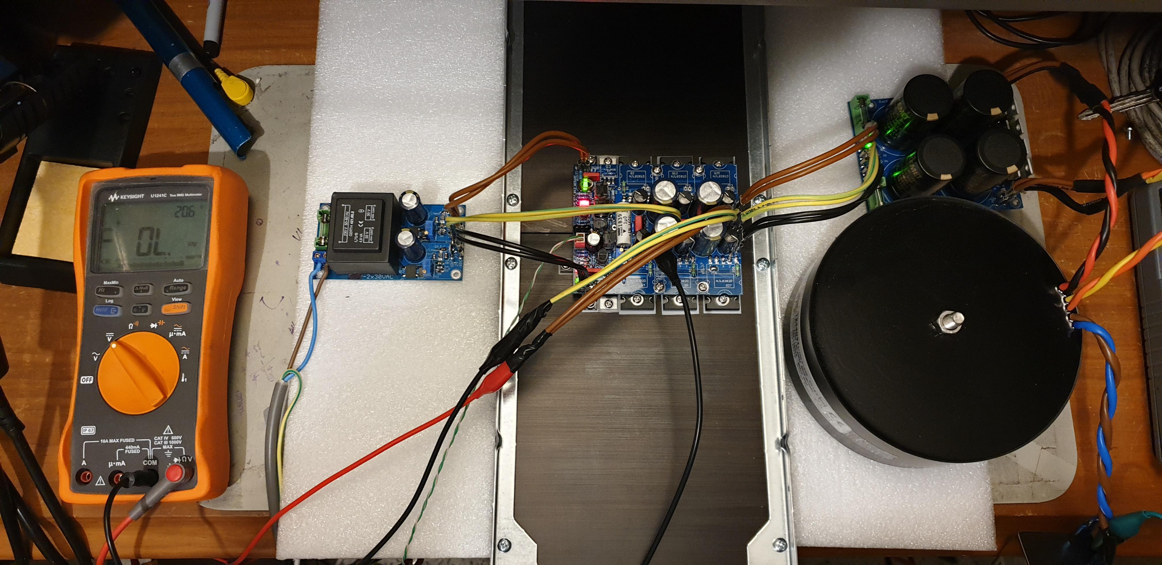

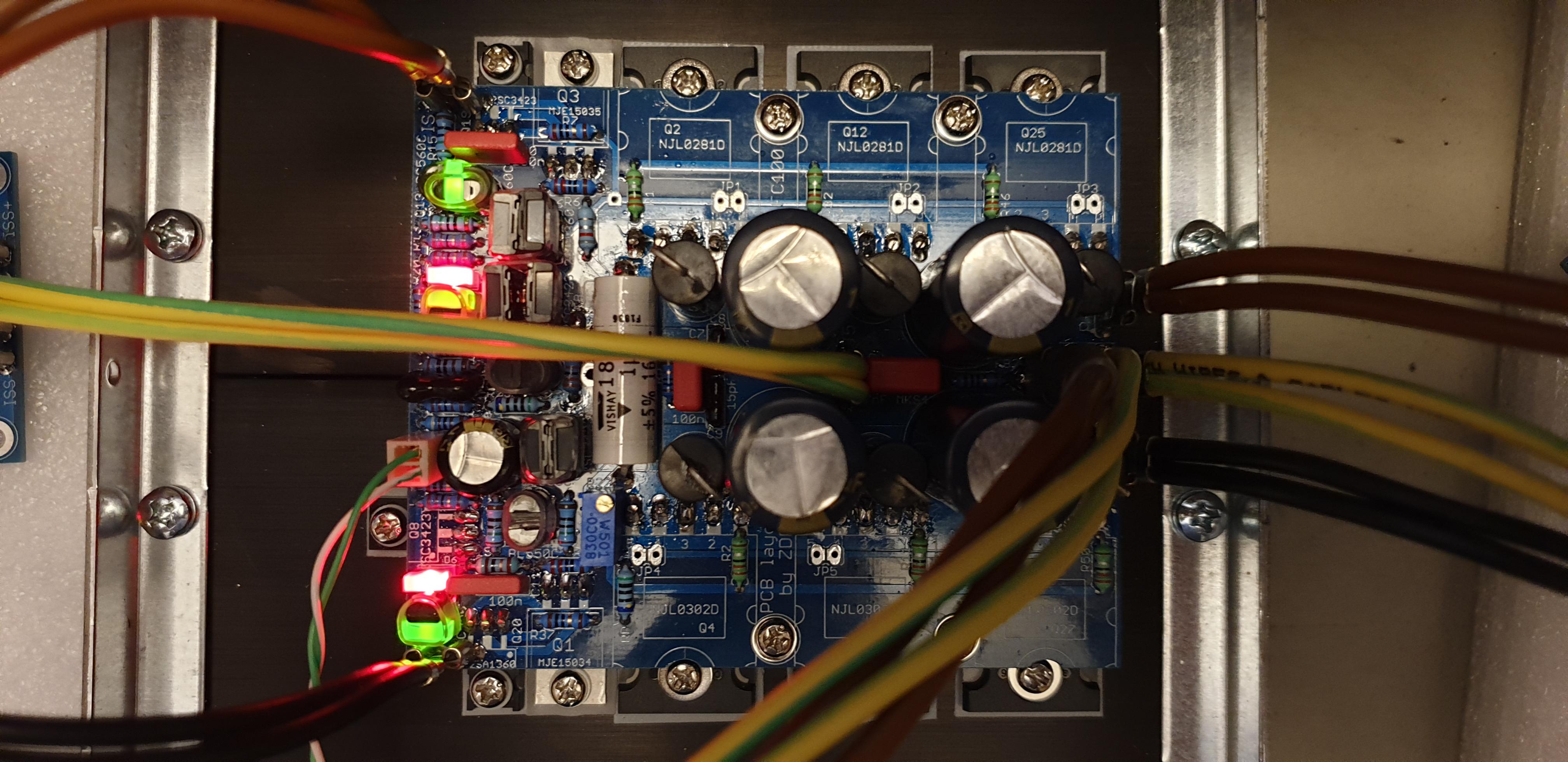

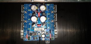

Hi All,
I just built the RMI-FC100 using Zdrs boards.
The power supply works well but when testing the front end the negative rail
Is loaded down too much only Q6,Q7 and Q10,Q15 pairs are hot to touch, all leds light up. Does any one have any ideas what may cause this... pic attached

Dan, without knowing your voltages this is what I would do:
1. Check Vbe voltages across all transistors above and voltage points (see RMI FC100 doc on my site)
2. Check if all transistors are of correct type (NPN/PNP)
3. Check resistor values
4. Compare with other channel - is it behaving the same way? If not, where is the difference?
Ok finally Success ! I had a solder bridge on a very small solder pad on the input.
Happy to say I was listening to the first channel last night.
First impressions are very good!
DC offset is only 2.4 mV, bias is 200mA per transistor,
Can't wait to case it up

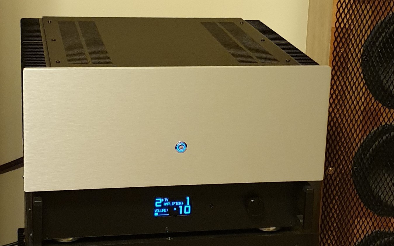

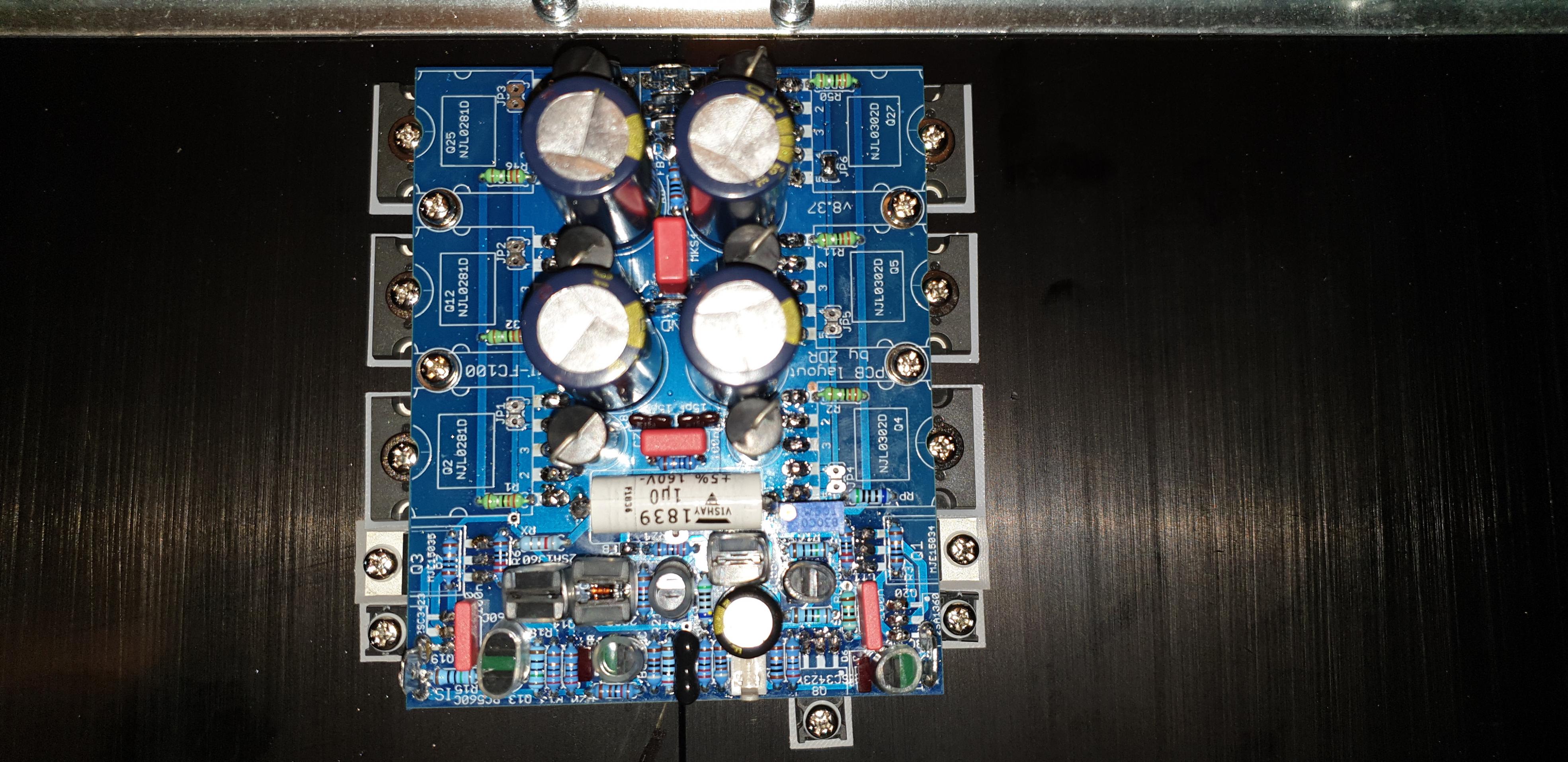

RMI-FC100 working !
A couple of build pics for this one, it is running and I am super happy with the sound.
I am running 200 mA bias per output transistor.
DC offset is 1 or 2 mV cold and 0.5 mV warm.
AC ripple on the output (hum) is below 100uV rms with no input.
The amp is so quiet you cannot tell if it is on with no signal applied with an ear on the speaker.
The sound quality is excellent, in comparison with JLH, Hiraga, Krell clone mono blocks, it really is a great design.
Credit to Mihai Ruata's design work and credit to Neb (ZDR) for the compact board design.
