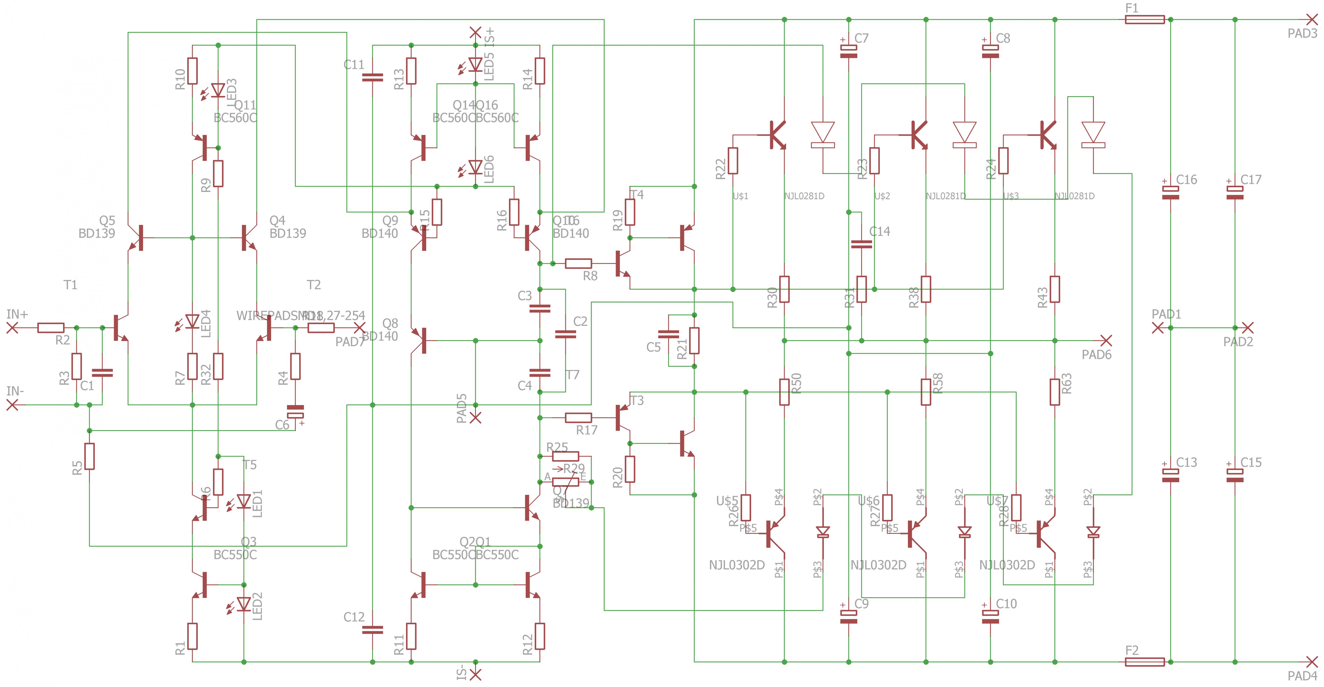

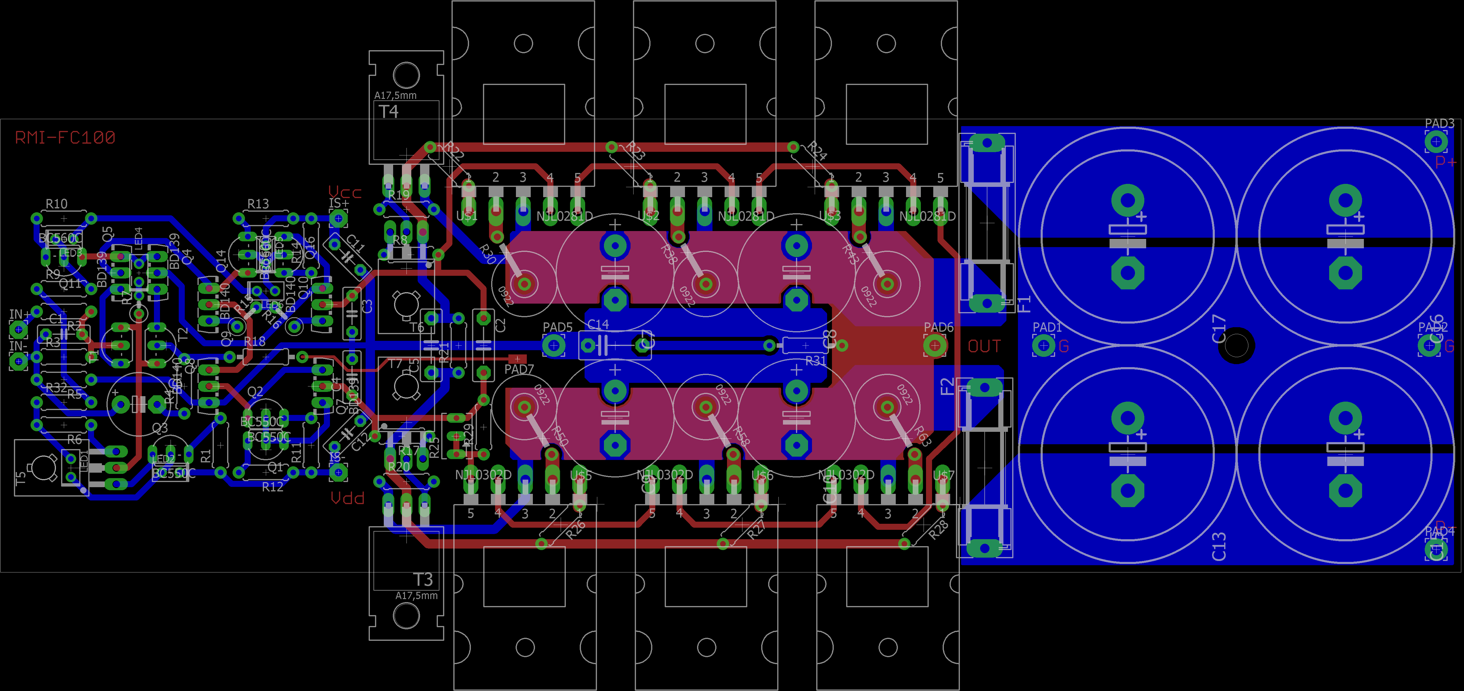

I am preparing to build this amp from boards a friend sent to me. I just want to be sure that I have the correct files. I am attaching them here. I someone would please confirm them I would greatly appreciate it. I have already built and tested the shunt boards.
Thanks, Terry

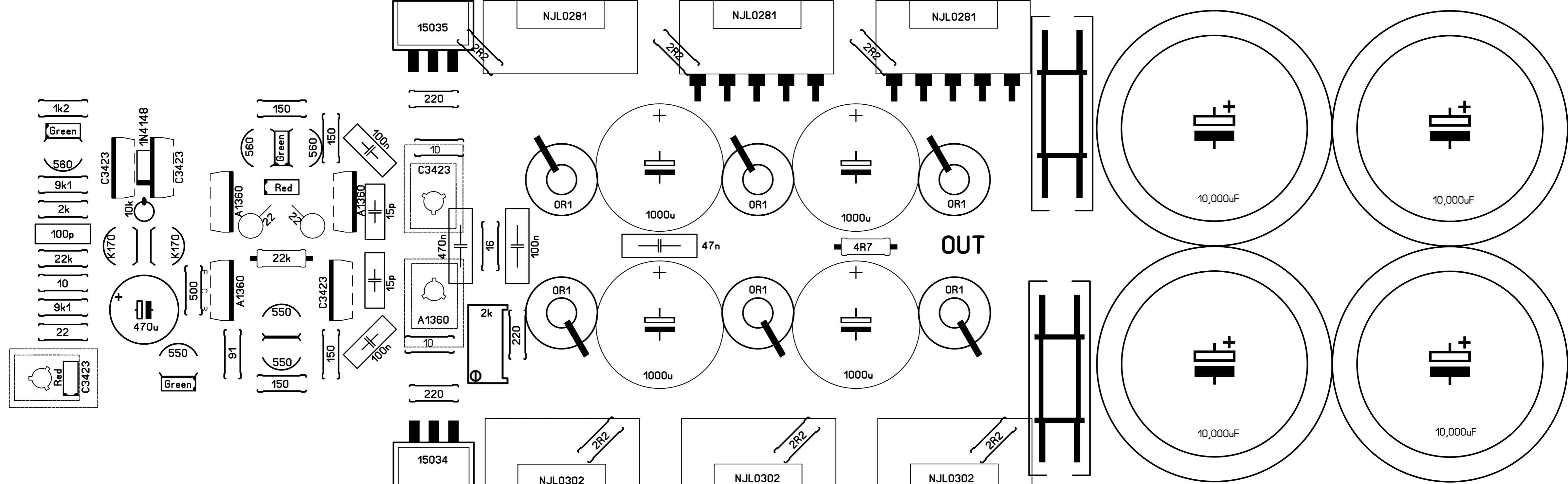

Hi Mihai,
Thanks for answering. My issue is that I am trying to find a schematic that has the part numbers that agree with this layout and gives the part values. The only schematic I have been able to find uses different part numbers. I have been attempting to cross reference them but worry I may get something mixed up.
One other question. The layout has a resistor in parallel with the trimmer that is not on either schematic. I have been searching through the thread but have not been able to find it.
Thanks, Terry
Putting a resistor in parallel with trimmer is a well known method used to limit the total resulting value in case of trimmer fail open. Resistor value depends on trimmer value. If you'll use 2k trimmer then resistor should be around 220ohms.
Regarding the component values, is not hard to correlate EAGLE schematics with the one attached at the beginning of this thread. The only components missing in the non EAGLE schematic are power supply capacitors (2200uF, located very closely to power BJTs and 10kuF located immediately after fuses)
