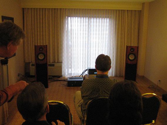

I stayed in Orion room most of the day; I think I saw Lynn too. I can confirm that SL has used all 12 channel of the ATI amp, he bridged 2 channel to feed the woofers.
SL and his wife were nice enough to let me listen to Pluto, probably because I arrived early and there was not many people. It was very good and in first impression I like Pluto more. Perhaps I used to monitor type speaker.
During the day, I tried to listen to Orion as much as possible to get familiar how it sound, in a muscial way, which mean how well it will lead me to tap my foot. I'm so glad that Orion+ did not disappoint me, and it is now on my diy list.
