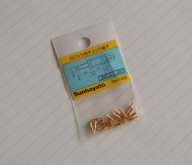

Thats why I didn't put better caps in right away. I want to exerience the way different caps sound. I might need to get som pins, like the ones mentioned. Dont suppose any of you have a partnumber/vendor for them?
Bibio kindly gave the Mouser parts for some pins in an earlier post.
I have found the following at the local store which does the trick nicely. They are sold as "logic-level check terminals" rather than standoffs.
