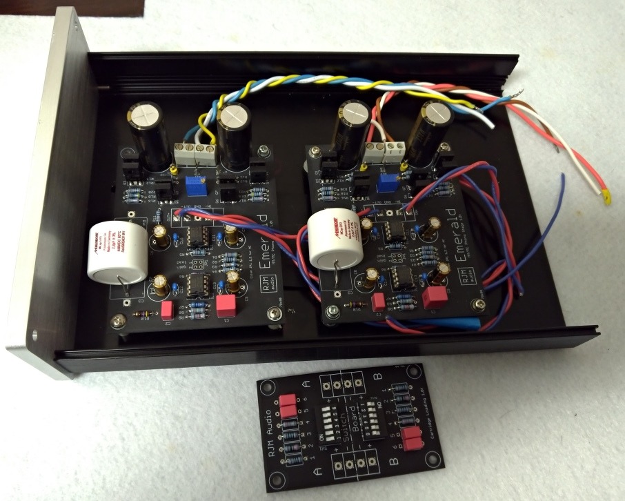

My Emerald is working now in MM configuration and liking what I hear.
So far it looks more transparent and linear than my dual diy ECC83 phono stage.
There's a bit of noise cranking up the volume with an MM cart on (I did not try it with shorted inputs yet) but it is promising.
With boards from MRA with smd components, hotrodded voltages to the opamps are set to 14,8VDC/15,2VDC from a 23VDC CRC power supply (trafo is dual 15V and R20,R21 increased from 10k to 12k). It looks the temps are still cool and safe.
Thanks a lot @rjm Richard for this great project!

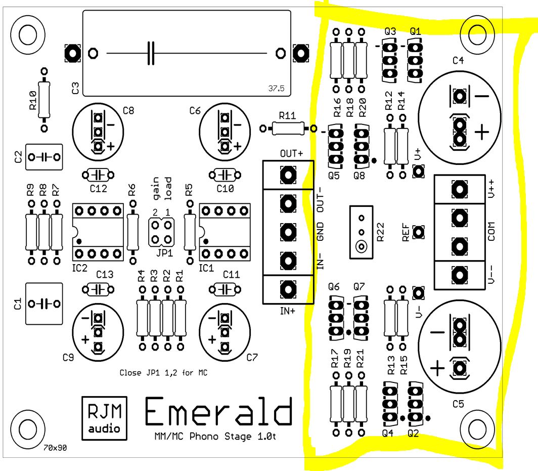

I will be using an external PSU that provides ultra low noise +/- 12V.
I will be wiring them to the V+, V- and REF pads, or to the relevant pad in Q5 and Q7.
I will be omitting the marked section in the PCB, but my question is whether I should also omit C6-C13 or are they required for local bypass?

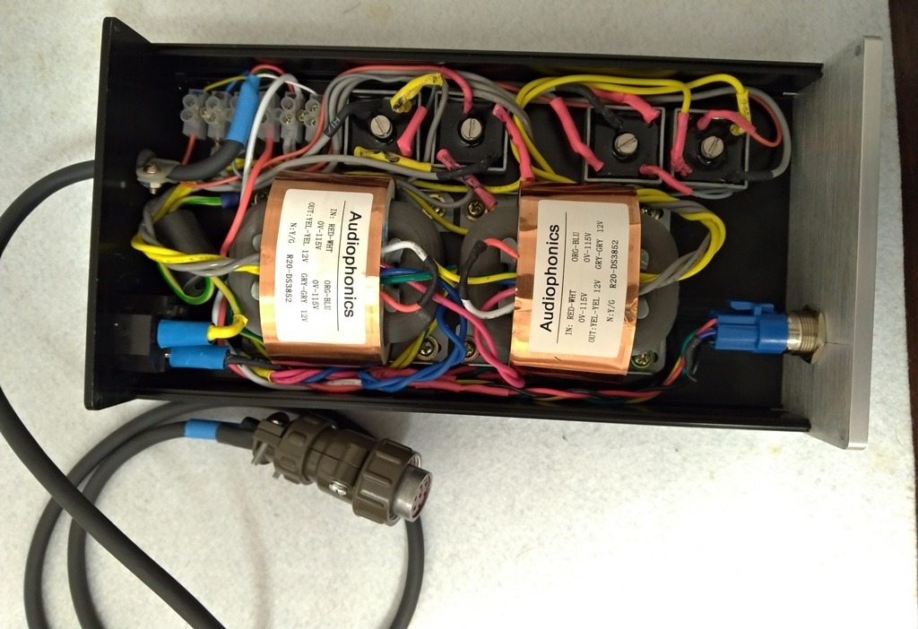

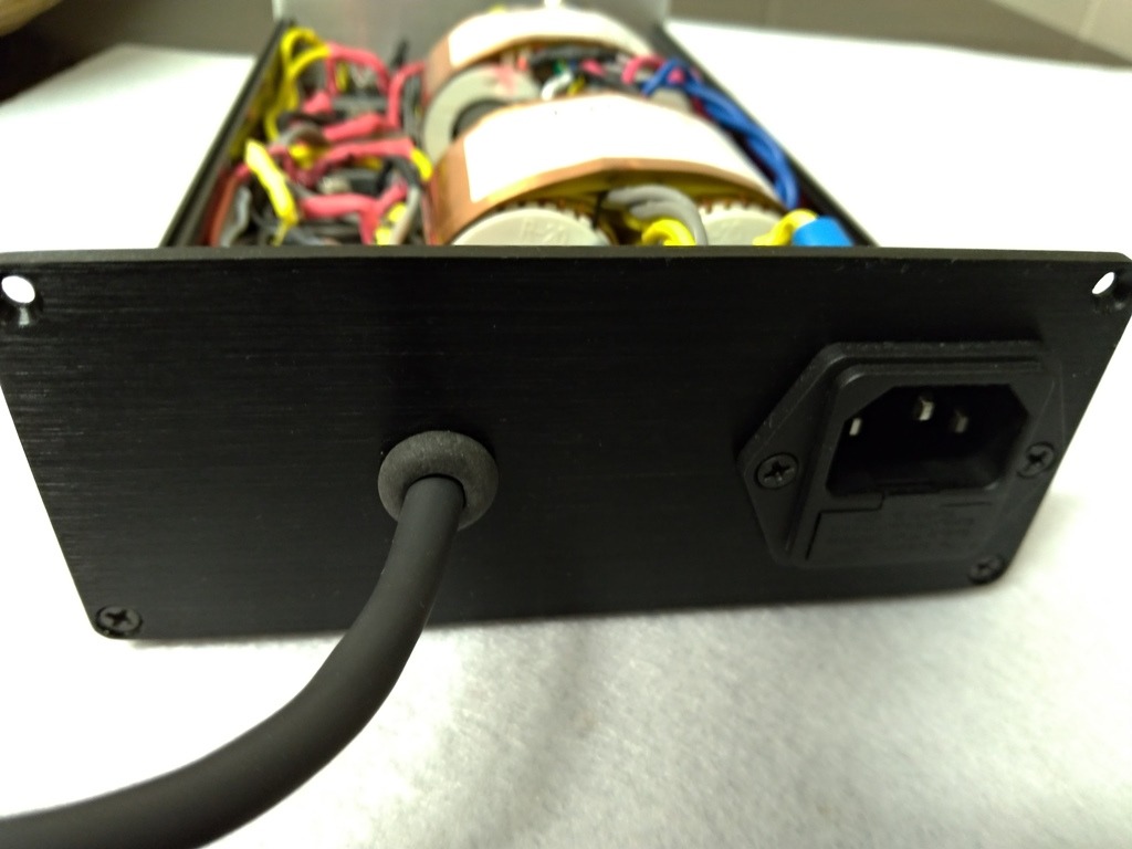

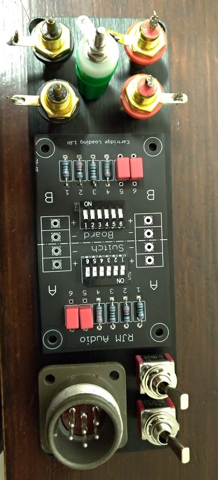

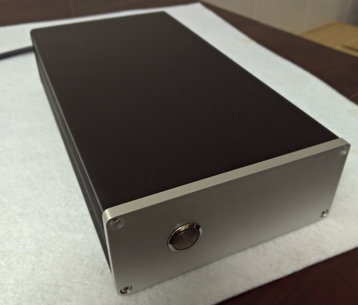

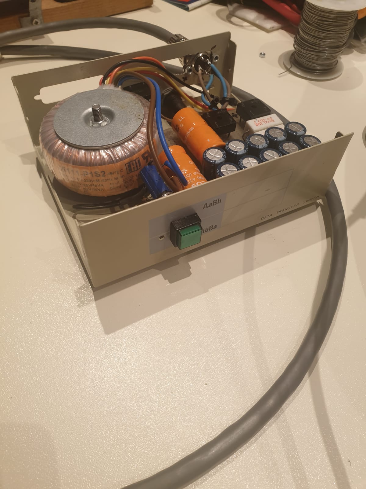

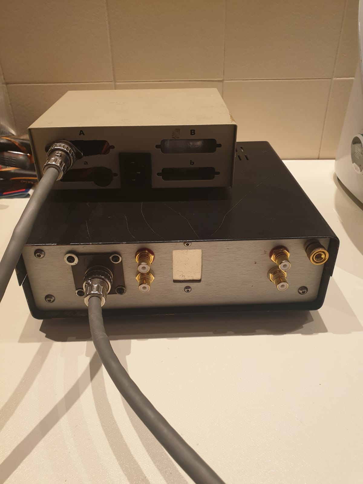

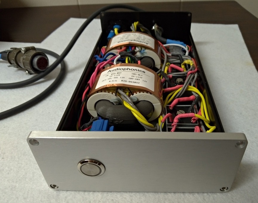

Hello everyone
I'm finally working on my Emerald, having finished the power supply, I haven't finished the Emerald chassis yet.
The power supply follows the dual mono philosophy and is connected to the Emerald chassis by cable.
And here is the time when I wanted to ask a question to Richard, the multiconductor cable I am using has a shield, should I connect the shield to the GND of the boards (it is not connected to the power supply) or is it unconnected?
Or is it about experimenting and testing?
Here are some images of the power supply and one of what would be my intention for the rear of the Emerald chassis, but I have already simplified this intention in the meantime.
The switches on the pcb-switch board that would be accessible through two "windows" will only be accessible from the inside, as the pcb switch will face inwards.
Later I will post developments on the completion of the Emerald chassis.
My thanks to everyone, especially Richard and a happy new year to everyone.
Best regards
Carlos

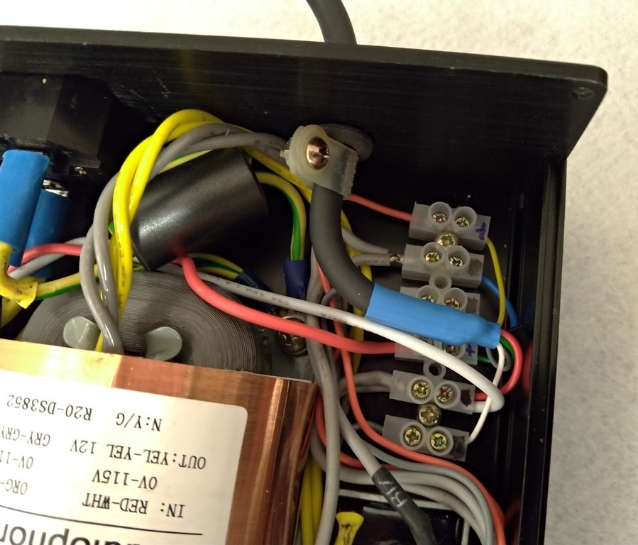

Hi Carlos,
You have a two different options with the shield connection.
1. Connect it to the chassis at both the power supply and phono stage sides. This arrangement gives the same electrical connection as the one-chassis builds. The phono stage chassis is now connected to earth because the power supply is now connected to earth. The potential issue here is the system may also be connected to earth via. the amplifier, which can lead to ground loops.
2. Connect it to the power supply side only. This arrangement retains the electrical connection of the two-chassis build, which leaves the phono stage chassis un-earthed (but connected to circuit ground, which is normally earthed at the amplifier). It is what I consider the safer option from the point of view of avoiding potential grounding issues.
My advice would be to wire it as (1) first, and try disconnecting it at the phono stage if you have any hum problems.
Richard
Richard

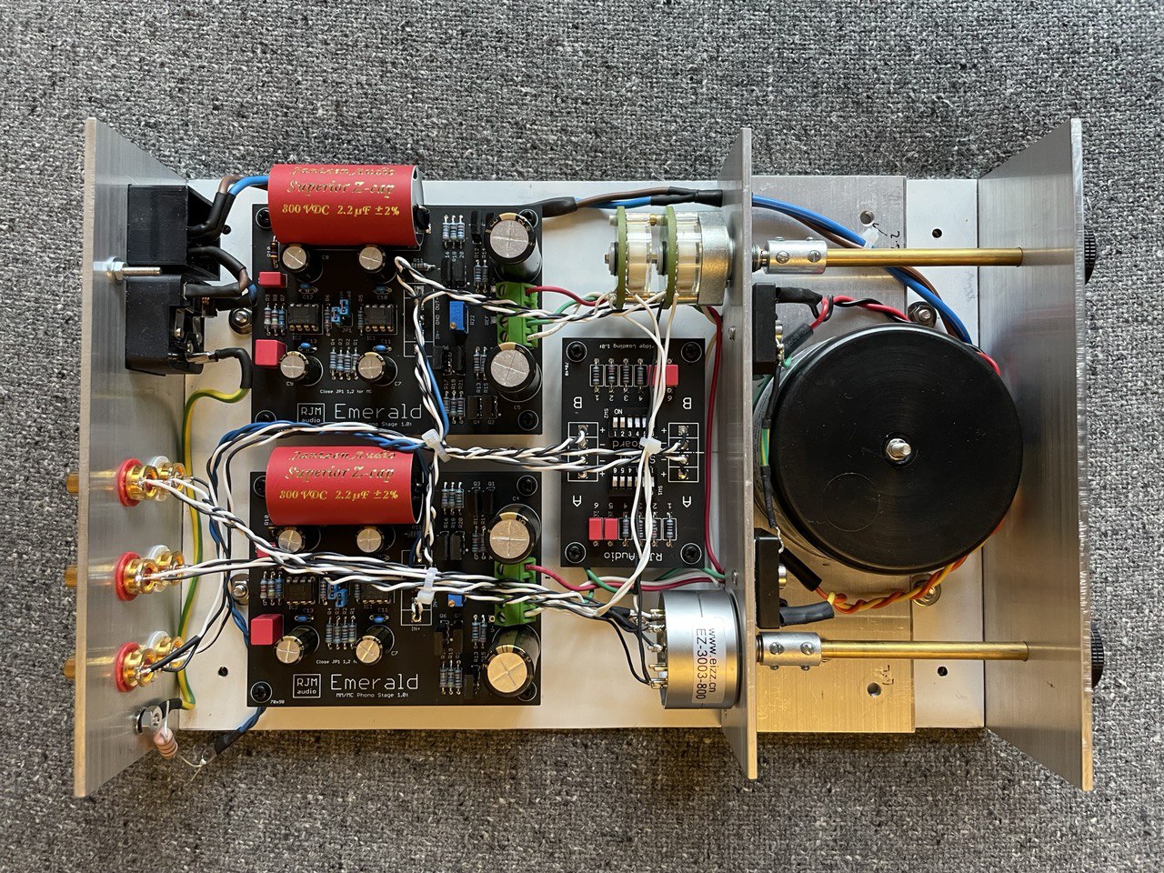

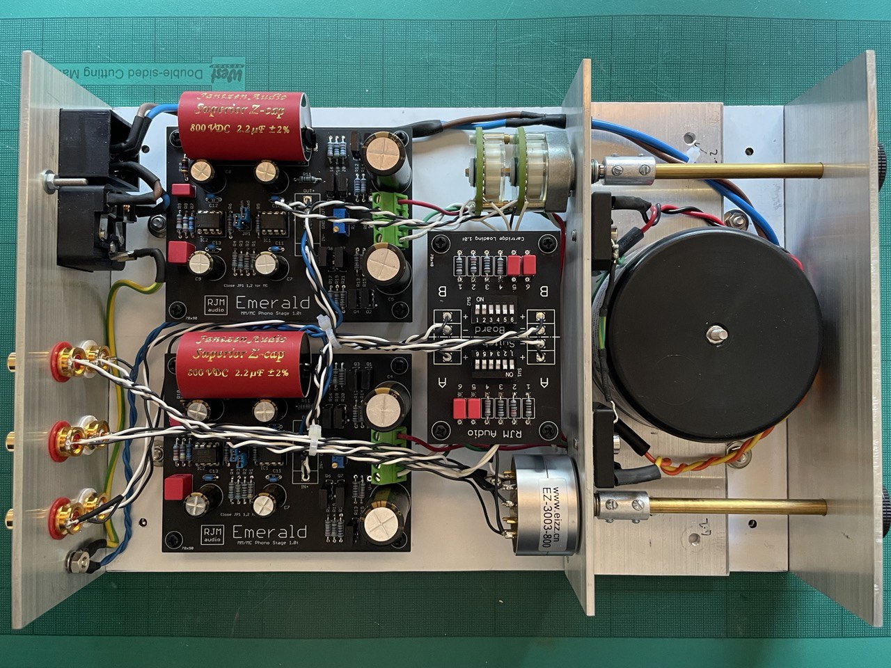

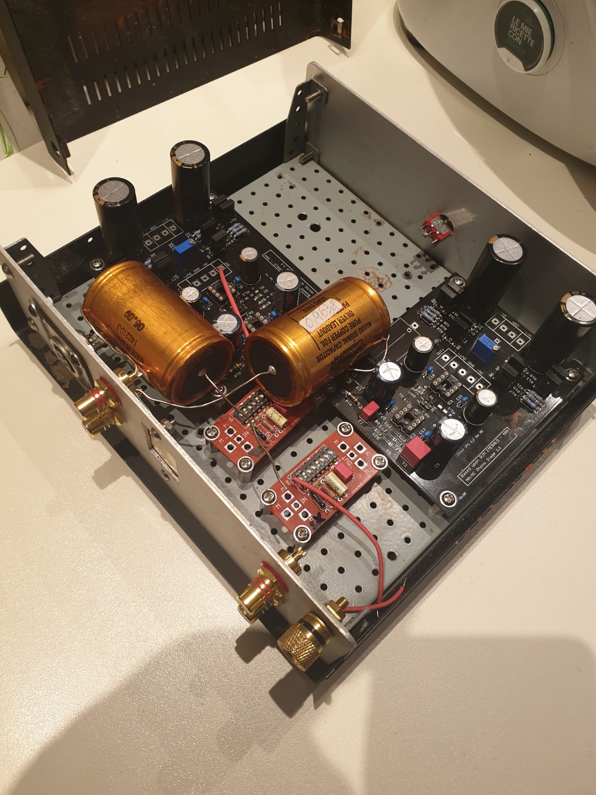

Just finished another Emerald build, full dual mono psu, one box build. She's sounding very good. There's a little bit of roar audible with the needle up at my usual playback volume on my pre, but only audible 12 inches away from my speakers.
I reckon that's about -70db, which is very decent for a one box build, no hum at all.

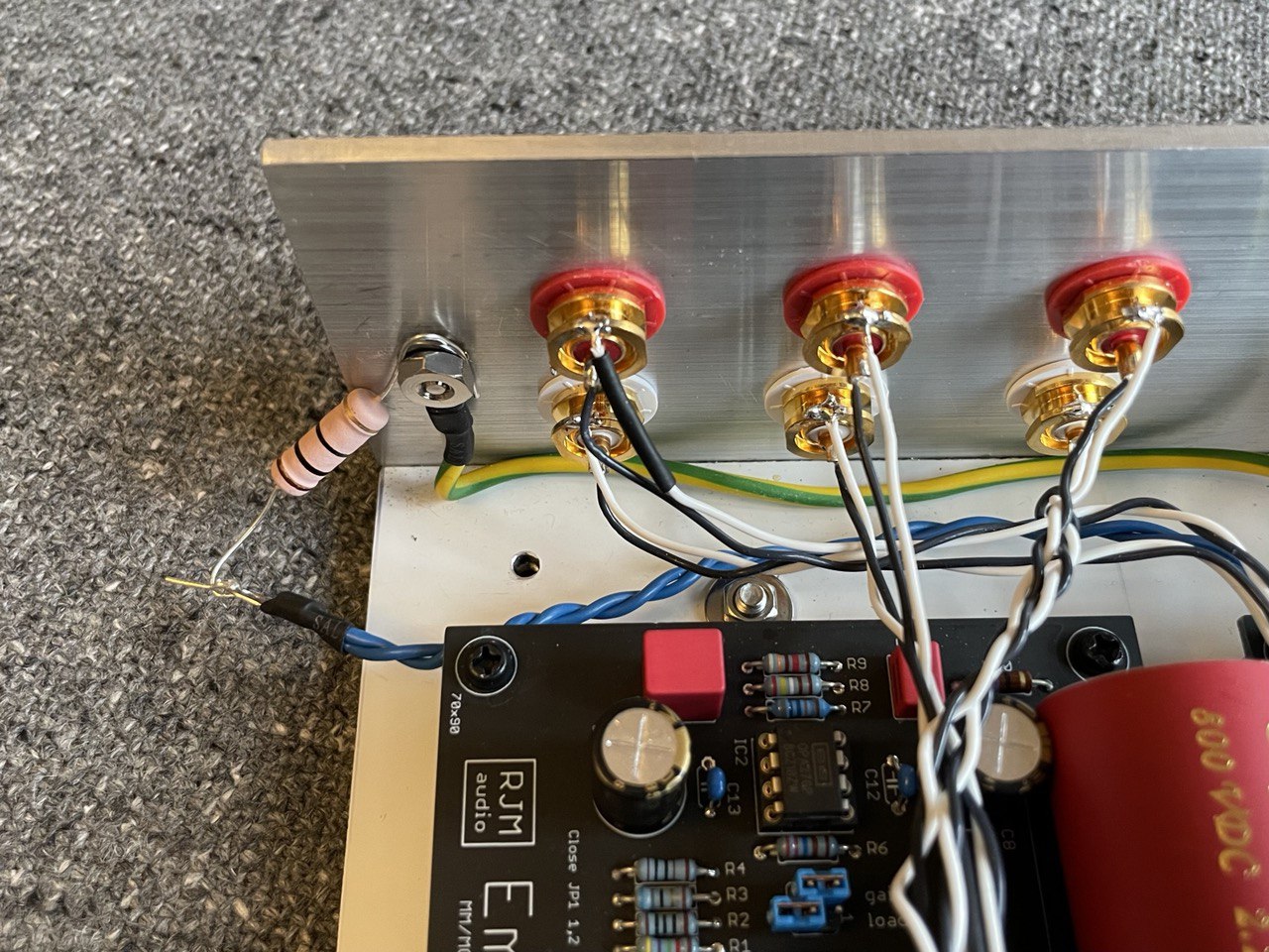

Hi all, back again as I decided to try the 10ohm resistor ground lift trick mentioned by Nikos (post 606) and suggested by Richard. Since I last posted, I've rejigged the layout of the rectifiers (which helped the hum a lot), and fitted the chunky Jantzen's, which was like going from 720p to 1080p The hum is only really audible when I get up close to the speakers and have the output at about just over my normal listening level or above. Anyway, thought it was worth a shot.
So I quickly tried soldering a single 10ohm (5W) resistor to the GND wires which are already twisted and soldered together. It doesn't seem to make a noticeable difference. Do I need to spit the individual GND wires and solder a 10ohm resistor to each, then clamp to the Earth screw?
Hi Jag, Here are some solutions that you can try to eliminate the hum issue.Hi all, back again as I decided to try the 10ohm resistor ground lift trick mentioned by Nikos (post 606) and suggested by Richard. Since I last posted, I've rejigged the layout of the rectifiers (which helped the hum a lot), and fitted the chunky Jantzen's, which was like going from 720p to 1080p The hum is only really audible when I get up close to the speakers and have the output at about just over my normal listening level or above. Anyway, thought it was worth a shot.
Gave it a go with some bigger stand-offs, so there's now about 30mm between them. Doesn't seem to make a difference, but at least access to the Switchboard is improvedCan you lift the switch board off the floor at all, to put more distance between the wires from the diodes.
What sort of diodes and capacitor would be required for the DDRC you mentioned previously @sq225917 ? And where exactly should I be sticking it? Given the 10ohm resistor above didn't seem to make a difference on its own, would that suggest the DDRC would be ineffective or are the diodes the critical missing piece(s)?
I'm leaning towards coupling being the source of the hum rather than a ground loop. Ground loops are easily checked - just temporarily disconnect the AC ground from the chassis. If that solves the hum, then you need to think about things like the 10 ohm resistor or other ground lift tricks. .. if there's no change then the problem is most likely the close proximity of the diodes, transformer, and AC wires to the phono amplifier circuits and, in particular, the coupling caps which make great antennas for picking up that kind of interference. Remember to evaluate hum with a dummy cartridge load on the input to rule out upstream problems.
