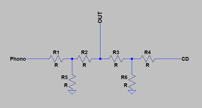

Do you mind elaborating a bit? The reason I thought of the above was simplicity.
I really do not need all those switches. Only a 2 way source selector and a volume pot, both of which I am thinking of implementing with LDRs, so no clicking or scratching from them.
Something like that
attachment.php
When phono is on, R1 and R5 act as the attenuator, while R2 is ~30R.
At the same time R3 and R4 are ~50M while R6 is ~30R.
When CD is on, R4 and R6 act as the attenuator, while R3 is ~30R.
At the same timeR1 and R2 are ~50M while R5 is ~30R.
And on mute, all series resistors are ~50M, and Shunt ones ~30R.

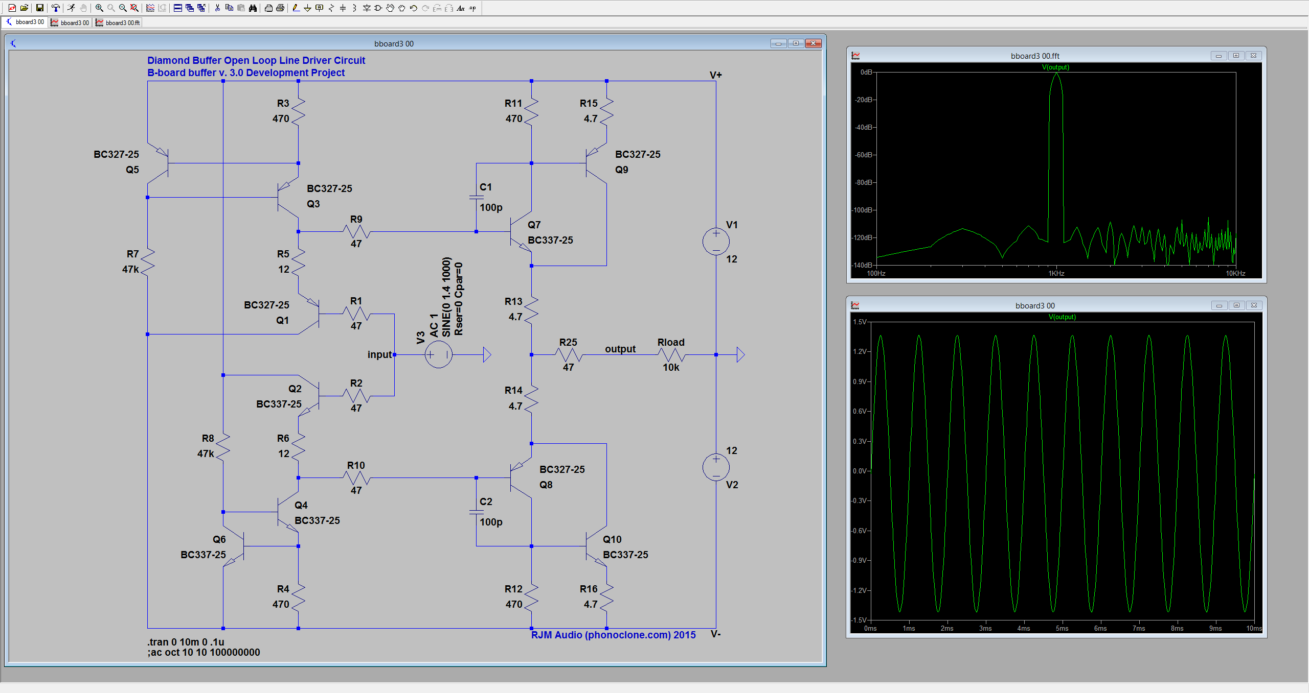

B-board 3.0
In line with the last revision, the bboard will (hopefully) be updated to feature the improvements first developed for the Sapphire headphone amplifier.
Briefly, the changes pretty much copy the new Sapphire directly:
* active constant current sources replacing the emitter resistors
* Szilkai output
* BC337/BC327 transistors and 1/4W resistors
The parallel output transistors will be removed and the bias currents scaled down (optionally, they can be increased if you need to drive very low impedance loads). I'll include an input resistor this time... it makes it simpler.
My main concern is the layout and whether I can make the same compact board layout as before. One option is to remove the Z-reg section and feed the board from a regulated supply such as the V+/V- pads on the phonoclone board or an X-reg board.

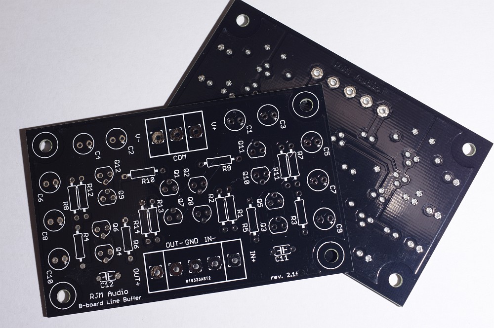

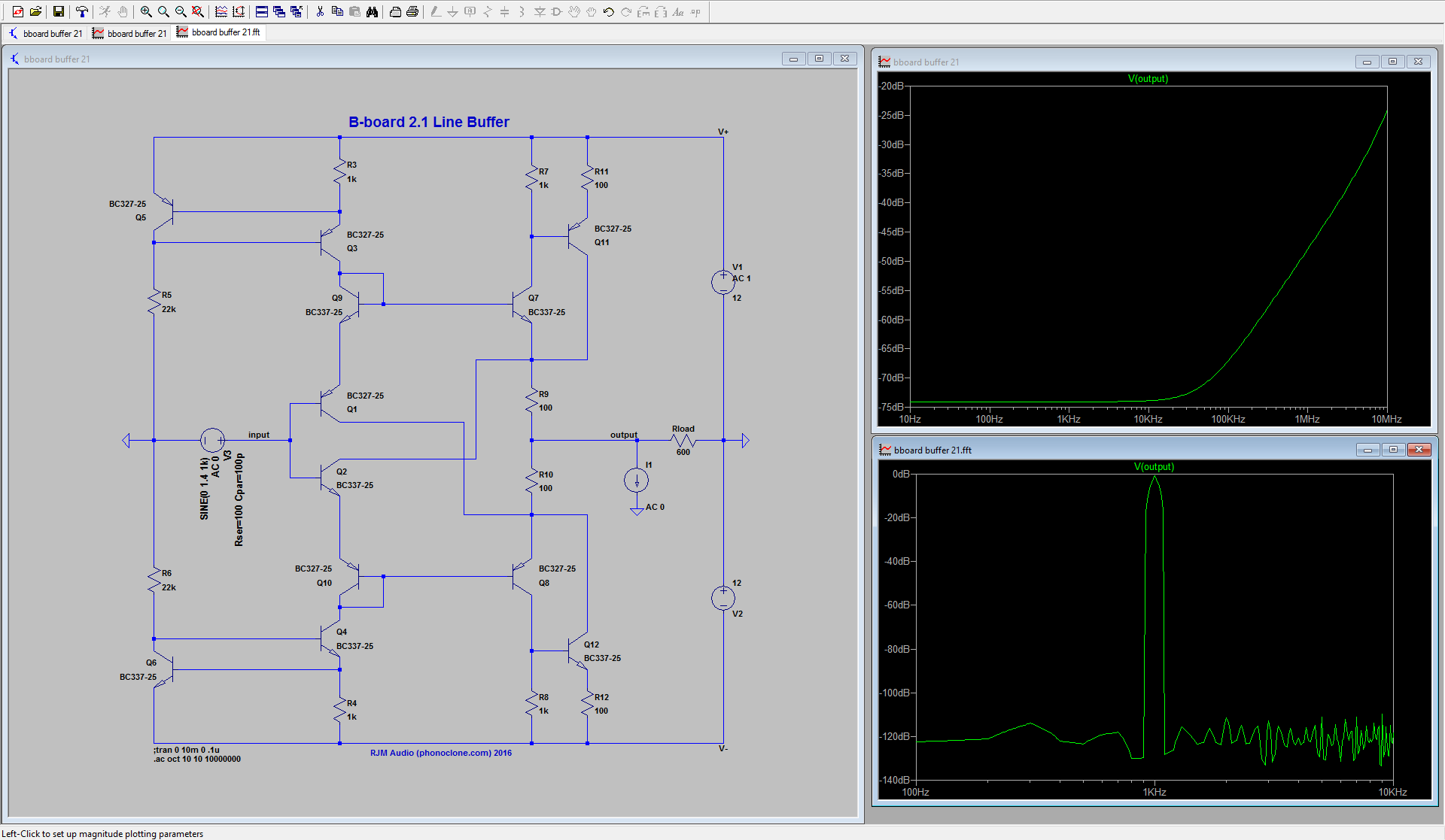

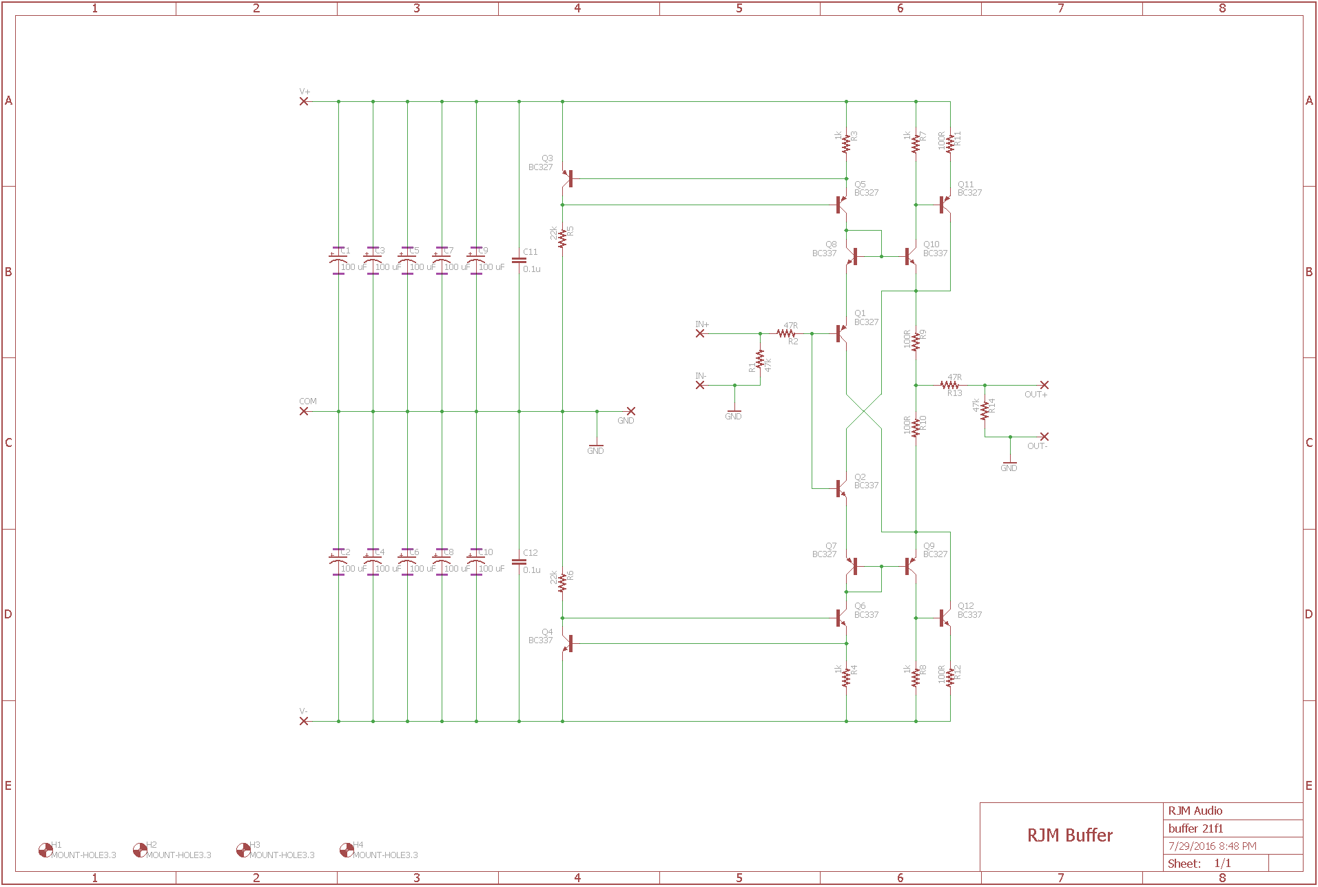

Well that's embarrassing.
Coming back to this thread I find my latest version has a smaller revision number than the last version I posted here. Oops.
This is revision "2.1f1". It's a derivative of 3.0 above, I guess, actually simplified and downscaled a little with no loss in performance. The boards are just the buffer circuit with no regulation. You can power it however you like, with split supplies from 5 to 18 V. Current draw is ~<10 mA.
