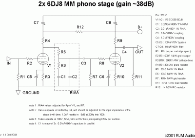

RJM Audio is me. The design of this phono stage is my own, in the sense that I worked out and simulated the RIAA values for the circuit, the operating points for the tubes etc. The "two triodes, passive filter, no feedback" phono circuit is generic and goes way back.
Has anyone built and listened critically to this circuit? Is it worthwile and has anyone improved its performance with CCS etc?

I found this thread searching for info because I want to build your phono stage .I bought a pcb from stereo 24 in poland but I want to know if I can use these values of the components mentioned on this schematic but for 6N1P tubes? Can you advice?
The 6N1P is not the same as a 6DJ8 or ECC88.
6N1P has similar gain to a 6DJ8, but its anode resistance is higher and its transconductance is lower.
You could build that circuit using 6N1P tubes using the same parts values and it would most likely 'work'. The EQ might be a bit off, though.
You would need to tweak the circuit to get the correct RIAA EQ and best performance out of those 6N1P triodes.

Can you advice on these tweaks?
I haven't looked closely at this circuit, but you would probably need to adjust the values of the anode resistors (R4, R9) and cathode resistors (R3, R10) to bias the tubes, and also adjust the value of R5 (and possibly C2) to correct the response of the RIAA EQ filter for the higher internal anode resistance of the 6N1P.

It would be easier to get a pair of ECC88 / E88CC

Yes it is obvious, nothing else to change?? any suggestion for the capacitors ?
regarding the caps I chose these

All OK, as I see it. I take it that you are getting the 30 nF caps by using three caps with value 10 nF in parallel?
Looking forward to your report on the finished product.
