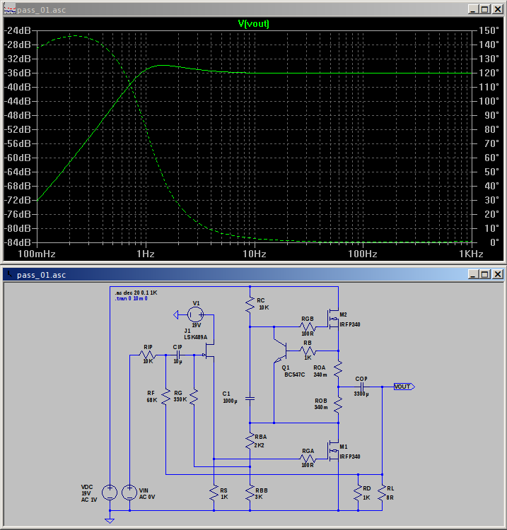

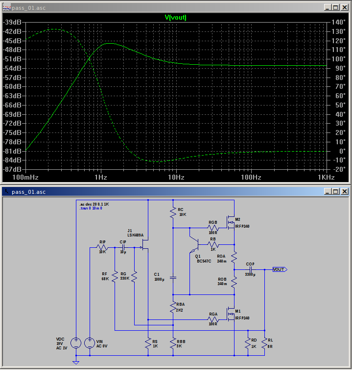

I ran that ltspice circuit but changed it to have a 19VDC supply with a 120Hz@100mVRMS signal superimposed on it and no signal on the input, then looked at the FFT of the output.
The 120Hz component was 72dB down, or around 23uVRMS. So 100mV/23uV is a reduction of roughly 4347 times.

In the stone-age, raw 120Hz ripple power, amp designers started with plans that promised good PSRR.
Car-sound, not so much (no 60Hz; and 50 pounds lead sucking alternator ripple).

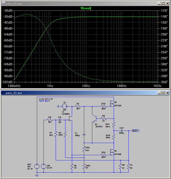

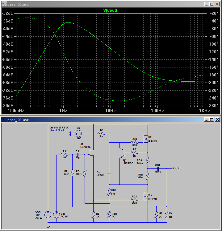

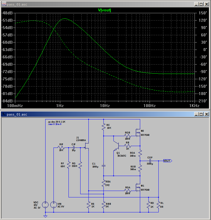

AmpCamp *starts* with a regulated (switch-mode) power source. This freed NP to consider other plans with not-so-much PSRR. This one came out pretty good. MB's sequence-study of mods show you can find much worse, but 72dB is about what you get with NP's values. Which is really VERY good for such a simple amplifier. Comparable to an older voltage regulator.
So you gotta ask: is "linear power!!" really *better* for an amplifier *designed* for regulated power? (And promoted as a low-cost high-fun project?) Are we lipsticking a pig? A very pretty fair-winning piglet, but is lipstick an improvement?
The last amps I built I used a rule of thumb of output ripple 90dB below rated output and am happy that I did (one SS and one valve for bi-amping, appropriately sized for the speaker so they work together). This is after working its way through the amp so the ripple at the supply could be higher. I was careful to make simple (sinusoidal) ripple the only measurable (with my scope) noise from the supplies.
Had a few spare minutes to run a simulation on an amp I'm designing... with 1Vrms/120Hz (0dB) on each supply rail, 120Hz on the output was -127dB. I don't know how that ranks against other designs, but it seems like that should be enough that I don't have to go to great lengths to filter the supply.
