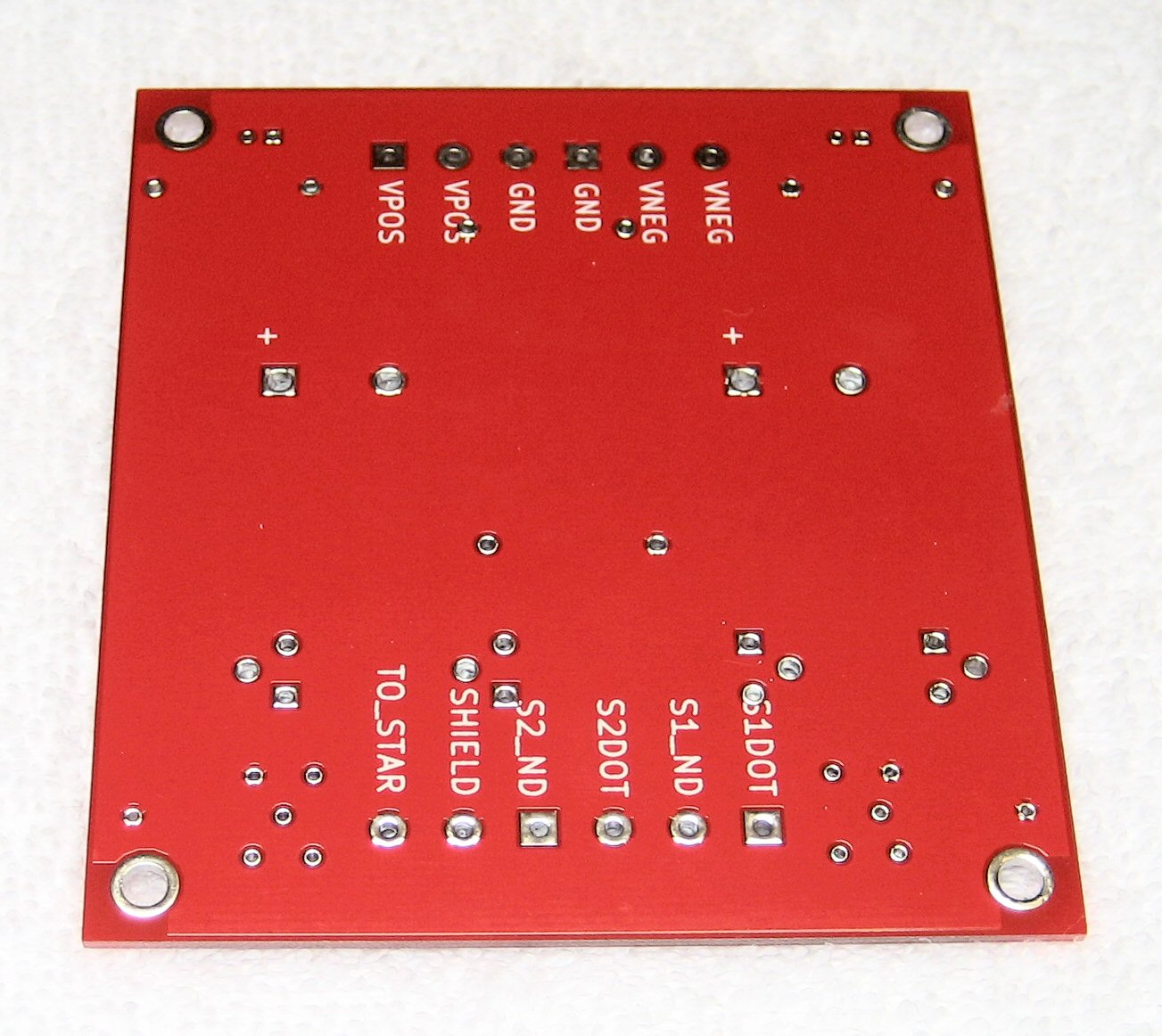

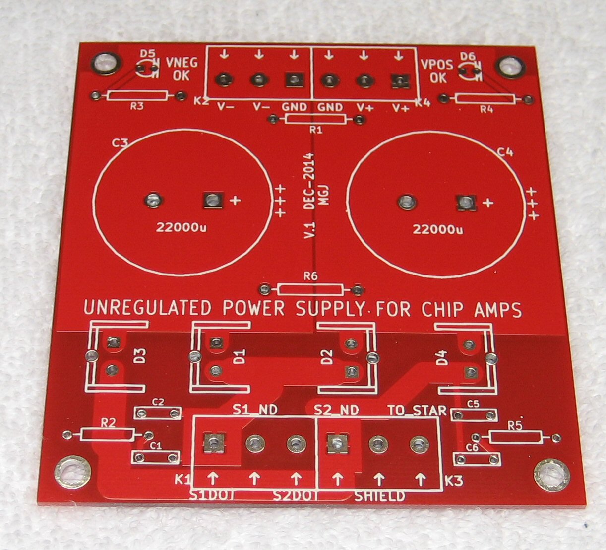

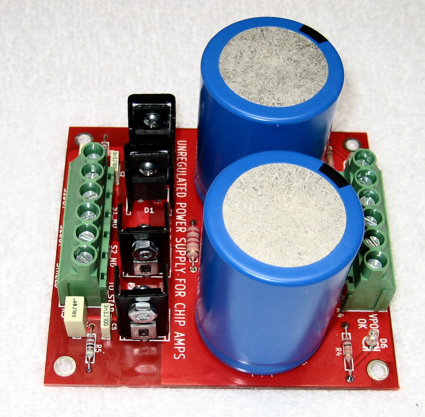

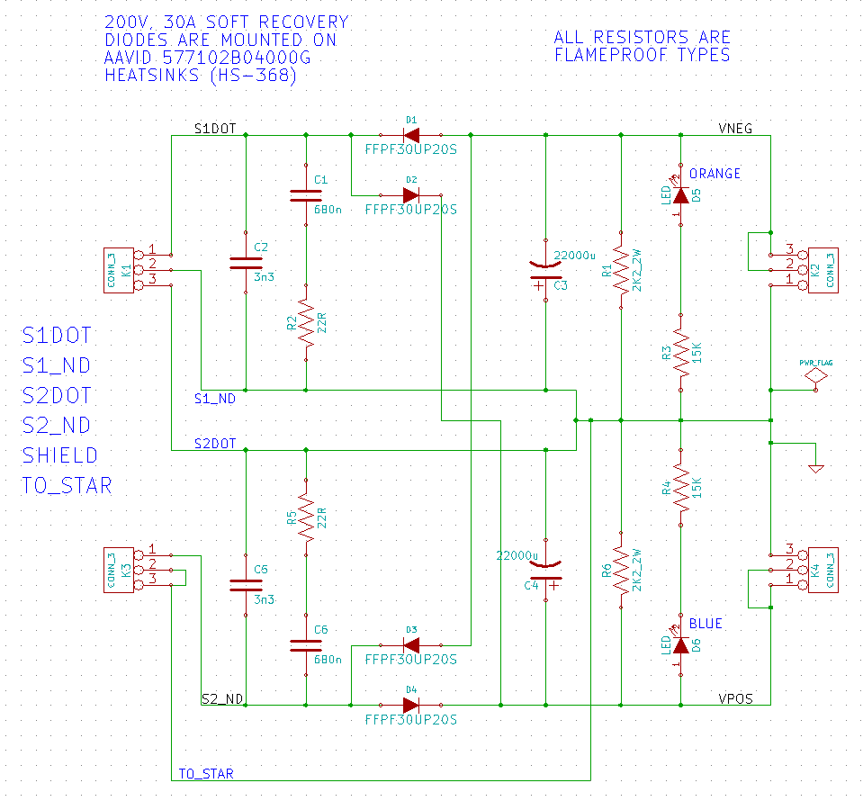

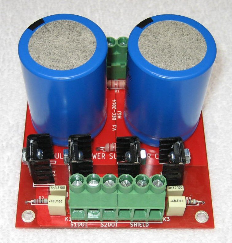

This is a power supply PCB which provides dual voltage outputs (± 28V) to power chip amps. It can power two LM3886 amplifiers, each amp operating at its maximum output power (68W @ 4 ohms, or 38W @ 8 ohms). It is suitable for either a two-channel stereo pair, or a single-channel pair of LM3886 amplifier chips operating in bridged mode. The PCB is designed and optimized for the Antek transformers AS-2222 (shielded) and AN-2222 (unshielded).
The board features both Soft Recovery diodes (30A, 200V) and full CRC snubbers, to completely eliminate oscillatory ringing in the power transformer secondaries. Conventional PSU designs, using standard silicon rectifier bridges and single capacitor "snubbers", produce unwelcome ringing in the secondaries. This is shown in the first two pictures below.

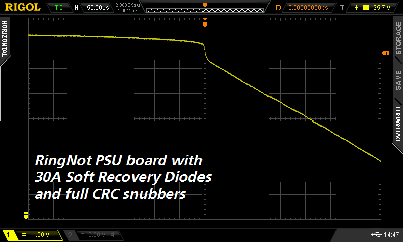

Photo 1 shows an Antek AS-2222 transformer driving a conventional PSU which uses a 25 A bridge rectifier (GBU2510) with single 100nF capacitors (acting as lousy snubbers) across each secondary. This arrangement stimulates oscillatory ringing in the secondary when the rectifiers switch off.
Photo 2 shows the same transformer, driving a RingNot PSU board. Oscillatory ringing has been completely eliminated, thanks to Soft Recovery diodes and full CRC snubbers across each secondary.
I am placing the RingNot design into the public domain; its complete schematic is shown below, and a .zip archive of the Gerber files for PCB manufacturing is attached. Anyone who so desires can download the Gerbers for free, and send them off to a PCB fab to have boards made. Bills Of Materials for DigiKey, Mouser, and Element14 are contained in the attached Builder's Guide .pdf document. The Builder's Guide contains a very detailed set of step by step instructions for stuffing and soldering the board.

THERMAL COMPARISON
The Aavid 5301 heatsink, which mounts all four diodes of the GBU bridge rectifier in the conventional PSU, has a quoted thermal resistance of 6.30 K/W. (link 1)
The Aavid 5771 heatsinks used in the RingNot power supply, mount only a single diode. They have a quoted thermal resistance of 25.90 K/W. (link 2), a factor of 4.1 greater. Fortunately they have a factor of 4 less heat input (one diode instead of four diodes), so we expect them to rise to approximately the same final temperature as the larger heatsink with full bridge.
I connected the conventional PSU to a two channel electronic load. The PSU's +28V output was connected to a load current of 4.0 amperes, and the -28V output was connected to a load current of 4.0 amperes. These represent a guardband beyond worst case load, since the transformer is only rated for 200 Volt-Amperes. The heatsink temperature was measured with a Type-K thermocouple (a) before the load was connected; (b) after 1 hour of operation with two 4.0 ampere loads. Temperature rise was 51.7 Kelvin.
Then I connected the RingNot PSU to the electronic load. +28V was connected to a load current of 4.0 amperes, -28V was connected to a load current of 4.0 amperes. Measuring the heatsink using the same thermocouple before and after one hour of operation, the temperature rise was 53.3 Kelvin. This measured result agrees with intuition: (1/4th) the power at (4X) thethermal resistance, gives the same final temperature.
The individual diodes on individual heatsinks, heated up to a final temperature approximately equal to the final temperature of the bridge rectifier on a single large heatsink. Just as the calculations predicted.

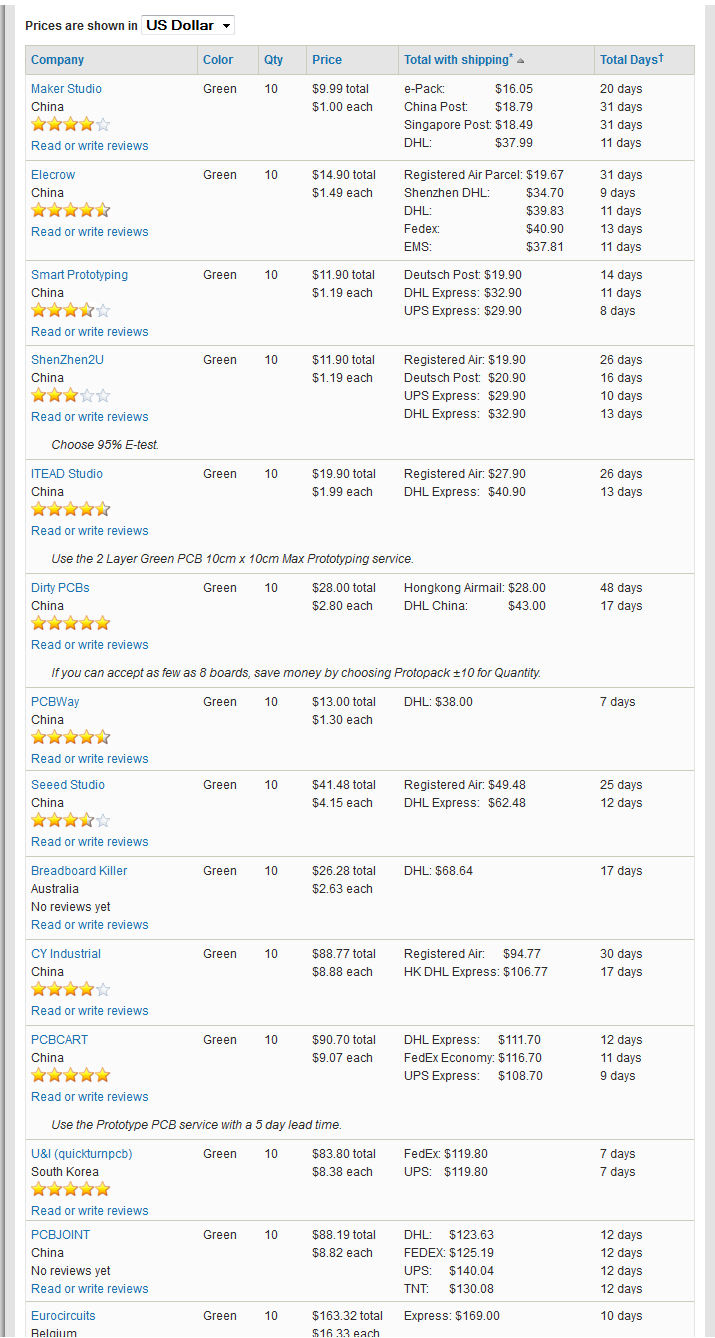

If you decide to send the RingNot Gerber files out to a PCB fab, I enthusiastically recommend that you visit the website pcbshopper dot com (link) to get a general idea of pricing. Tell the quote generator
If you're in the US, I think you will be very pleased with the speed of your order if you happen to choose Elecrow for the fab and Shenzhen-DHL for the shipping. Here's an example. I had some RingNot PCBoards made there, and total delay from order to PCBs in my hands in the US, was six days. (!) That's very fast, faster than many domestic shops who charge a lot more. (link here on diyAudio)

Secondary ringing effect
Is the ringing in the secondaries mostly just bad form, potential cause of EMI, slight potential noise back on the mains, and somewhat "rough" on the transformer? Shouldn't actually get through the capacitor bank nor to the circuit (amp), unless it's through EMI, right?
The ringing is caused by the parasitics of the transformer + rectifier circuit. The parasitic inductance of the transformer windings and routing set up a resonant circuit with the stray capacitance of the circuit. When the current in this resonant circuit is interrupted, as when the diodes turn off, the energy left in the resonant circuit will cause it to ring until the energy has been dissipated in the parasitic resistance of the circuit. The ringing tends to be in the 100s of kHz to low MHz range - so well outside the audio band.
The ringing itself is not really an issue. However, in some amplifiers, the ringing may couple into sensitive parts of the circuit where it can be demodulated and cause a DC offset shift. This means every time the diodes turn off, so at twice the mains frequency, there'd be an impulse injected into the circuit. The result would be an increase in the 100/120 Hz mains harmonic.
The frequency of the ringing is rather low, hence, the coupling tends to be rather small in most circuits. I strongly suspect the amount of coupling is heavily dependent on the layout of both the supply and the amplifier as well as the wiring between the two.
There are several ways to address this ringing. One can add a small capacitor (100 nF is usually a good starting point) across each secondary winding. This lowers the frequency of the ringing and effectively suppresses any coupling into the amplifier. Another approach is to design a snubber, such as the one in Mark's circuit. As shown in the scope shots, a snubber, when designed well, works very well in suppressing the ringing.
"When designed well" is the key. The way to design the snubber circuit is to first measure the parasitics of the transformer+rectifier circuit. That's fairly straight-forward to do experimentally. Once the parasitics are determined, the snubber resistor is calculated to set the Q of the parasitic resonant circuit to about 1. This app note from CDE describes optimum snubber design well: http://www.cde.com/resources/catalogs/igbtAPPguide.pdf
The point is that the snubber design will depend on the transformer chosen, which, I'm guessing, is why the RingNot design doc lists the Antek AN-2222/AS-2222 as the only approved mains transformer(s).

Ringing frequency is (1/(2pi))*sqrt(1/LC) and can be rather high ... I've seen ringing at 3 MHz which is higher than top end of the AM radio band ... when L and C are both small, as they are on a toroidal transformer with a high current 6.3V secondary. Adding an external C in parallel with the secondary, reduces the ringing frequency. Picture 1 of post 1 in this thread, shows the effect of Cexternal=0.1uF upon a 200VA toroid with 22V secondary. Ringing frequency has been decreased to approx 90 kHz. (~ 4.5 cycles in 50 usec).
Snubber design is now very well understood at diyAudio and can be accomplished quickly using only a signal generator, resistor, and oscilloscope. "Quasimodo ExtraLight" (here in QM post #561) shows how. The great thing is, you don't need to measure the number of microhenries of inductance of your transformer, and you don't need to plug that number into a math formula. All you need is the transformer itself plus the gear mentioned above. Those who don't own and don't want to own a signal generator, can build up a little test jig called Quasimodo (search for it) or else a CheapoModo (search for it), to use with a scope, and accomplish the same result: Simple, No-Math Transformer Snubber. You can get an optimum snubber without ever knowing the values of the parasitic L or the parasitic C. Many, many diyAudio members have already done so, and posted their quite excellent results, here on the site.
I myself advocate setting the "Q" of the resonant circuit to 0.5, which corresponds to a damping ratio "zeta" of 1.0. (the relation is zeta=0.5/Q). And zeta=1.0 is what I recommend to beginners, in the Quasimodo design note. Why? Because I think zeta=1.0 gives the widest margin-of-safety of all possible target values. If well-meaning newbies make experimental mistakes which result in ±40% errors, zeta=0.6 and zeta=1.4 are relatively harmless results. However when you put a ±40% error bands around other targets, the endpoints become a lot less forgiving. Cornell Dubilier's suggested value for high frequency switchmode power supplies (Q=1, zeta=0.5) results in zeta=0.3 at the low end when error= -40%. This is way too underdamped and way too much overshoot for my taste, especially when we consider that this application is a leisurely 120Hz fullwave rectifier and not a 100kHz SMPS. There's no reason to fear overdamping; 90kHz to 3MHz overdamped sinewaves will settle out long before the 8.3 millisecond mains halfcycle is over.
Tom's half right - the snubber on the RingNot board was designed to be a "Universal Snubber" for all toroidal transformers with approx 200VA rating and approx 2x22VAC secondaries. However I calculated its component values before I ever touched or measured an Antek AN-2222 or AS-2222. (here's the link) Later, when I did lay hands upon an Antek 200VA 2x22VAC toroid, I verified that the Universal Snubber (on RingNot) did work extremely well, just as predicted. The other reason I don't recommend using RingNot with any other transformer is: my own resources. I decided I simply don't have the bandwidth to support any and every random transformer somebody might want to connect to a RingNot. Sure, it will probably work fine, and if the person really knows what they're doing, it probably will work flawlessly. But that's not a configuration I support. Besides, the Antek transformers are extremely well built (compare their leakage inductance to everybody else's; Antek kicks butt!). And they are very robust, with large margins of safety. And, at least for US customers paying US shipping, they're cheap. Thank you Nelson Pass for introducing me to Antek transformers.
Since RingNot is in the public domain, anybody can send it off to fab and get 10 boards for $37.00 or (as in post 2 above) 20 boards for $54 with only six day turn-around(!!). They can do this long, LONG after I've successfully gotten rid of my own meager pile of extra boards. Years later, I suppose.

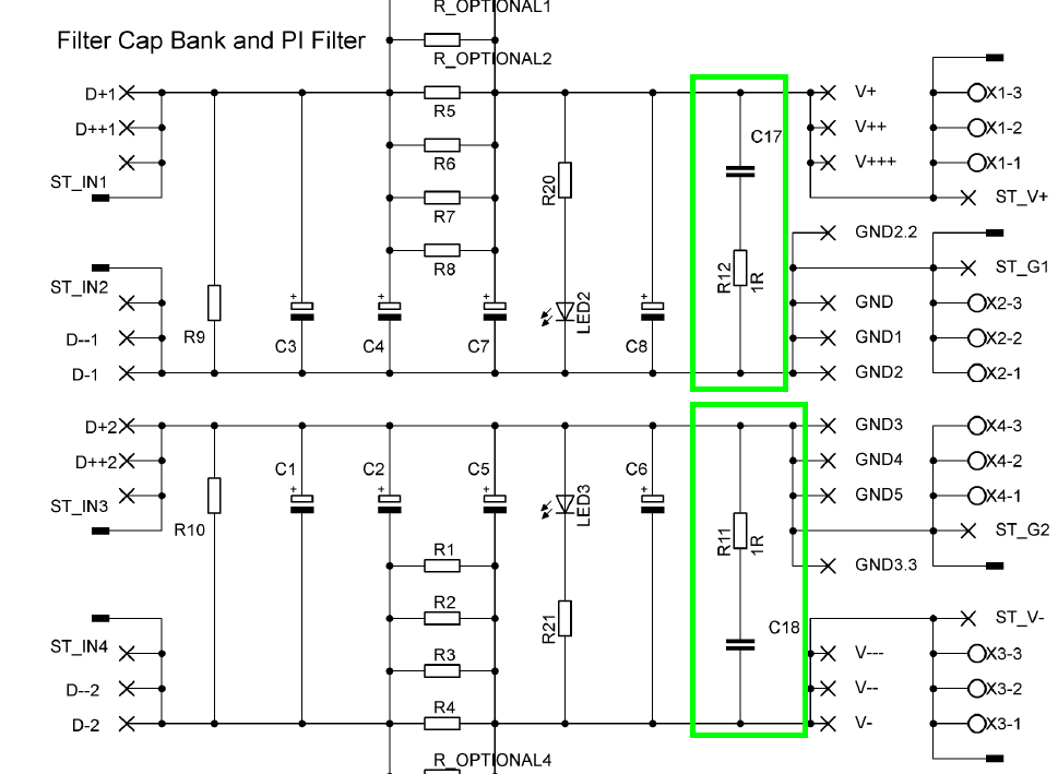

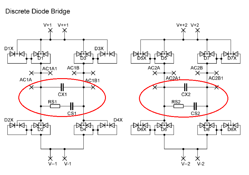

Yes, I agree. In fact if you study the schematic of the diyAudio Universal PSU V3, you will find that it includes a total of four snubbers; schematics below.So, comparing this RingNot to the diyAudio PSU v3.x, I guess the diyAudio PSU v3.x also has PCB circuits for the CRC snubbers and could be used like the RingNot if one were to use soft Recovery Diodes and the same CRC circuit? In which case the main pros of the diyAudio PSU being some additional flexibility, and 2 extra capacitor slots on the PCB...
The circuits in the red circles are CRC snubbers directly across the transformer secondaries (identical to RingNot); their component values can be designed either using the Hagerman_with_math procedure, or the Quasimodo_no_math procedure. The circuits in the green rectangles are RC snubbers directly across the final output of the PSU. The official Bill Of Materials calls them "Output Snubbers" and recommends fixed, constant component values which do not change when different transformers are used. If you've put inductive, wirewound resistors on the board; or if you install explicit inductors to make CLC filters instead of CRC filters; these Output Snubbers may be beneficial.

Following the advice of post #2 above, I got PCB fab pricing quotes (good for today only) for ten RingNot PCBoards. They are sorted by price with the lowest price at the top.
Today, you can get ten RingNot PCBs shipped to your address in the USA, for as little as $16.05. Fast shipping costs a little more; I personally have had spectacularly good results with Shenzhen DHL, receiving finished boards six days after I ordered them (link) .
Ten boards for $34.90, versus one board for $50.00? Easy decision.
