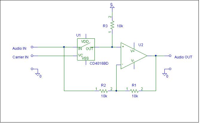

the "polarity switcher" is exactly what i was talking about. with a logic 0 on the control input the circuit is noninverting, with a 1 it is inverting. with an audio frequency square wave it is a simple ring modulator. the difference between this and the vader voice is that the waveform is not chopped on and off, but switched between inverting and noninverting, a more subtle, but still very audible effect.
It won't even be difficult to make a thingy that can be switched between both modes.
Below you can see how it can be done. The positions of U1 and R3 can be interchanged theoretically. But I would leave it where it is because the analog switch doesn't make a perfect short.
This circuit can be changed to "chopper mode" simply by inserting a toggle switch that allows the pin 1 of R2 to be switched between input and ground (ground = chopper, input = ringmod).
Regards
Charles
the on resistance of a 4066 is only about 50 ohms. compared to the 10k resistors being used, that's close enough to 0 ohms to work in either position. there's another circuit that uses the op amp as a diff amp, and switches the signal between inverting and noninverting inputs. that one might also be useful as a true 4 quadrant multiplier type ring mod if the 4066 were replaced with jfets and driven with a sine wave carrier source, since that would not only give sign reversal, but amplitude multiplication as well.

I think I understand the principal that phase_accurate was making about the 4066. I assumed the square wave was still a carrier, but now I think I understand it is used to switch something over in the 4066, giving a sound something akin to a modulator. I'll have to assume that the Vader Voice doesn't do this, which explains why it doesn't produce the right sound.

the vader effect actually turns the audio on and off at a very high rate of speed. the dalek sound switches the phase of the signal from 0 degrees (noninverting) to 180 degrees (inverting) at a high rate of speed. there is still audio present at all times. using a 4066 to switch an op amp between inverting and noninverting would be the same effect as driving the Y input of the MC1496 with a square wave carrier.
