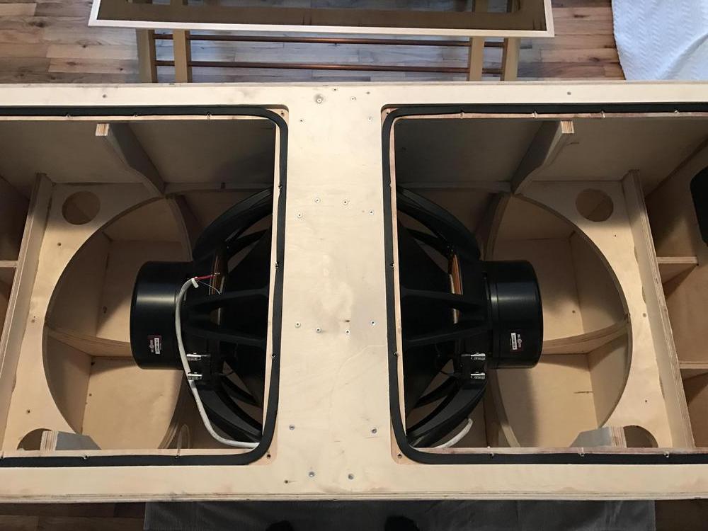

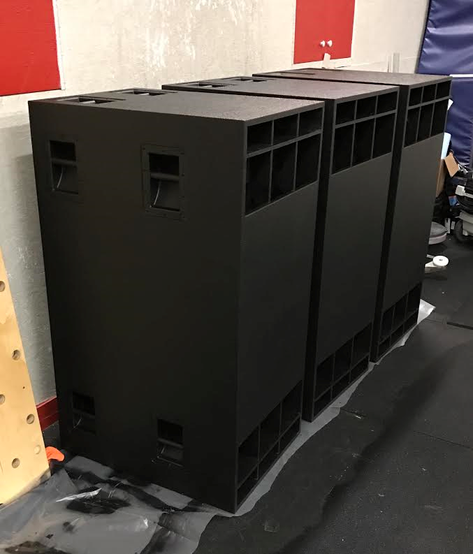

The Skhorn is a 24x32x54" cab that is comparable in size to the low tuned dual 18 vented cabs on the market. It's 24cu ft or 680L external volume. Originally I wanted to keep the size the same as the Othorn which is 18cu ft external but using 2 large drivers simply required a bit more volume and a different shape. The Skhorn is exactly 33.33% bigger than the Othorn, so 3 Skhorn are the same volume of space as 4 Othorn cabs.
I settled on a quasi 6th order BP, where the low end is vented and the upper end of the loading is a short, expanding slot/horn, with an opposed pair of 15-21" drivers, in an OD arrangement. I ended up at this while trying to work on translating a standard 6th order sim into wood and screws. I was having trouble getting the upper bass vents to fit into the cabinet and this caused me to look at how a straight slot performed instead since it is MUCH simpler to fit into the cab design. From there it was natural to model the slot with both a positive and negative taper and see what happened. A positive flare seemed to offer some improvements over a simple vent and with tweaking of the length, area and expansion, I found that this type of loading for the drivers could produce a smooth response over a wide bandwidth while also exhibiting some gains over a standard vented system using the same driver.

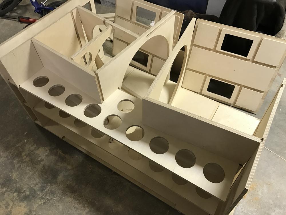

Here’s the cab design.

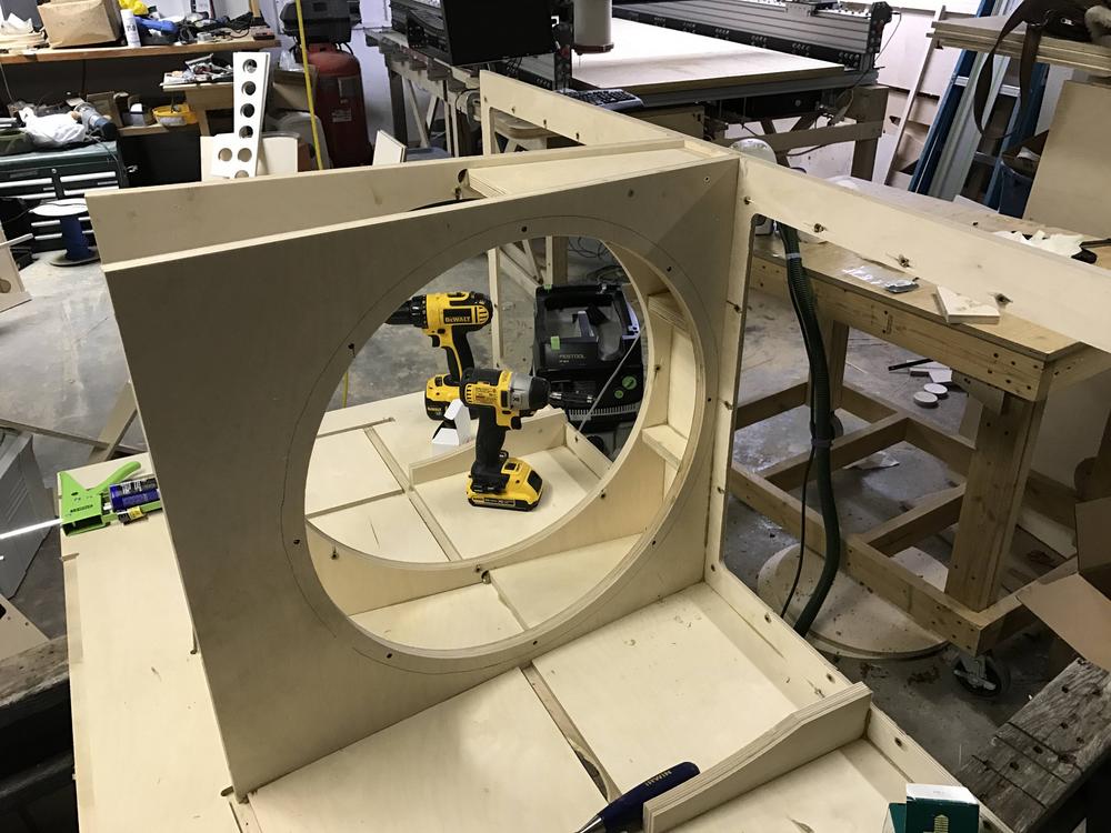

About the handle placement...The way the cab is internally things are a bit tight. I placed the handles where I would like them to be and they would fit. It will be fine for me. I have a lot of experience moving cabs that are large and heavy and these will be no problem for me. You shouldn't be using handles on subs like this to deadlift and carry them long distances. They are there for pushing, pulling, turning, flipping, tilting etc. if the cab must be physically carried by 2 people the handles on the ends will allow this easily. Estimated weight is around 240lbs with a pair of 40lb drivers and I think that may be over estimated a bit. I'll have to measure one. I always use dollies or other sets of wheels for moving things like this though and I'd assume most others do as well. Who is dead-lifting and carrying their subs around? None of the people I work with certainly. Handle type, placement, skid plates or corner wheels could be added to taste. I won't have any trouble tilting these up and on to a dolly and getting them into a van or truck by myself.

I did do plenty of simulating with FLH's and also TH, BLH, scoops, BP4, BP6, BP8, vented, etc...You name it and I probably spent a good deal of time simulating what could be done within the defined parameters. This appeared to offer the best set of compromises and potentially the highest performance from a cab of this size with the amount of extension needed. I always have very specific goals for the size and extension of my cabs. FLH just never seems to be the best option for my goals. It either does not extend low enough, needs to be too large, doesn't offer enough headroom potential, or the folding becomes problematic and too complicated.
As far as sound quality goes that is yet to be determined but I am quite confident these are going to be far from what people think of as a BP sound. I've also heard many, many BP cabs both 4th and 6th order that sounded bad. Some of the first subs I heard were absolutely horrible car audio BP's back when I was a teen. One note output and overhang for days. I've also heard just about every other type of cabinet at one point or another as well and I've heard bad examples and good examples of all of those as well. TH's for example can sound excellent but a great many of them sound extremely colored to me due to the spike near the 5th harmonic and the rough response above that point. Those typically ring like hell too. It can be damped and controlled somewhat through good design but often isn't. They sound extremely good over a narrow range below the typical response spike but that's a quite limited bandwidth. Some of the TH's I've heard had serious issues covering the full bass bandwidth if they were tuned too low. The best sounding TH's I've heard are the DSL TH115-118 and the Othorn. The gulf in coloration between these and some of the worst TH's I've heard is huge. Those TH's are pretty well damped and the nastiness in the response are pushed up above the low pass filter region which helps immensely. I've also heard some bad FLH's with ragged response shapes, ringing and colorations so I don't buy into them automatically either. Some of them are very good though. It really comes down to the particular design with any type of cabinet. There are bad and good examples of each. There's certainly nothing in the simulations that says these will sound bad or one note compared to any of the other designs typically used for pro audio. I'll be GP testing these extensively this summer and also doing a lot of listening so that will tell the final story.

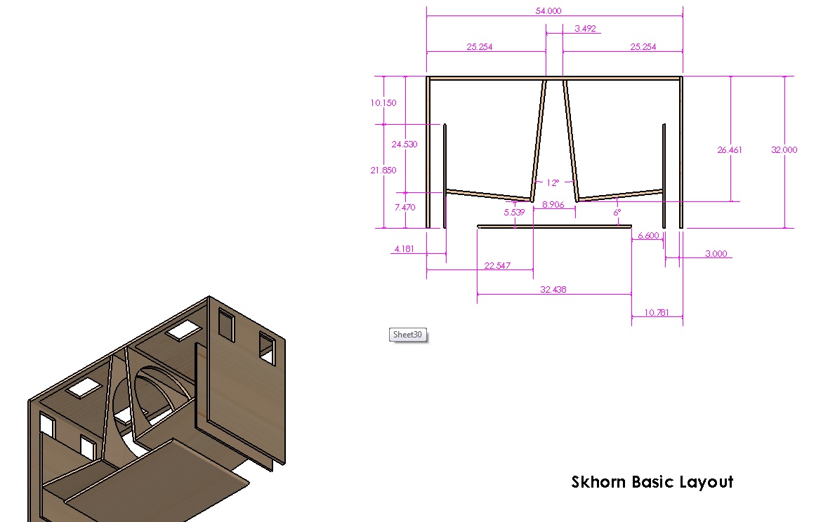

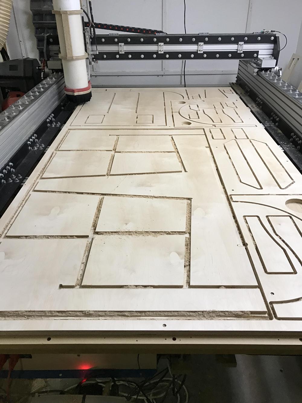

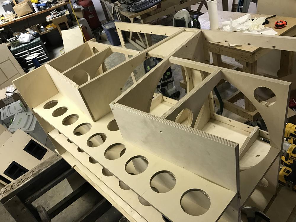

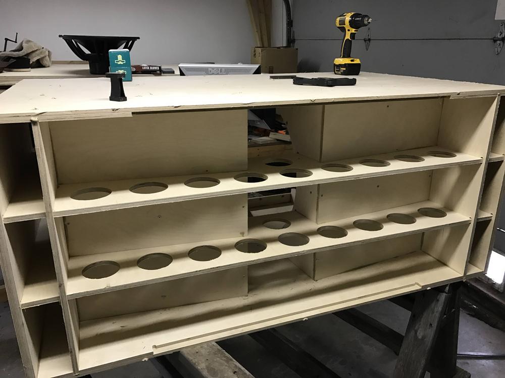

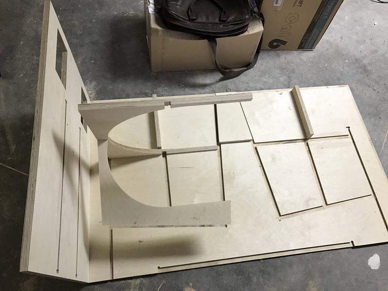

Construction isn't bad. It looks a lot worse than it is. It's mostly bracing and hatch placement. The simplified plan is this. This is the critical stuff. Everything else can be modified to suit the tools on hand or to taste. Bracing, hatches, driver cutouts, handles, hardware, etc...All of that is adjustable really.

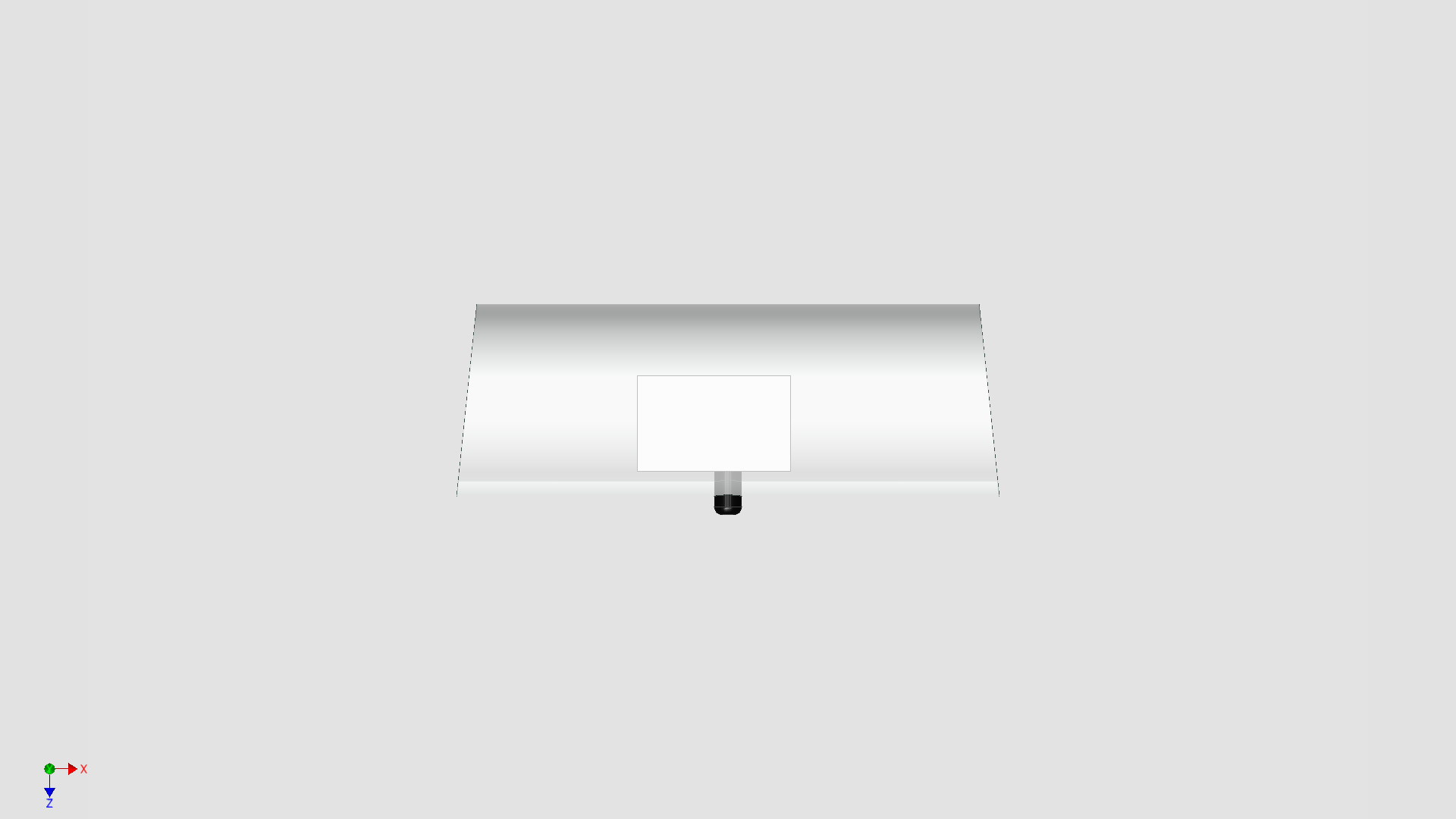

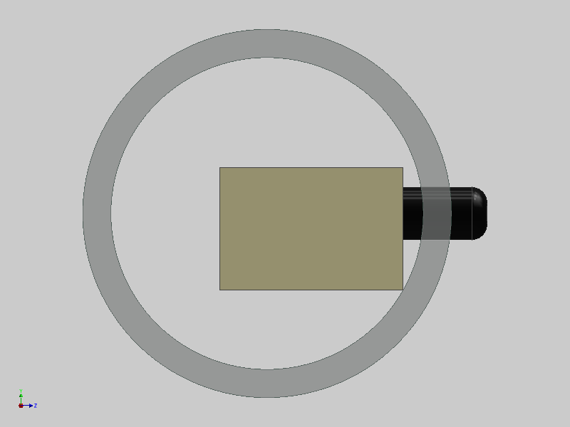

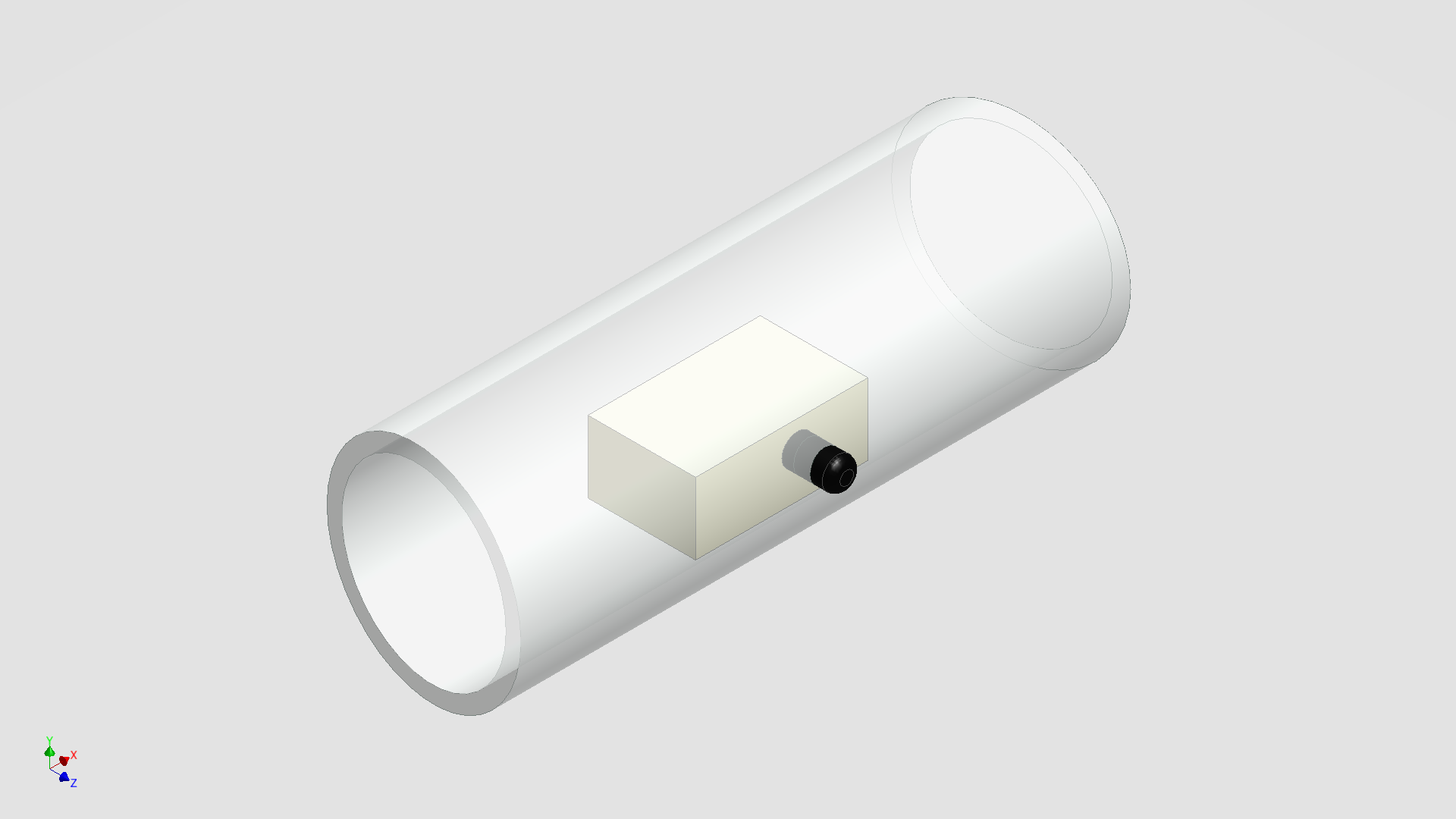

The DSP wants to see the pressure at the back and front of the cones to keep things from getting out of hand. It looks like 1.5" PVC should work.

Yeah 4 to 1 on paper.
Dan that might work. Have to seal the crap out of it though. Air leak through the pvc would be not good.
Getting a 1.5" hole that's cut at 6 degree angle and lines up with the other side perfectly now that's been assembled would be interesting. Could have done it pretty easily before I put it together. Could seal it up with a bunch of PL fairly easily though. Not sure about sealing the ipal sensor inside the PVC with the curve.
Is there a reason you need to measure pressure for both drivers? Wouldn't each side be identical?
I'm not entirely sure about that really. The literature imply that the sensor placement and polarity are crucial or instability will result. I would think that as long as the drivers are operating in phase into a common throat that the dpc sensor could be placed normally. However the drivers are mounted face to face and 180deg out mechanically. I've attempted to ask PS about sensor placement and operation with throat chambers and multiple driver arrangements but they ignored every question I've ever sent them. Unless you are an engineer with a huge customer for them, good luck getting any detailed information. Either that or they simply don't have the answers.
