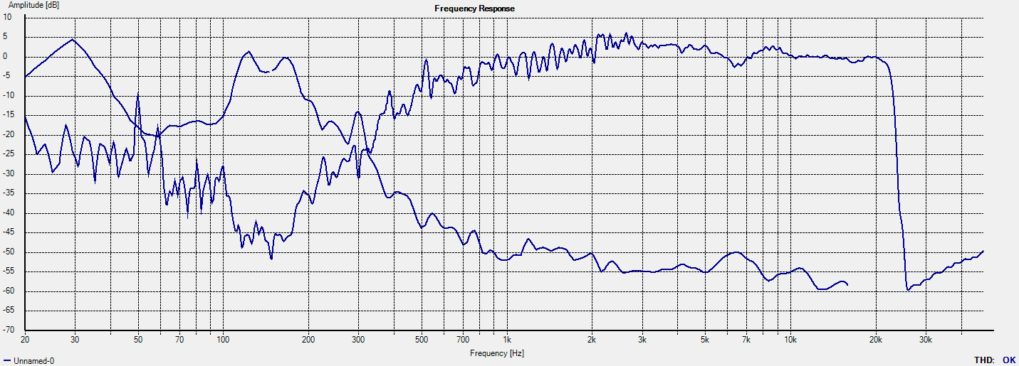

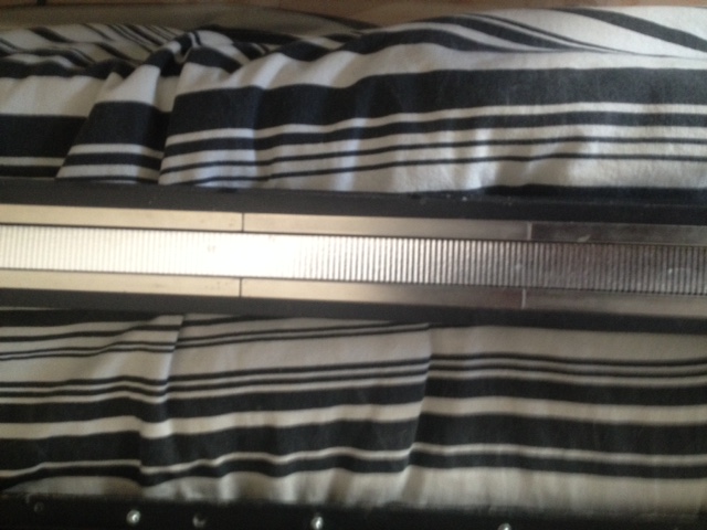

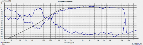

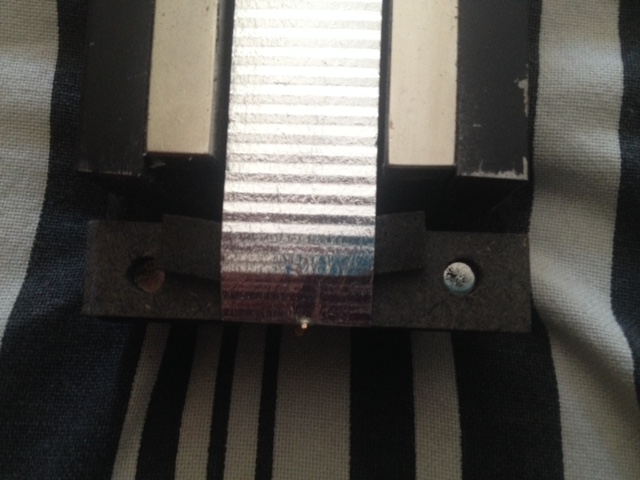

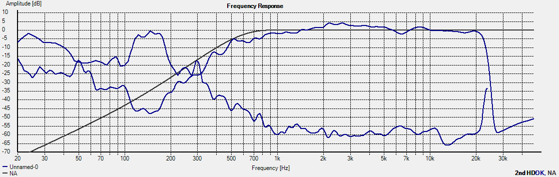

Ribbon with Lundahl LL3322A transformer. 150cm lomg 2.3 cm wide. 4 my alu with glued paper back. Soft foam at the end. "Glued" with small magnets so that the ribbon can be adjusted.
Measured at 1 meter.
