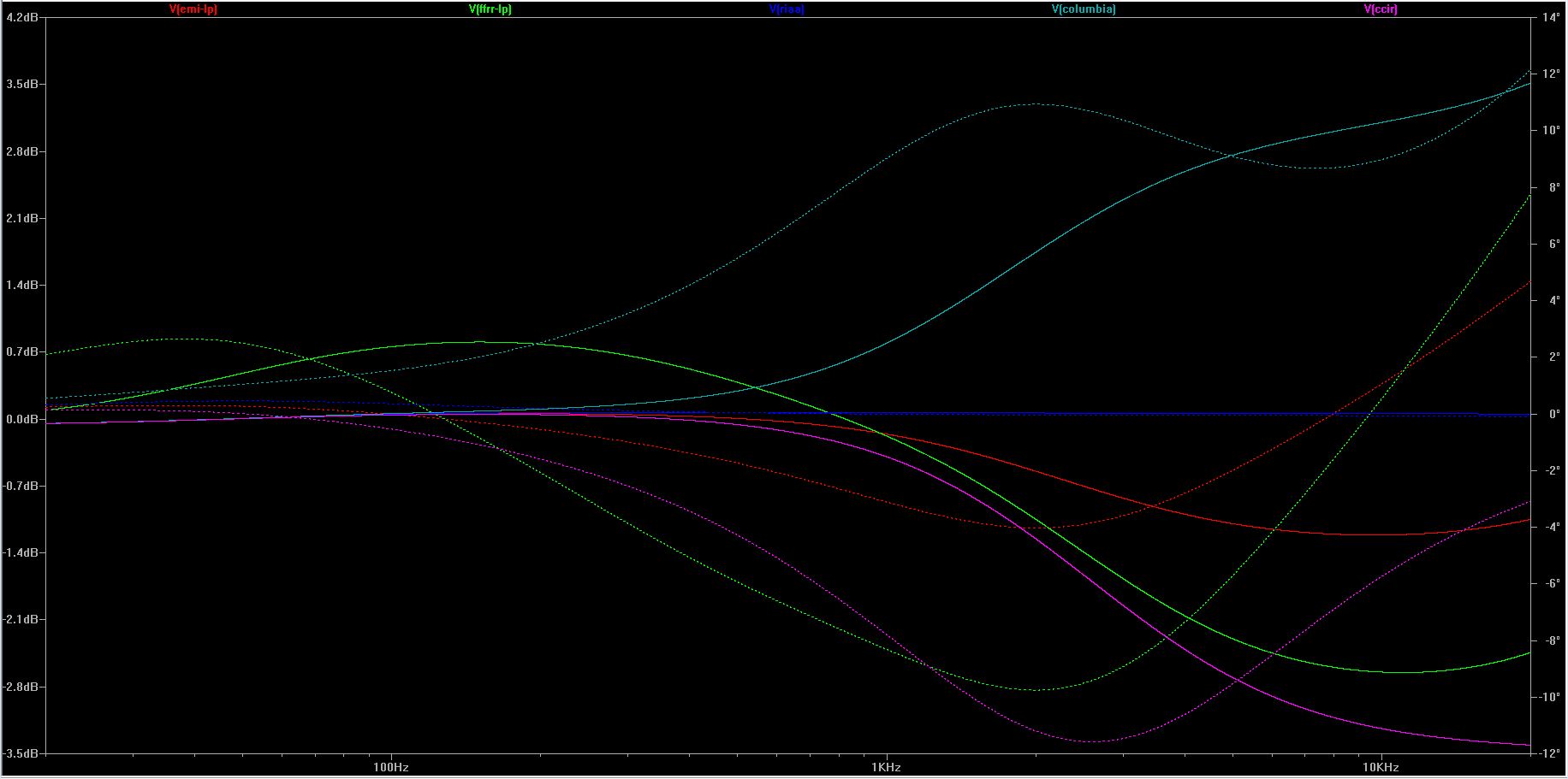

This is what I have derived up til now....Thanks RCruz...
curves are made from time constants and Laplace-transformation. and if they are right I can see quite big differences mainly in high frequency area...
Another way to decode the riaa-emphasis is to use software filters. I have such a system running since a few month, actually using the biquad coefficients provided by Scott. Yes, it is ADC -> software filter engine -> DAC during playback. The result is amazing.
It can't be that difficult to compute the coefficients for those mentioned other curves. Perhaps somone knows how to obtain these by the aid of TI's coefficient calculator?
I seem to miss some understandig how to adjust the parameters to get along...
Or is it possible to compute those coefficents out of a Laplace transform?

The curves can be computed by useing Laplace...I do this in LT-spice to evaluate the filterings I design...Then I can get verification on how close they are to theoretical values and how tolerant they are to componentvalue tolerances..

Yes, me as well. But software de-empahsis using biquad coefficients (that form IIR-Filters with some soundmangling software) is something else. I'm almost sure it is not possible to compute coefficients with Laplace, but somehow it must be possible...

Correct, IIR coefficient computation is not a closed form problem. If you search under Bob Orban's name and RIAA you will find the proceedure (though I can't seem to now). There are plenty of bad approximations out there Goldwave (when I compared it) was way off.
Yes, the original seems to have been archived off. I used a thermal annealing algorithm (unfortunately in in-house software) that did the same thing after many iterations but I could just leave it in the backround. You make an initial guess using the ordinary bi-quad formulas, this works but is in reality far off what can be achieved with tweeking. I exchanged emails with Bob, his "error" was very trivial in that he used 50.5 Hz were it should have been 50.05Hz (or is that visa-versa?). In fiddling with that I derived the ones for the next sampling rate up.
EDIT - I might publish a MATLAB/OCTAVE script to do any RIAA type equalization in Linear Audio but it will have to wait a couple of issues.
