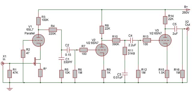

Ok. While its emerging that mix and match tubes are in thing, how about this for a Phono?
Cascodes in the first hole do have an advantage in that the Millering problem is much reduced. Getting low-noise performance from 6SL7s can be quite an exercise and one I might hesitate to undertake. The reason I asked about FETs before is that the bottom of an input cascode is the perfect place to use a low-noise FET. Let the tube do what it does best, swing a lot of voltage, and the FET do what it does best, drive current out of its drain with a high gm. Low Millering means great flexibility in choosing input capacitance.

Re: Re: Re: RIAA and Linestage for life time
Hmmm. the 6SL7 in the first stage is not going to bias at much voltage and the current will be low. That will severely prejudice any FET you could possibly use there. You could lift up the 6SL7 Grid of course, but that will add complexity and will still not solve the low current issue. In the interest of overload margins and noise I'd swap the positions of the two RIAA.sections as well
Secondly, most low noise FET's have a rather stratospheric transconductance which would make your circuit have by far too much gain, even for MC Pickups, let's say a FET with a gm (Yfs) of 10mA/V is used, the gain of the first cascode stage will be 1000. Even if we follow this with the 3180/318uS RIAA section the signal send into the forst 6SN7 would be at around 100 times the input voltage, then amplified by at least aanother factor, so for a MM Input you would have around 60db gain after the second stage and 80db after the third stage. Even or MC pickups this is BY FAR excessive.
Further, the final stage will have a rather high output Impedance.
If you insist on having a J-Fet in there (which is not at all needed for MM BTW) drop at least one stage, use a compound RIAA similar to that shown in my Phono and use 6SN7 in both stages, bypass the second stages cathode resistor, 47k Load, 1K cathode resistor & 250V +B.
The J-Fet should be 2SK170 with around 5mA Idss (BL Grade), no source resistor and the Cascode 6SN7 should have around 10k Anode Load. The 6SN7 should bias up suitably to have enough operating Voltage for the FET. The resultant Phono will have minimal input capaitance (a bad thing for a MM phono BTW as you will need to add load capacitors) and around 54db gain.
Sayonara
Biasing up the grid of the first stage tube is pretty easy. In my preamp, there's a 12V rail used to power the heaters. I bring a 680K resistor from that rail to the first stage grid, then bypass the grid with a 0.33u cap. Two extra parts, no big deal.
