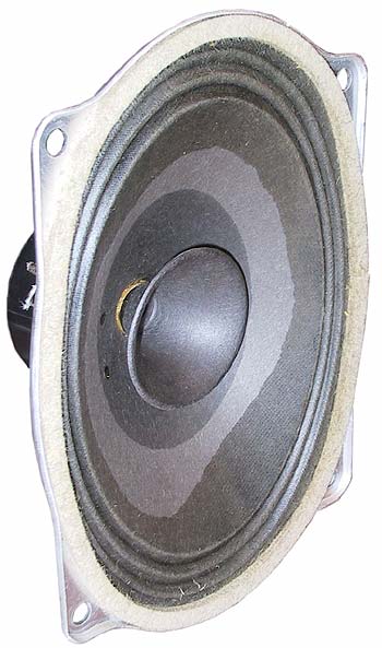

Some of the old RTFs are good -- RFT was a large East German OEM so there was a large spread in terms of quality.
The Philips full-ranges are quite good... the older alnicos particularily so, but the newer ceramic 5s & 6s are no slouches either.

indeed, i didnt knew that there were so good things so cheap,
i have found excellent phillips drivers, a guy sells them, there mucg better then the greencones, (he also sells his 2a3 which powered it) it wont go more then 60 euro for a pair, and the same for 8 inch greencones that are in super condition. SO thats exatly what im gonna buy, even for my borther and friends also if it works out fine for me.

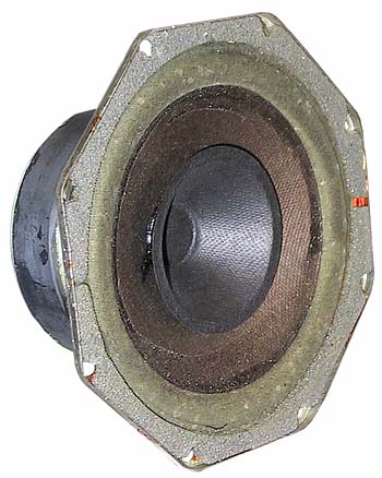

Konnichiwa,
then_dude said:
does somebody knows something about the RFT brand speakers
They cover a gamut from plainly crap to excellent. RFT was a large state owned concern in east germany, which acted as umbrella for at least 3 or 4 main speaker manufacturing Plants, which in turn often subcontracted to small private companies or cooperatives.
then_dude said:
i m looking for the specs of their drivers, for example the fullrange
RFT L 3401.
You will not find much in terms of T/S Data, the sensitivity of the L3401 was around 97-99db/W/m and it had a fairly high resonance 50-60Hz) and Qt (intended for open back PA boxes). Build was quite poor, compared to the higher quality stuff from either the west or eastern europe (such as the cast frame RFT's and the alnico magnet Lomo's from soviet russia).
Sonically the stock unit was inferior to older Eminece OEM units that where similar to the Beta 12LT but with lower powerhandling. So, think Beta 12LT.
Some of the better (cast frame) 12" Fullrange Drivers from RFT sound much better, also a number of small private companies and cooperatives specialised in modifying these cast frame 12" & 15" Units, often achieving surprising quality.
The L3401 however is pretty basic PA stuff and not that hot. If cheap buy them for all what it's worth. I suspect they will still sound nicer than many modern commercial supposedly "high fidelity" speakers with a suitable Amp.
