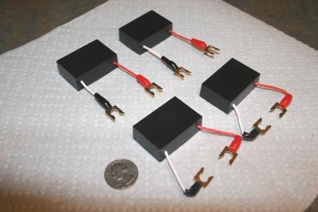

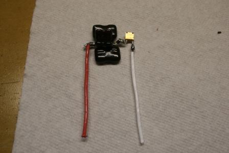

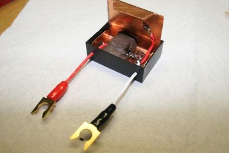

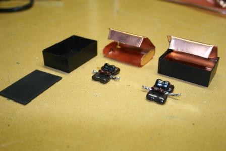

I did however, DIY some RC speaker cable filters that are still in place. Once installed at both the amp and speaker end of the wire they seemed to me to have a very positive effect on the sound. Whether they are filtering out RF or simply terminating the TL more effectively, I don't know, but they do something I like. I calculated the characteristic impedance of the speaker wires at RF and chose the resistor value to match that. The caps are cascaded silver micas. Before potting I embedded the caps in mortite to attempt to damp resonances. Inside the potting box is an inner box of TI-shield material.
Here are a few pics showing what I did. The final filters are potted in epoxy and as hard as bricks.
