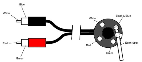

I am in the middle of rewiring my Rega planar 3 tonearm I have the new tonearm wires red, white, blue, green & ground which I will solder directly to the interconnect per the instructions "HOT WIRED REGA "Frank of audiophil, My problem is
I don't know what goes to what the interconnect I purchased has Right channel (1-Red rca with blk & wht bare wires at other end) and Left channel (1-Black rca with bare blk. & wht. wires at other end) the ground is a seperate wire i know what that connects to but can anybody help with connecting the red/wht/green/blue - to - Left (blk. & wht.) and Right blk.&wht.)?
This should be it
