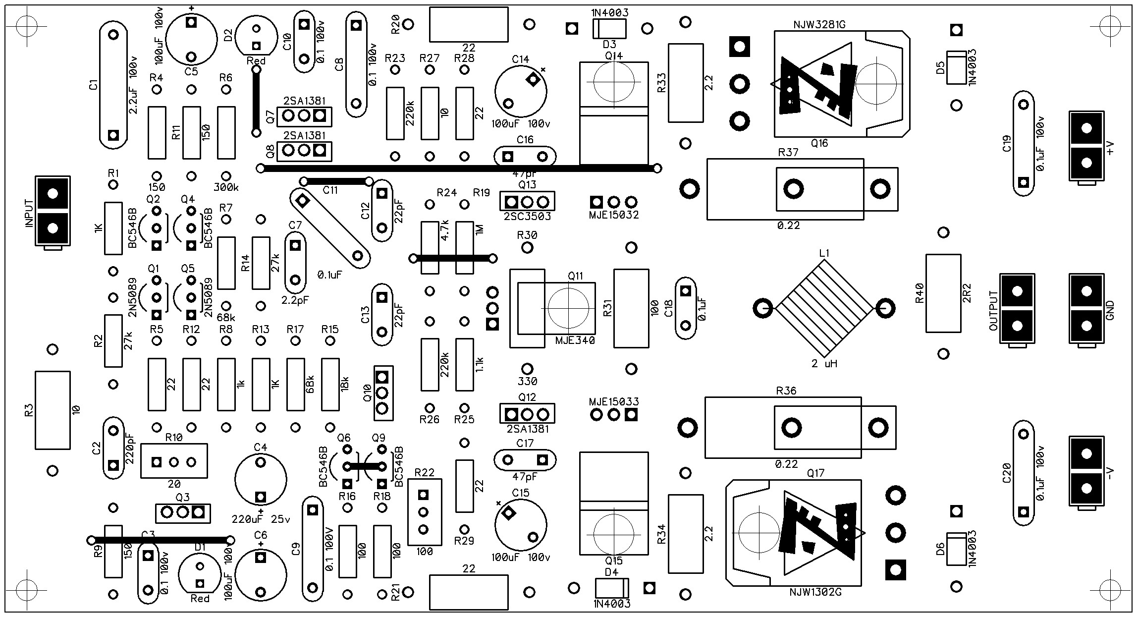

I've done some chassis drawings to fit Modular NS series boards and all associated parts into a 300mm deep 4U chassis from the DIYAudio store. I don't have a chassis in front of me to physically measure so I am relying in published dimensions for this so use these at your own risk and verify dimensions first if possible. If anyone can provide accurate physical dimensions of these chassis it would be much appreciated.
The output boards are 300mm deeps so this requires trimming 2.5mm off the front edge of the output boards (empty board space) and re-drilling the front board mounting holes to allow enough space to get the input connector depth correct. There are drawings to construct supply / control board mounts and a mount bracket to vertically mount a pair of transformers.
The drill templates can be adapted to just about any chassis. They are drawn to fit legal size paper. Distance from the rear edge and the top edge are critical so line those two edges up with the heat sink.

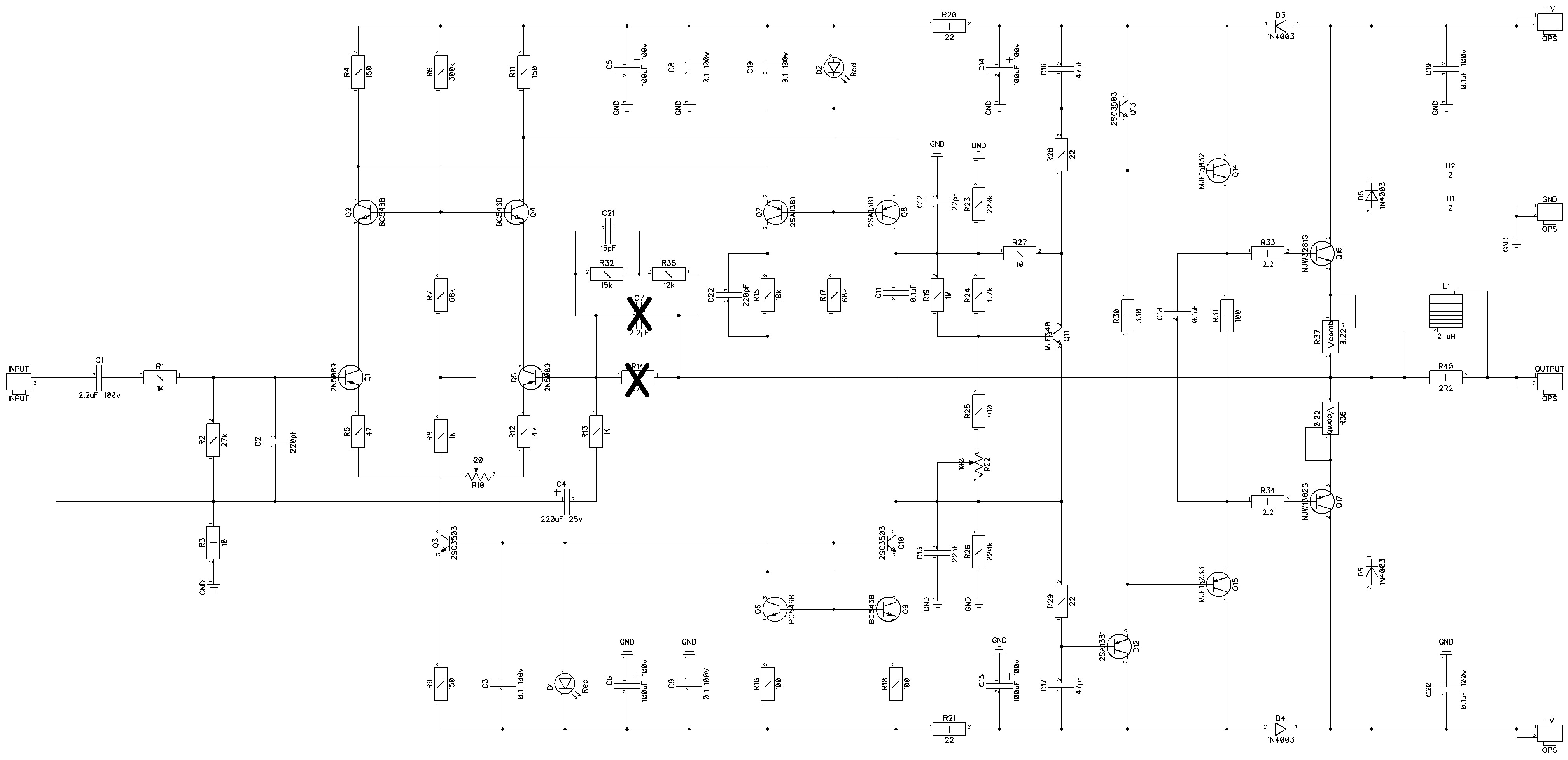

Parallel LT BJT OP
Hi Valery and Jeff and Fellas here.
I am a bit in twice about Parallel LT with Bias spreader as shown in Schema from Juli # 821 and later presented Board in August.
Bei observing every trace and part placement i found a added 1Mohm Resistor
and the 10 Ohm differs also in placement to Schema.
So i am wondering wich one is right now?
Is it a real tested board?
It seems no one was interested to work on parallel Luxman clone Topologie,
So i show here what i have done at the moment.

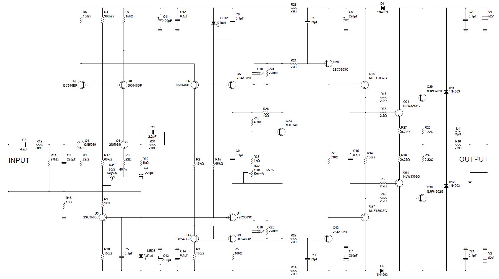

Hi Bangla,
See the latest update of the schematic.
R19 (1M) just allows more precise trimming of the bias adjustment threshold - reducing this value you can move the threshold to the lower bias values if required.
Valery

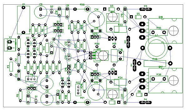

Parallel LT Beast
Thank you Valery.
Very, very kind help. That brings me a step forward.
Now i can overview where my brain stopped working.
So i have added updated parts in schema now.

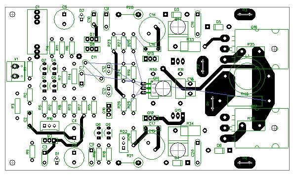

Next problem (for me) now: if i renew design by components- all my pattern
work is lost- in different times i don't find out how to do.
Only way maybe a second copy?
My last tiny progress.
Regards.

You need to change your patterns in the schematic, not the layout. That way changes are will remain. In the schematic right click on the part you want to alter and select replace part or go into the parts properties and select Attached Pattern and change it there. As long as the RefDes and the net names haven't changed everything will remain when you renew the layout.
