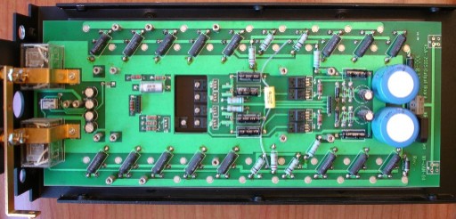

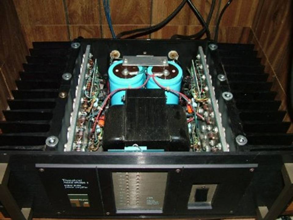

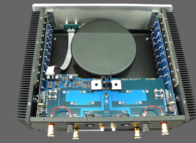

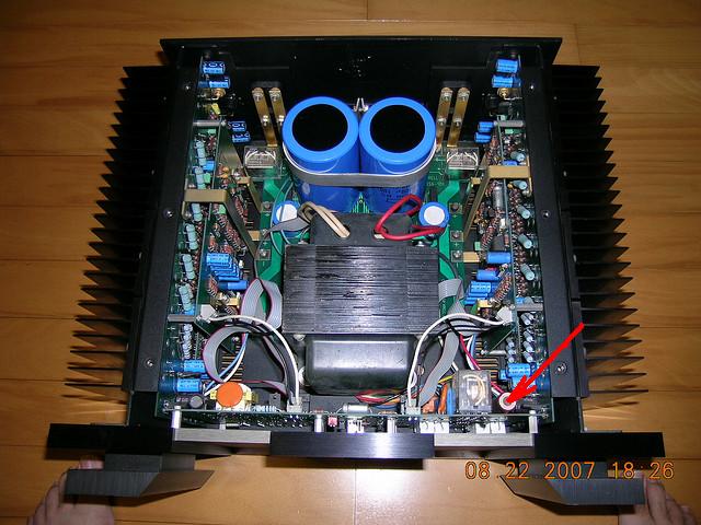

Hi Ingvar,
The physical construction of your amp is very similar to several Krell and Nelson Pass Threshold designs that include:
1) Separate PCB attached to heatsink for the high heat output transistors and Re resistors.
2) Separate PCB on heat-isolating riser posts attached to the output PCB. Heat kills! Avoid putting input devices close to Hot Outputs. Some riser posts can serve as electrical connections. e.g. a mechanical star ground path.
2b) Using ThermalTrak outputs with integrated temperature sensing diodes reduces the chance of oscilation with a separate driver PCB over a transistor Vbe multiplier. The Leach Amp document discusses this.
2c) Output stages seldom change. Using a separate input stage PCB simplifies testing new driver circuit ideas.
2d) Dr. Keith Johnson (Go Stanford Cardinals) of Spectral favors putting the driver PCB at 90 degrees from the output power PCB to minimize the coupling of magnetic fields from the high current outputs from crossing into the low noise inputs. Just sketch the magnetic field lines from the high current outpu bus traces and keep the input circuits at a safe distance. Spectral uses a metal can over the JFET intput circuits for further mag shield and temperature stabilaztion.
3) Output power supply capacitors directly next to output terminals in order to optimize common star ground and feedback with speaker R-L-C complex impedance load.
4) The Magtech construction(jpeg) uses very large PCBs and wastes some heatsink length for a clean physical construction plus a simple case construction. Power Capacitors are under the PCB attached to output terminals. I think 4-ounce copper PCBs or soldering copper bus bars to the PCB would be necessary to carry the high currents.
Hope the pictures add to your thread discussion.

Everything, allmost, adds to my threads.
The orderly look of these fine amps are nice and thats one reason i´m dismantling it, to tidy up and wire it with, at least, some concern over interference issues, also replace caps as it getting on in years.
The interior actually looks just like my workshop, a bit like if i did the latest tidy up with a handgrenade.
