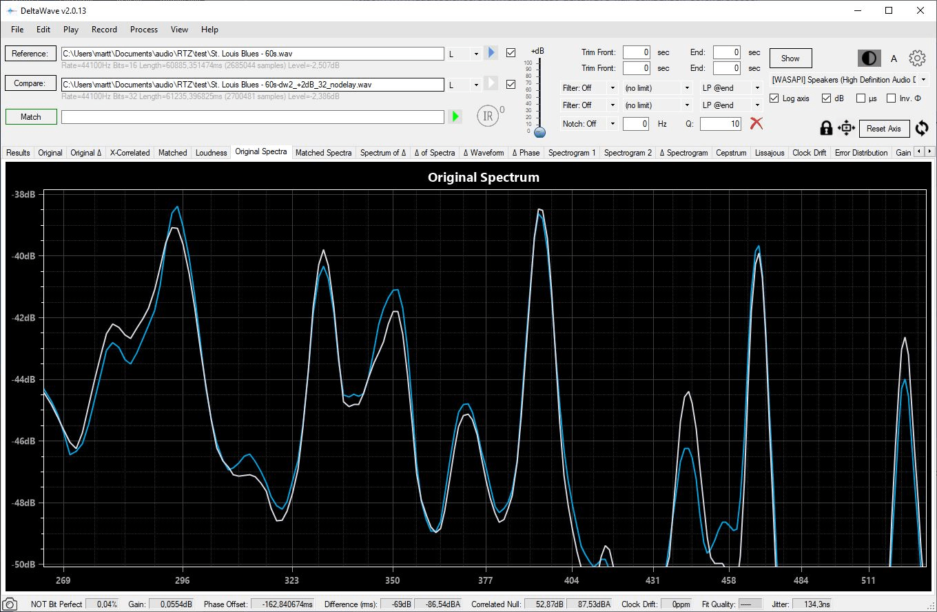

Okay, it appears obvious some bins need to move up and some need to move down in amplitude, and by different amounts. Only EQ can do that.This is how original spectras look when both are 60s recordings (reference is first 60s from the original).
Marcel, what do you think?
However the pic is of the average FR over the full 60s. It does not show short-time spectral energy variations, right?
Also, by adjusting bin values it should be possible to achieve arbitrary average FR matching in a numerical sense. IOW, we can carry out the math with arbitrary precision.
To repeat: waveforms are matched and spectras are calculated from waveforms. When you make a recording of 60s the delay (or latency) in the setup will be added. So the resulting recording is 60s+delay (normally delay is zeros in front). If spectra is calculated from orignal waveforms they will be different due to the delay.

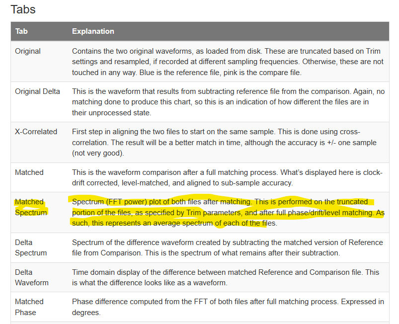

We are still guessing at what DeltaWave is doing. Its getting us nowhere. IMHO its useless without proper documentation.No. That shows spectras calculated from original waveforms. The help text for that tab is "Original, unaligned spectra of both waveforms".
That said, the same music played twice in row on the same system should essentially have the same FFT spectrum each time. It doesn't matter when the Play button was pressed. Same for two files virtually the same as each other. It doesn't matter when play is pressed. The FFTs of the whole recordings should be virtually identical.
Moreover, moving bins up or down in value is EQ, unless the gain factor (multiplier) is the same constant for every bin, in which case its volume control.
Moving data in bins to the left or to the right is pitch shifting. Its how to make a tenor sound like Darth Vader. Move the tenor's bins to the left to pitch them down.
Here is the documentation -> https://deltaw.org/mydoc_quickstart.html.
Look at the Results tab. It will tell you the gain difference between the files as well as the timing offset. Both values are constant.

How is matched spectra calculated?
EDIT: Didn't see your query about phase, I think you can only see the delta of phase, not absolute.

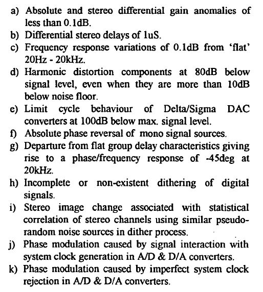

According to an AES paper presented by Paul Frindle, chief designer of the Sony Oxford digital mixing console, the following findings of audibility were reported:
Please describe which the above audible effects would be determined to be audible or inaudible by use of DeltaWave.
I don't know what is audible to you.
I think @bohrok2610 suggested this in the beginning, but if you listen to the two files (DeltaWave also offers a comparator that you can use to listen after the files have been time / gain aligned -> https://deltaw.org/comparator.html) and point out areas where you where you can reliably tell a difference, we could then look at the DeltaWave results to help understand the differences at those moments in time.
