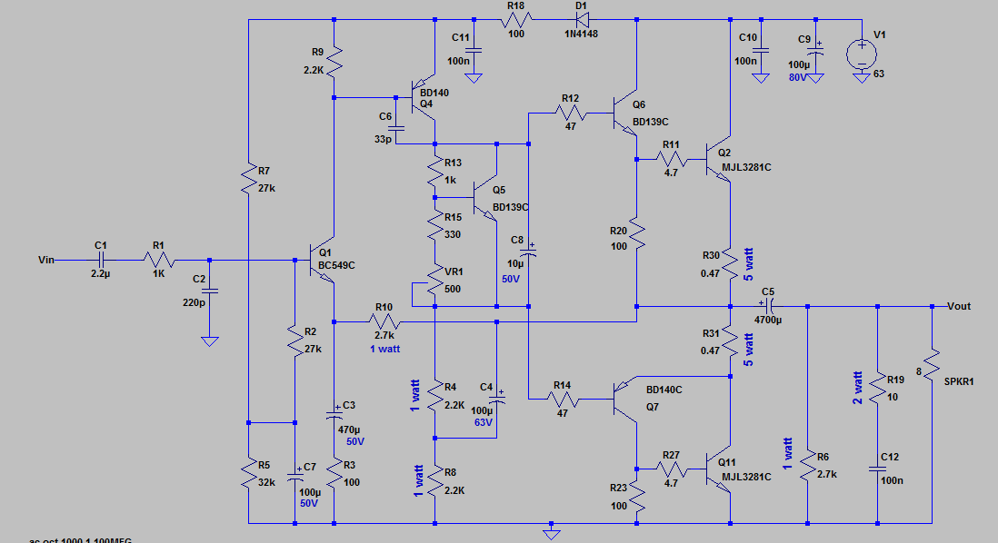

C3,C4 are intended to act as "sprog stoppers". So if you miss them out you will get sprogs. (high frequency oscillations). Whether you actually need both compared with one at twice the value is another question. C8 provides phase advance feedback to compensate the delays in the VAS loop.
Often this type of compensation scheme is discussed by others but they tend to describe the VAS stage loading with larger capacitors (1nF). The point is that the capacitors need to be reduced to the minimum necessary for stability, and as they do not get fed back into the base of the VAS they offer less roll-off and therefore more gain to reduced high frequency distortion - crossover in particular.
If you experience instability in one half (typically the lower where the PNP-NPN exhibit a double phase inversion) you can increase one capacitor as Andrew says by experiment.
If you want to restore the slew rate just increase the VAS current. Actually in all the simulations I have done nearly all VAS stages show less clipping on transients if the current is between 20 and 30 mA rather than the common 6mA.

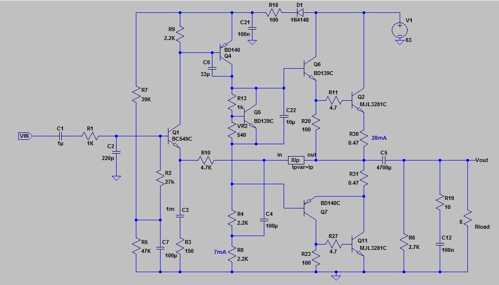

i found an interesting schematic of a retro amp and changed some part values. your comments are welcomed!

Thanks maouna for finding this and updating the inscrutable Xi and C5.

I do understand why seventies single supply designs always use two NPN output transistors, since the 2n3055 then was half the price of pnp equivalents. Or for long there were no PNP equivalents. But why are these single supply designs invariably quasicomp output now? The price of pnp and npn is the same now.
tiefbassuebert & I have corresponded about this, and his proposal to "speaker protect w/o relais" doesn't in my limited understanding, include a series speaker capacitor that is always positive biased. ( Back to back electrolytic series speaker capacitors on split supply amps sound funny, by experiment).
I dont know how this circuit using modern transistors is going to perform when it comes to oscillation issues.. simulation results are very good however with no problems indicated.
These retro style amps have good harmonics distribution and i think this has also to do with quasi output stage topology used.
Actual x00 khz Ft output transistors are long gone. The new 2n3055 etc are 2 mhz parts, mostly, if not faster. On Semi sn3772 is still allegedly quite slow Ft.
I've been coping with possible oscillation on the dynakit ST120 by putting 50 pf across driver b-e junctions as suggested by the dynaco "TIP mod". So far using NTE60 and NTE181MP output transistors, so good.
I think with the idle output bias current solved by modification, the ST120 sounds really good. So perhaps the quasicomp output has advantages of "proper" distortion. I really can't tell the difference in sound between ST120 and the fully complimentary Peavey CS800s, though.

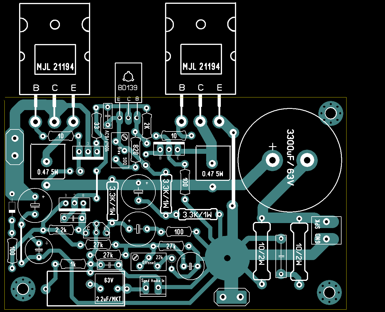

I made a layout for this amp...i hope the routing and ground distribution is fine..... :rolleyes: some component values on the pcb layout are not correct and were choosen arbitrarily.. correct values are on the schematic.
