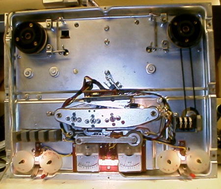

Well to get back to the topic of this thread, I did get the machine running last night, and all mechanical functions and the transport work perfectly. I did have to tinker with the tape tension switch as someone had messed with it, but I got it going. I also had to replace the 100 ohm 10W (really 5W) tape tension resistor - this is used with 7" reels and below and bypassed for 10.5" reels and above. (Yes it will take a DIN reel.)
Playback is fine, no odd noises and it sounds ok on material recorded on the other machine.
The right channel records fine, the left channel is intermittent. I suspect a bad/dirty contact.
I completely disconnected the monitor amplifier and removed the output transformer and speaker. I modified the optical tape sensor circuit to run off of a higher supply voltage, (133K in place of the 100K on the optical board) changed the 2.2K resistor to the oscillator and record amp from 2.2K to 12K and moved the connections for them both to the highest voltage taps on the supply. All voltages are within about 5% of where they were before, and the voltage regulation to the rest of the electronics is slightly improved by the change which was inspired by Charlie King's article in Glass Audio's first issue.

I did some work on the record amplifiers and the signals seem to be clean to the traps anyway..
Playback on the left channel now appears to be malfunctioning..
A little progress and some setbacks along the way. I will probably have to remove it from its case yet again when I next work on it.

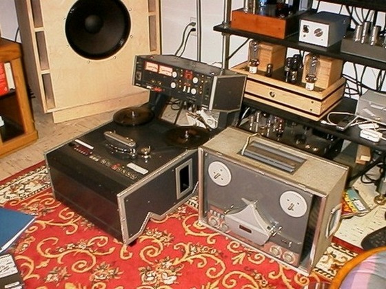

Here's a picture of my Otari and the ReVox next to it.
There was a higher speed/higher torque motor for 15ips operation on 50Hz, for 60Hz I think the only recourse is a capstan assembly change. I can imagine the cold speed issue might well be a problem in cold weather around here. I encountered it on a machine I worked on when the issue was not well publicized..
The eagle eyed might just barely notice that the Otari is in record mode and is in fact doing a dub from a cd to tape.

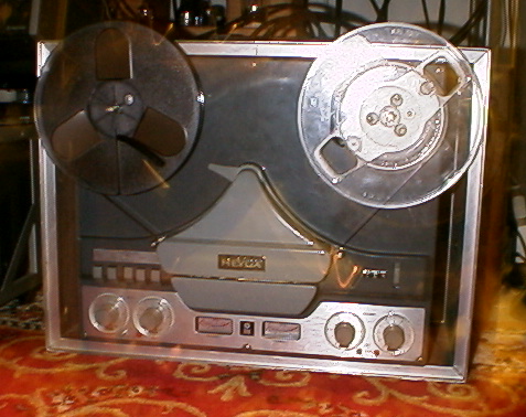

Here's another picture.. It's actually playing in this one. (not well though on one channel... :xeye: )
The transport is working fine, I fixed a minor problem with the tape tension switch and also replaced the 100 ohm power resistor across its contacts. The solder short across the switch initially lead me to believe the switch was bad - it was, later fixed, but the power resistor was open. This was probably due to it being a 5W type when it really needed to be 10W. The new one is a series string of 4 x 25 ohm 5 W from my bins and has a ~20W rating. It gets quite warm in operation.

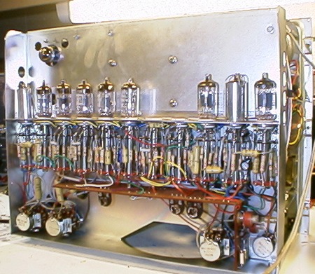

Spent some more time last night on the deck, measured all of the dc voltages on every pin of every tube in the playback amplifier.. Everything seems to be in order, but I did not have time to run a tape and use my scope to see what is actually going on in the ac domain. All I can say is that I see no particular reason why the left channel does not play back correctly.. Dollars to donuts it will probably turn out to be a bad coupling cap. The caps are those mustard yellow Mullard things, and none are leaky, but that does not mean there isn't one open somewhere. (Hoping it is not the head.)
To measure voltages I've been using a Hickok made diagnostic socket with contacts that I can probe as a lot of the circuitry cannot be directly reached because of the design of the amplifier assembly.
I cleaned the tube sockets last night as well, hope to run a pre-recorded tape as well as one recorded on the Otari and see what happens tomorrow evening.
