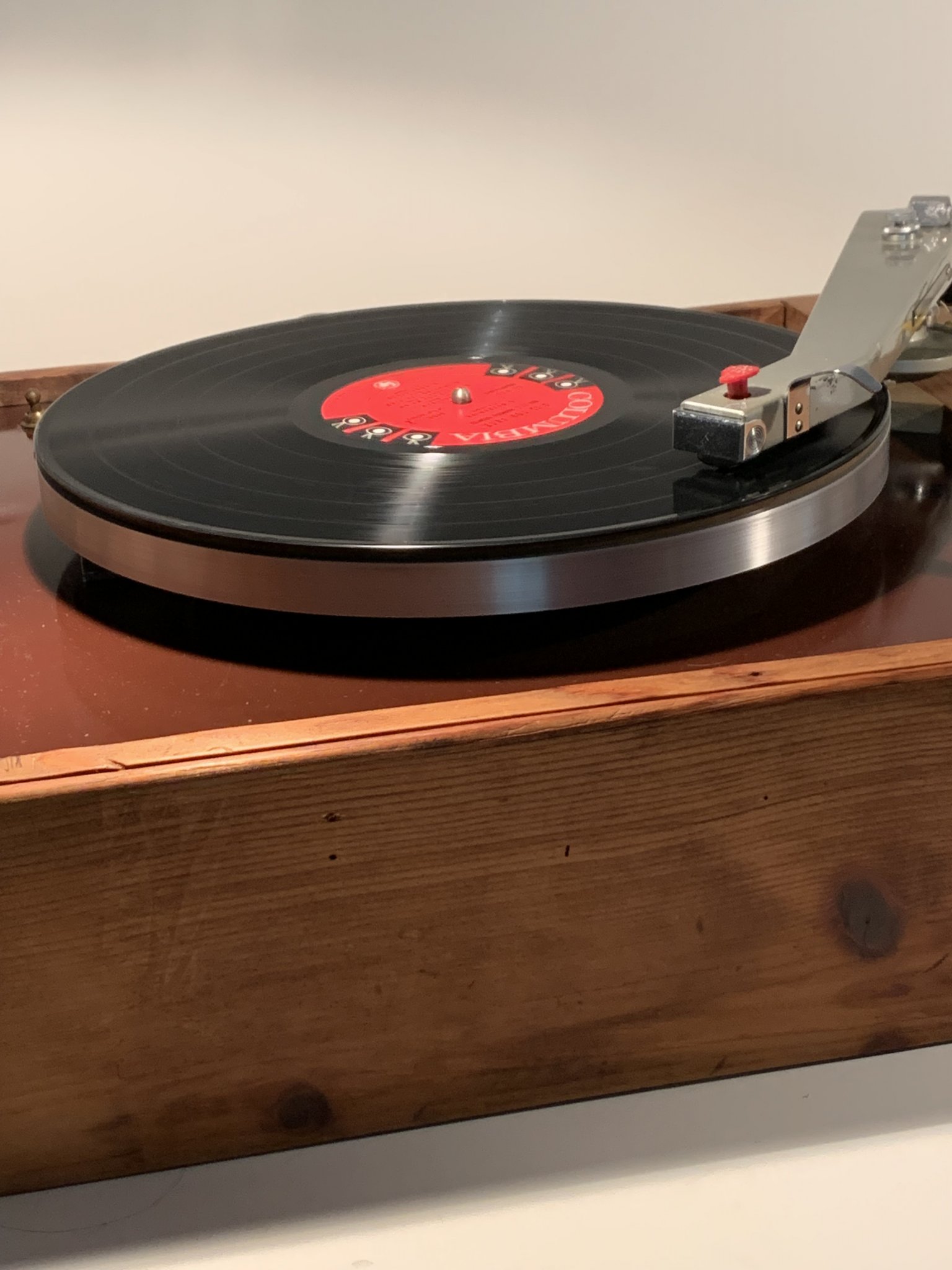

Okay, 11 years later and I've finally made some progress on Dad's Presto turntable.
He had made the case from scraps and miscellaneous. The top plate seemed to be some scrap of 3/16 iron and is heavy! It had random holes from a previous life. I filled them in with epoxy and filled and smoothed the rest of the plate down and painted it in a nice old wine color. The perimeter of the base is made from 2 sides of pine and one side of plywood plus a fat 3" wide piece of timber. Rather than make it too pretty (more so than in its previous life) I just fine sanded it and gave a couple of coatings of oil.

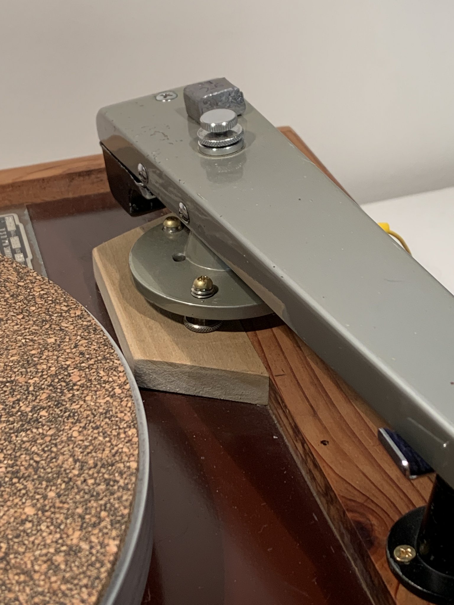

The first design issue was that the tone arm mount would need to be inboard of the right edge of the frame. I looked up the length and angle geometry of the tonearm and it would need to come towards the front a ways to hit that location, further forward than would look right.
The arm has 3 point mounting with height adjusters (not really necessary with a unipivot arm, its going to find its own level, or not!) I want the mounting screws to go about an inch in from their current location.

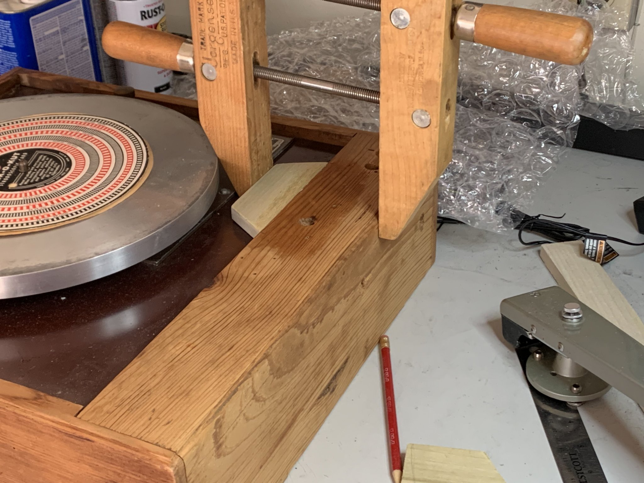

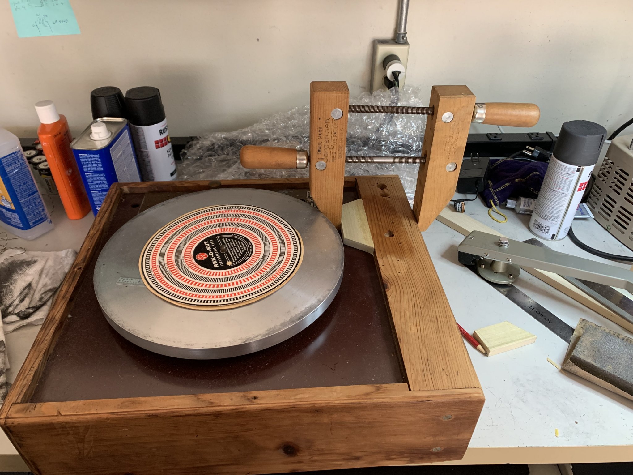

I cut a piece of pine for the added arm support and got out the old Jorgensen
Same again from another angle.
Willow guards the Snell XA Reference while we wait for the glue to dry.

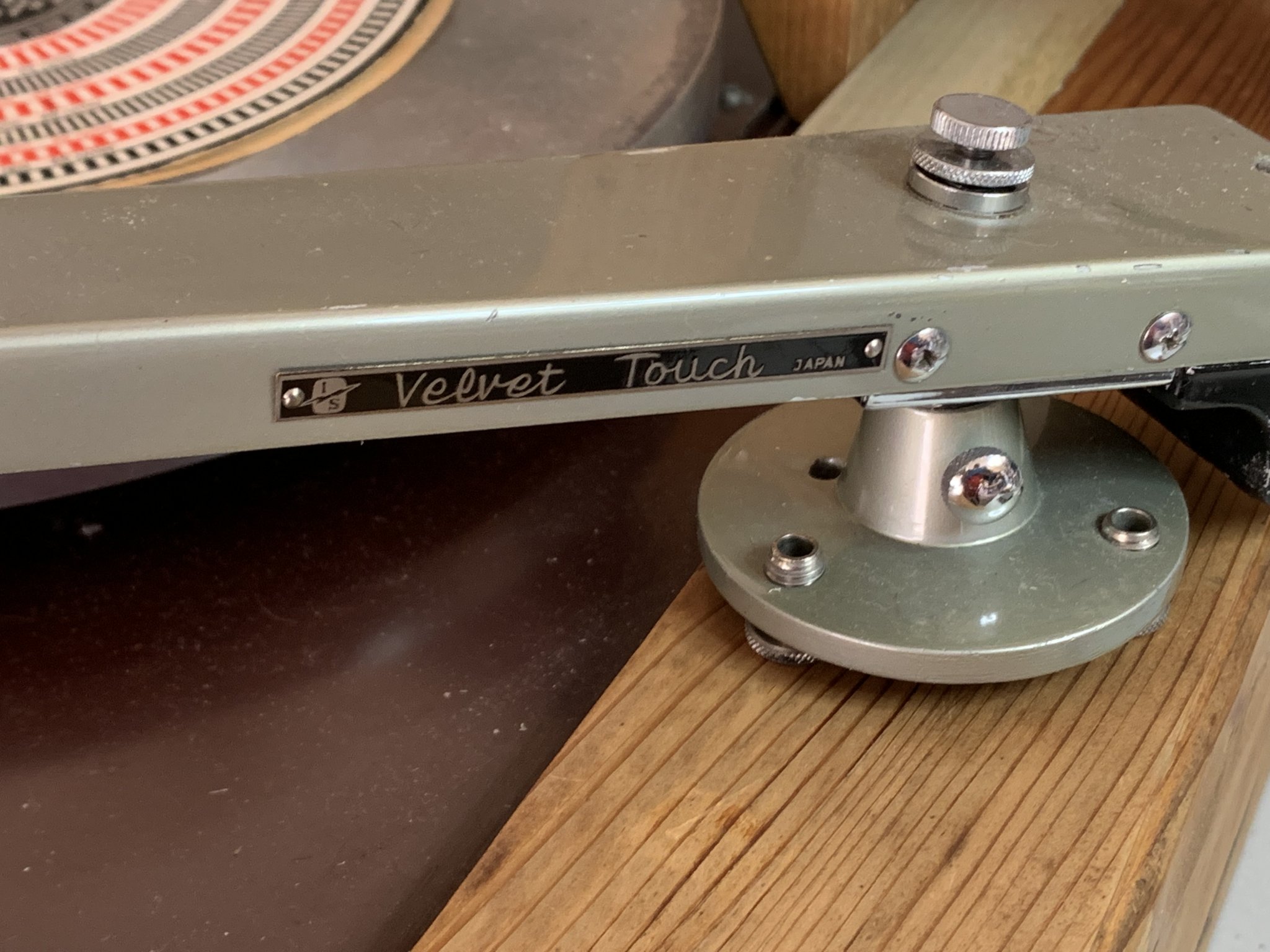

Here the arm mounting is finished. Note the lead weight on the back. There is a black tray for lead weights underneath the rear of the tonearm. It had a single large lead weight that didn't give the right balance so I took it out and cut it into thirds. Now, since the tone arm has a unipivot, you not only have to set tracking weight but also lateral balance. I tried lots of different combinations and could get the counterbalance weight right but not the lateral balance. This meant the arm would lean left or right. It works out a lot easier to have an external weight and slide it about, as needed, to get the right downforce along with the right lateral balance. Not elegant but who among us didn't have a stack of quarters scotch taped to a tonearm in our youth??
You can also see the nice new cork mat that I got for the turntable.

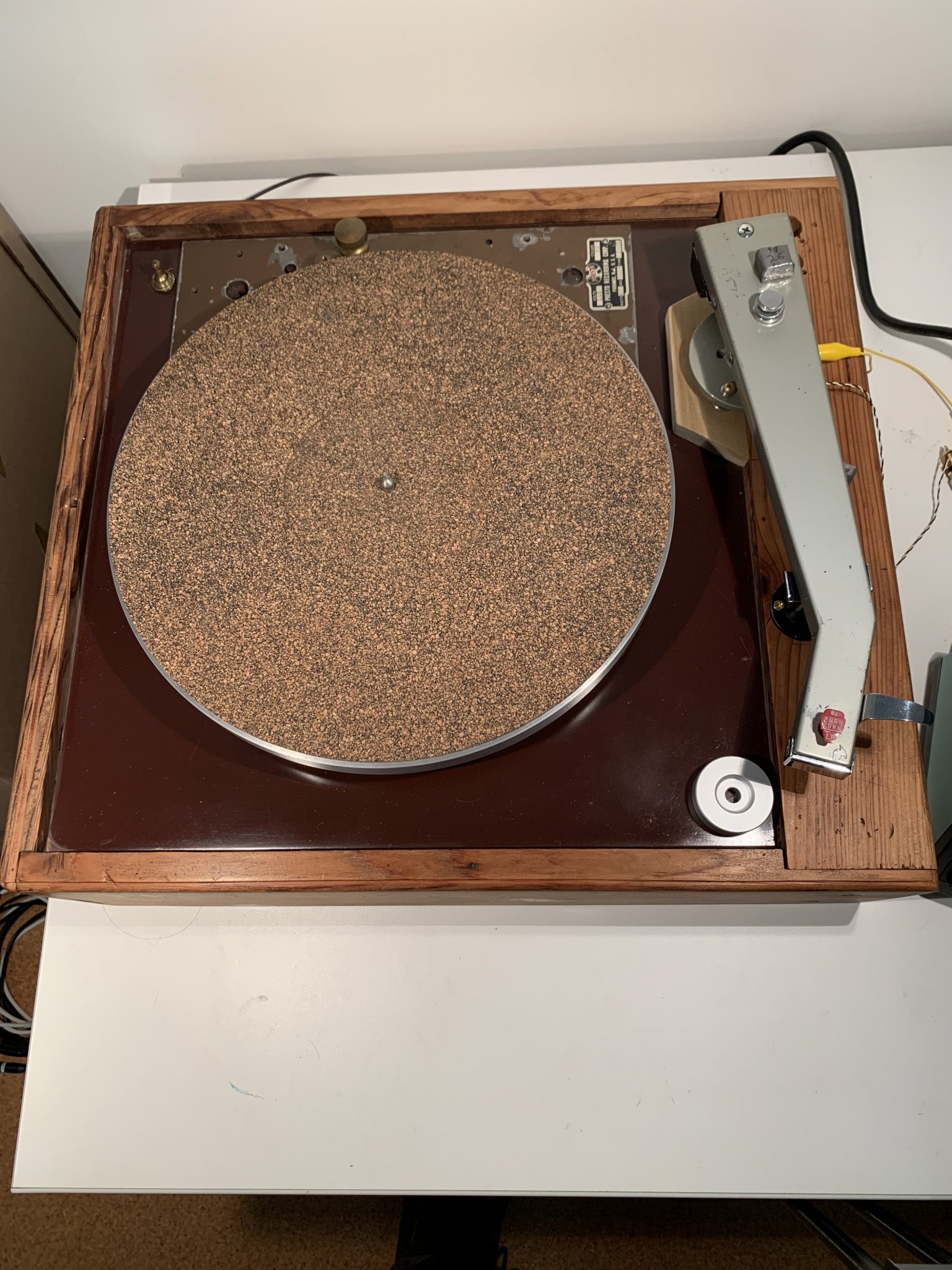

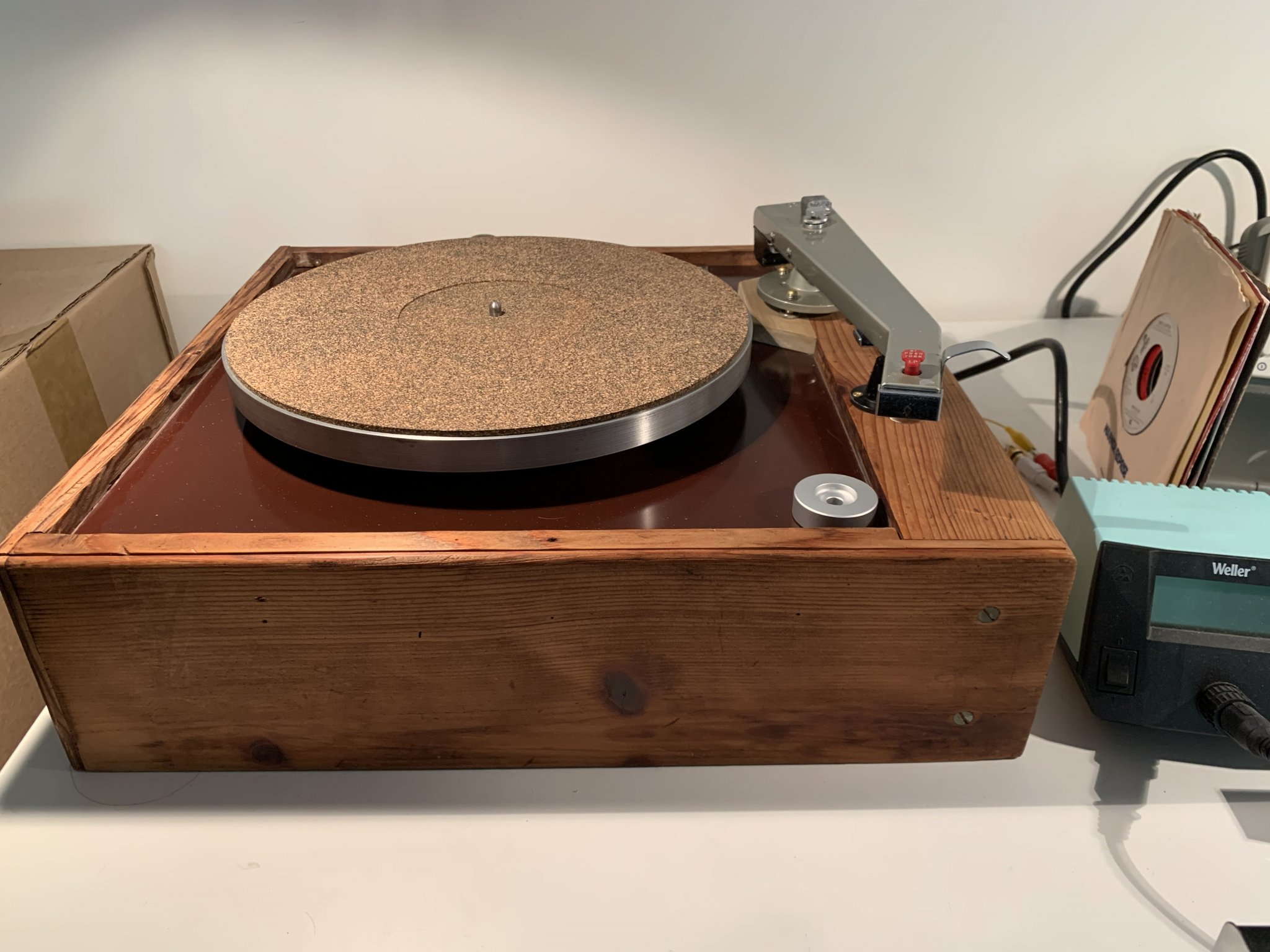

A couple of shots of the near finished project. About the only thing left is to figure out a tidy way to terminate the wires into phono sockets.
Its on my workbench now. I love using it as it is stable and fuss free. I like having the turnover cartridge and play 45s and 78s and (mono) LPs. (GE variable reluctance cartridge) Being next to me I can play singles one after the other without walking across the room. I had thought of adding suspension, such as handball balls, but it is heavy enough and the bench is steady enough that nothing is going anywhere. Nothing skips.
I should also add the damping oil (it is designed to be viscous damped) but I'm in no hurry. I played with this as a teenager and only succeeded in overdamping it to the point that it took 10 seconds for the arm to drop, causing it to surf from peak to peak on warped records. If the arm were skittering around on 78s I would be more motivated.
That's all for now.
David S.
