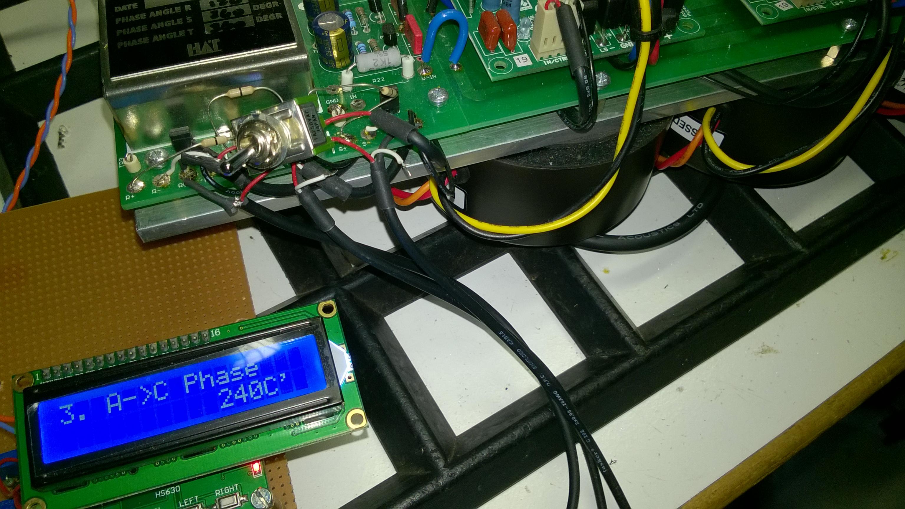

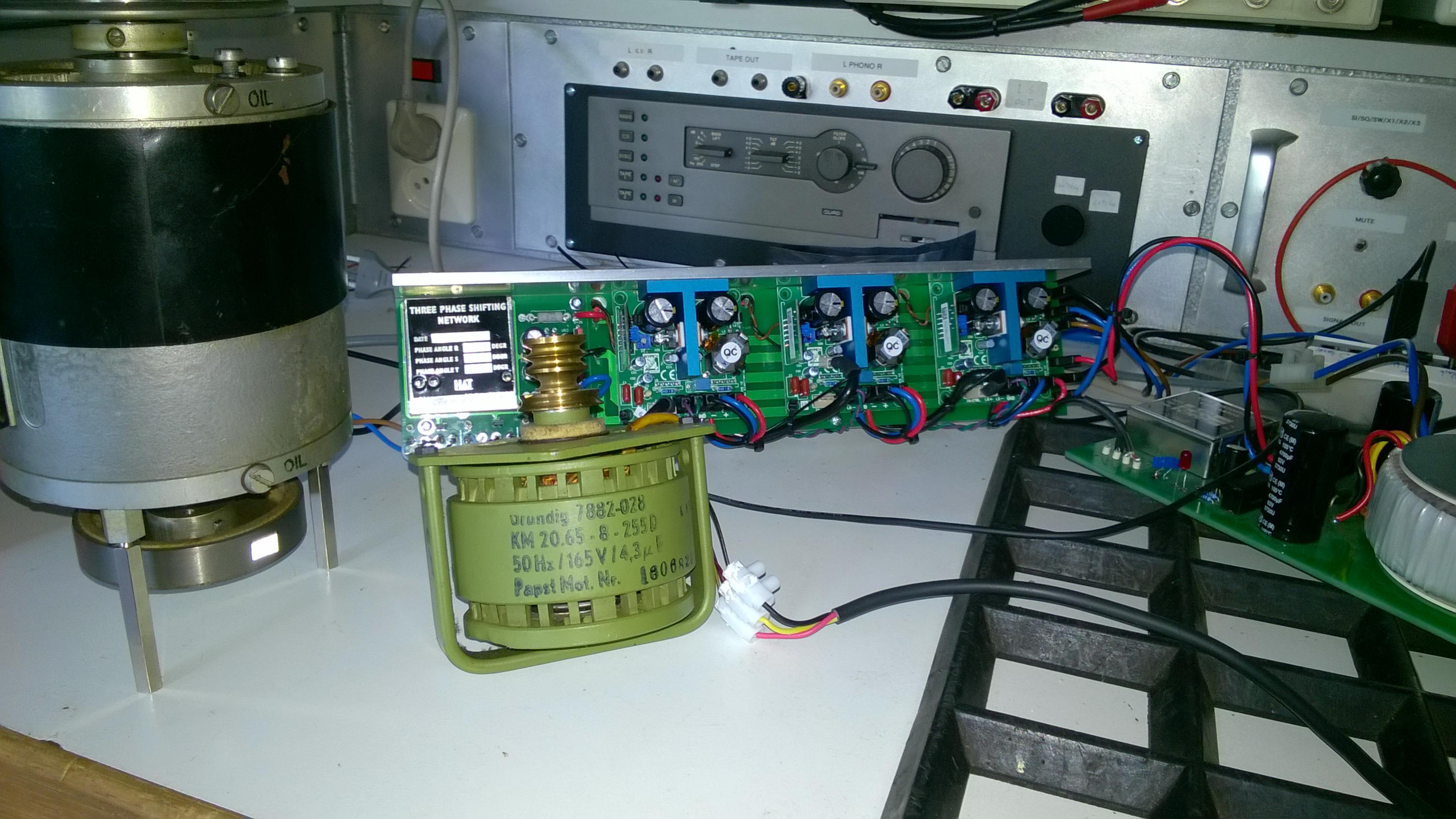

Three phase supply
My three phase supply for the Thorens Papstmotor is ready.The adjusting of the analog phase shifter should be done with a phasemeter .I think about to provide this complete unit with the output amplifier.And the analogue oscillator also which has the transformer and rectifiers on it for the poweramps, this oscillator needs adjustment also for low distorsion.

I will of course update, with details and pictures, as soon as I have something worthwhile to show.

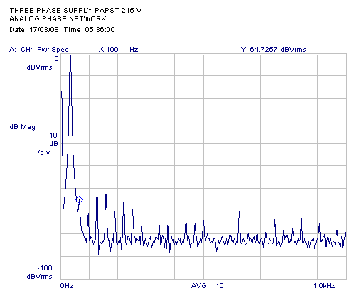

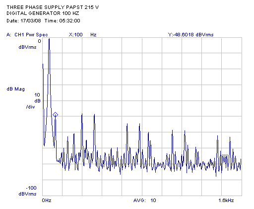

I have tried this to and it works but the it is not so clean as a analog oscillator which is important for min.motorvibrations.
Please can you tell me whether those graphs are of the oscillator outputs or vibration of the motor?
I'm more than happy to accept that analog oscillators can provide a lower distortion output, but whether this is measurably translated to motor vibration has not, as far as I am aware, been proven.
I am not interested in a variable frequency output, simply 3 phases at 50 Hz (or 60 HZ) with an accurate phase relationship. This requirement allows the addition of notch filters to significantly reduce harmonics and ensure as clean a signal as possible gets to the power amplifiers and thence to the motor.
