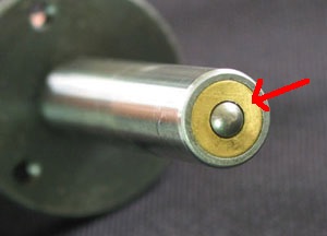

Sorry didn't express clear, I meant the cap holding the bearing ball, had to pop it out to replace the ball as there is a small dent, so normally what kind of grease should I use to hold the new bearing ball to the shaft as I dont think it's good idea to put the original back,
Tap the ball arround to have a new surface.
I am a little confused by this since the Mørch GS6a (which has a bearing which, as far as I know, is a solid hollowed out bar of oilite) is lubricated with a mixture of axlegrease and sewing machine oil. Before Mørch decided on that mixture he used Molykote D paste but that gummed up after a few years, hence the change.
