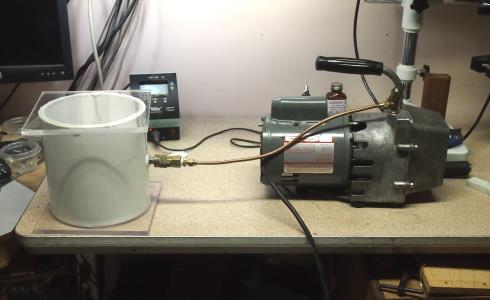

This is the setup I use to oil my spindle bearing sleeves:
On the right is a refrigeration vacuum pump. They are inexpensive compared to lab quality oil-free pumps, but obviously a little oil isn't going to compromise the process. The chamber is a 6" PVC pipe coupling. I've glued 3/8" acrylic sheet to the bottom and I seal the removable acrylic top with petroleum jelly. I submerge the sleeves in oil. I run the pump for about 10 minutes. After the air is pumped out oil fills the voids when the pump is turned off.

A lot more air than I expected.
And it lasts for a long time.
Yeah, even after 10 minutes there are still bubbles, but remember, those big bubbles would be microscopic at atmospheric pressure.
Indeed, I use the process to get deep penetration of shellac in small wood fittings.When impregnating wood, they use a Vac Vac process.
Have you tried that?
Doing it twice for better penetration of the oil?
That might be an interesting experiment. Logic would suggest that on the second stage the bubbling would commence at the rate it left off after the first. Next time I'll try it.
Have you tried to use the setup to remove old oil from spindle bearing sleeves, then used your process to infuse new oil?

Impregnating Oilite
Instead of going to the cost and trouble of using AC vacuum pumps, a Mightyvac at about 40 dollars from Harbor Freight is fine. It draws to 27 inches Hg and a small container is provided. Besides, it has plenty of other uses around the home and garage. Heating the oil also helps.

Indeed there are many inexpensive Chinese pumps on the market. I chose the Dayton pump because I'd experience with it and it's made in the USA. I bought it used on Ebay for a price similar to the Chinese pumps and it came with a set of refrigeration gauges, hoses and connectors.
I Don't think that would work. Since oil is not compressible I doubt that it is expandable the way air is so vacuum won't drive out the oil.
The bearings are probably sintered.
This is a very high pressure and high temperature process.
The sintered bearing will be resistant to heating, I suspect at least 200°C will do absolutely no harm.
Try cooking the sintered bearing in the oven set to 150°C, or even 175°C.
Some of the old oil will run out.
The sintered bearing may even tolerate 300°C, but I cannot give any warranty if you try going that high.
